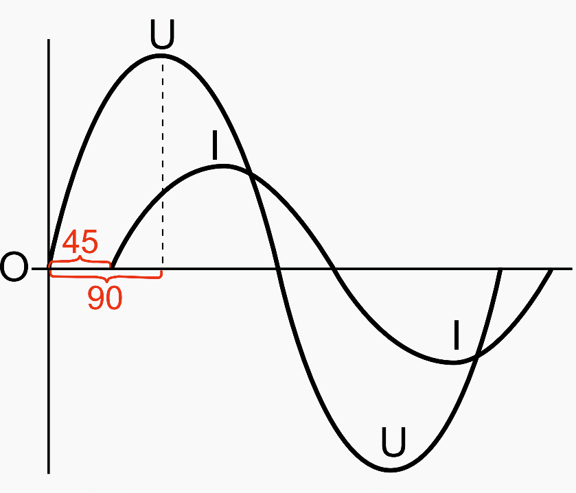

With alternating current, electrical conductors have an impedance (expressed in Ohms) which is the complex function of three factors:
  • Resistance R (also called ohmic resistance),
  • Reactance Lω due to the self-inductance of the conductor, and
  • Capacitance 1/cω (or capacitive reactance) due to running conductors together, which creates a capacitor.
It is considered that beyond 240 mm², the contribution made by reactance lω becomes the dominant factor in the impedance. The conductor therefore behaves like a receiver, shifting the current and the voltage.
The illustration opposite is given for a phase shift of 45° (cosϕ = 0.5). Resistance and reactance equal. It should be noted that, for these currents, the capacitance component can be ignored.

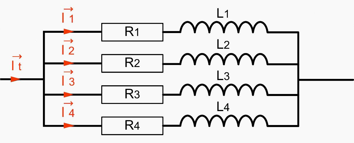

Application to conductors in parallel
The equal distribution of currents in several identical conductors in parallel is uniquely linked to the equality of the impedances in each of the conductors. With the inductance proportion becoming dominant with the increase in section, the geometrical layout of the conductors will dominate (identical distances for each of them).
Three-phase layout
In a cable or bundle of conductors in 3-phase (with or without neutral), the vectoral sum of the currents is nil and the resulting magnetic induction created by the conductors remains very low if they are grouped together and arranged in a regular pattern. If this is not the case, the self-induction coefficient of the conductors will be modified by the interaction of the magnetic field created.
Own and mutual inductances and the distribution of the currents will then be out of balance.

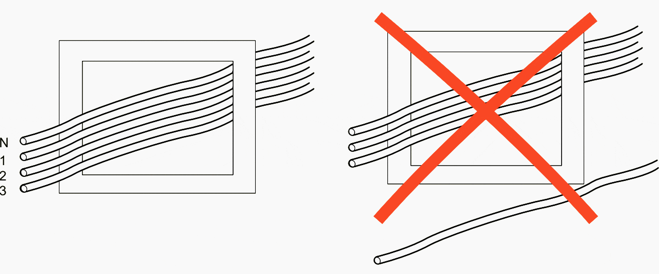

3.1 Magnetic loops
In order to minimise the induction created in magnetic loops, it is still recommended that all the life conductors in a circuit (phases and neutral) should be positioned within the same metal (steel) compartments.
Since the vectorial sum of the currents is nil, the one of the fields created is too.
All phases and neutral conductor must be positioned within the same metal compartments

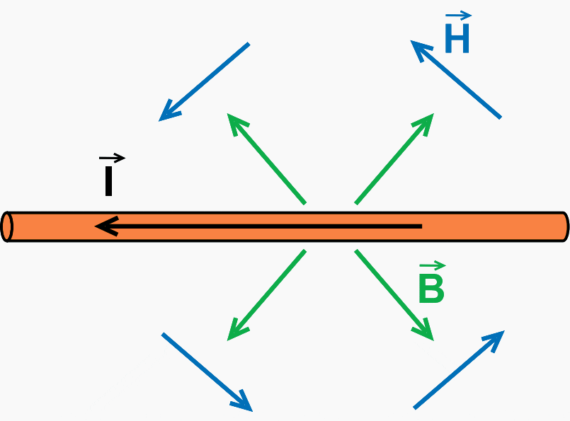

The circulation of a current I in a conductor creates a proportional field H , the effect of which is to create induction B in the surrounding medium. The value of B depends on the value of the field (therefore on the current) but also on the magnetic characteristics of the medium or the material. It is the magnetic permeability µ expressed in henries per metre (H/m).
The more the permeability of the material increases, the more the field lines are concentrated and the higher the induction. Above a certain value there is saturation and heating.
Ferrous materials (steel) being magnetic by nature, are particularly likely to conduct fields but also to become saturated if these fields are too high.
Circulation of a current in a conductor creates a proportional field and the effect of induction in the surrounding medium

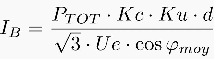

For a 3-phase supply, the actual operating current is determined by the formula:
Actual operating current for a 3-phase supply
where:
  • IB = operating current (in a)
  • PTOT = total active power installed (in W)
  • Kc = simultaneity factor
  • Ku = usage factor
  • d = supply factor, determined as follows :
    • 1 when the trunking is supplied from one end;
    • 0.5 if it is supplied from the middle or both ends
  • Ue = operating voltage (in V)
  • cos ϕ = average power factor.
