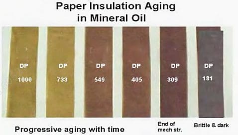

2.2. Degree of Polymerization (DP)
The DP is measured according to IEC 60450. Hence, not only cellulose but also hemicellulose and lignin are broken down. Therefore, DP is a sum total value. In the explanation of DP, it can be said that in the polymer or cellulose molecule, there are long chains that contain rings or glucose monomers and the number of rings in each string reaches 1000–1400.
The average number of glucose rings in a molecule or cellulose polymer is the DP.
The mechanical strength of cellulose depends on the strength between cellulose fibers and their length. If the force between the cellulose chains decreases, while reducing the mechanical strength of the paper, the DP of the paper will decrease. For a new transformer, the DP value is between 1000 and 1200 and when this number drops to 150–200, the cellulosic insulation quality is drastically reduced.
Cellulose is constantly affected by the heat generated by the active part of the transformer, the moisture content, the oxygen concentration in oil, acids produced in the oil, and other factors such as metal catalysts which generally cause cellulose decomposition, degradation, and deterioration. Insulation decomposition is a chemical phenomenon.
Figure 2 – Transformer paper insulating aging
Paper insulating aging
Figure 2 – Paper insulating aging
Three mechanisms of degradation hydrolysis, pyrolysis, and oxidation act simultaneously. Hydrolysis is the decomposition of a chemical compound by reaction with water. On the other hand, pyrolysis and oxidation are the decomposition processes resulting from heating and interacting with oxygen, respectively.
The cellulose paper degradation results in water, acid, furans, carbon oxides, and hydrocarbons. Many mechanisms have been proposed for the thermal degradation of cellulose based on which of the pyrolysis or hydrolysis processes are dominant. In the hydrolysis and pyrolysis processes, furans, especially 2-furfural will be produced.
Basically, water and carbon oxides are the main products of cellulose degradation and furans are the second products, and acids and other products are among other products.
The approach of identification of the paper status in accordance with paper colour. An inverse relationship exists between the paper colour and the DP number. Figure 2 illustrates this relationship in which dark-coloured paper has low DP number. The lower the DP number is, the more degraded the paper is.
As seen in Figure 3 paper deteriorates over time and weakens the insulation system against thermal, mechanical and electrical stresses.

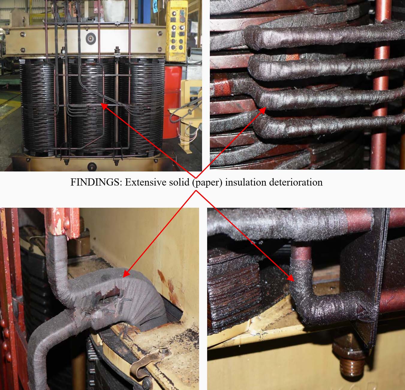

Cellulose is constantly affected by the heat generated by the active part of the transformer, the moisture content, the oxygen concentration in oil, acids produced in the oil and other factors such as metal catalysts which generally cause cellulose decomposition, degradation and deterioration.
Figure 3 – Cellulose ageing and destruction in an old transformer
Figure 3 – Cellulose ageing and destruction in an old transformer (photo credit: I.A.R. Gray; Transformer Chemistry Services)
