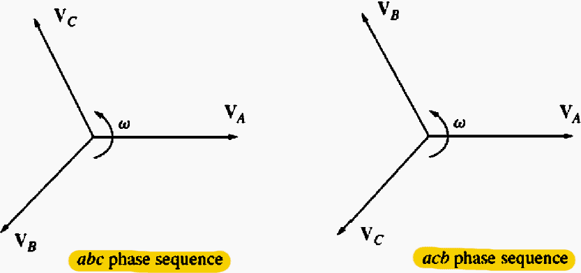

1. Phase Sequence
The phase sequence (or phase rotation) of the three phases of the generator must be the same as the phase sequence of the three phases of the electrical system (Grid). The only time that the phase sequence could be wrong is at initial installation or after maintenance. There are two possible problem sources.
The generator or transformer power leads could actually be interchanged during maintenance orthe potential transformer leads could be interchanged during maintenance.

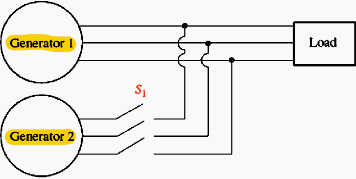

Before examining the behavior of synchronous generators running in parallel, let’s examine the prerequisites for paralleling AC generators.  Figure 5 depicts a synchronous generator G supplying electricity to a load, along with another generator G, which is about to be paralleled with G by shutting the switch S1.
Before the switch is closed and the two generators are connected, what requirements need to be fulfilled?
The load may lose power and the generators could sustain serious damage if the switch is abruptly closed. When the switch is closed, a very high current flow will occur if the voltages in each of the connected conductors are not precisely equal. Each of the three phases must have precisely the same voltage magnitude and phase angle as the conductor to which it is attached in order to prevent this issue. Stated otherwise, the voltage in phase a must be precisely equal to the voltage in phase a’, and the same is true for phases b-b’ and c-c’.
The following paralleling requirements must be fulfilled in order to accomplish this match:

  2. The phase sequence of the two generators must match.

Second Condition ensures that the two generators’ phase voltage peaks occur in the same order. Even though one pair of voltages (the a phases) is in phase, the other two pairs are 120° out of phase if the phase sequence is different, as seen in Figure 6. Phase a would not be an issue if the generators were connected in this way, but phases b and c would experience massive current flows that would harm both machines.
Just switching the connections on any two of the three phases on one of the machines fixes a phase sequence issue. There will be significant power transients until the generators stabilize at a common frequency if their frequencies are not nearly identical when coupled. Although they cannot be precisely equal, the frequencies of the two devices must be quite close to one another.

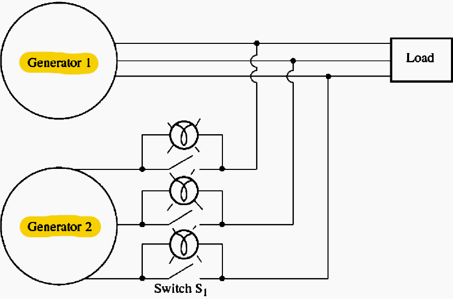

Assume that the operating system depicted in Figures 6 and 7 is to be connected to generator G. To complete the paralleling, the actions that follow need to be performed. The field current of the oncoming generator should first be regulated with voltmeters until its terminal voltage matches the line voltage of the operational system.
The second step is to compare the phase sequence of the running system with that of the oncoming generator.
There are several methods for verifying the phase sequence. One method is to connect a little induction motor to each of the two generators’ terminals in turn. The phase sequence is the same for both generators if the motor always rotates in the same direction. Phase sequences will differ and two conductors on the oncoming generator will need to be reversed if the motor rotates in opposing directions. The three-light-bulb approach is an old-school technique to verify the phase sequence.
As illustrated in Figure 7, this method involves stretched three light bulbs across the open terminals of the switch that connects the generator to the system. The light bulbs first become bright (big phase difference) and subsequently dim (small phase difference) as the two systems’ phases shift.
The systems have the same phase sequence when all three bulbs turn on and off simultaneously.
Figure 6 – Two possible phase sequences of a three-phase system
The systems have the opposite phase sequence if the bulbs light up one after the other, thus one of the sequences needs to be switched.

Observing the three light bulbs mentioned above in relation to the phase sequence discussion is an easy old-school method. The systems are in phase when all three light bulbs are out and there is no voltage differential across them.
However, although this straightforward plan is effective, it is not very precise.
Figure 7 – The three-light-bulb method for checking phase sequence

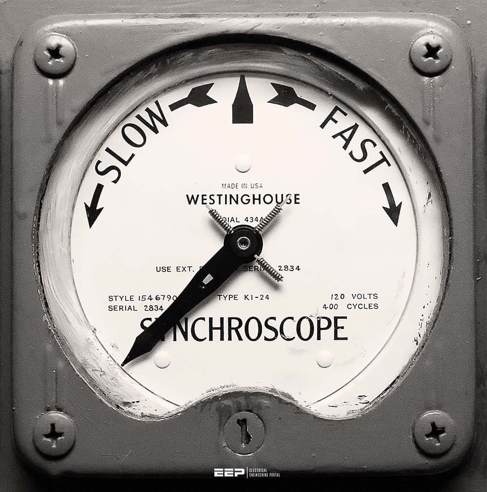

Using a synchroscope is a superior method. A meter that gauges the phase angle difference between the two systems’ phases is called a synchro-scope. Figure 8 shows the face of a synchroscope. With 0 (indicating in phase) at the top and 180° at the bottom, the dial displays the phase difference between the two a phases.
The phase angle on the meter varies gradually because the frequencies of the two systems differ slightly. The phase angle advances and the synchroscope needle revolves clockwise if the oncoming generator or system is faster than the operating system (the ideal scenario).
The needle turns counterclockwise when the approaching machine is slower. The voltages are in phase when the synchroscope needle is vertical, allowing the switch to be closed and the systems to be connected. However, take note that a synchroscope only examines one phase to verify the links. It provides no details regarding the phase sequence. A computer handles the entire process of paralleling a new generator to the line in huge generators that are part of power systems.
However, for smaller generators, the operator performs the previously mentioned paralleling stages by hand.
Figure 8 – Synchroscope is used to connect two different sources

  38. A. Murshed
    Jul 07, 2014
    Phase angel is the angel difference between the generator voltage and the grid voltage. While phase sequence means that the three phases of the generator must match with the same phases on the grid.
    For example: A, B, and C are the three phases of the generator. Then to have the same phase sequence with the grid connect them to their match on the grid A to A etc…
    Note down that u dont need to confirm this condition everytime u synchronyze the gen. with the grid. Because the gen. Is connected permenantly.
