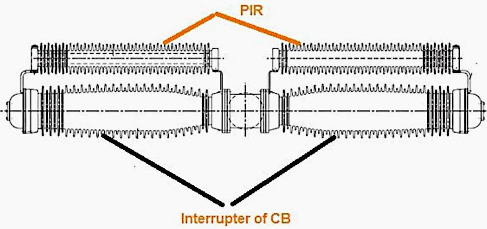

3.3 Pre-Insertion Resistors
Principle:
Temporary resistors are inserted into the circuit during transformer or reactor energization to limit the inrush current. The resistors are bypassed once steady-state conditions are achieved.
Application:
Suitable for EHV/HV transformer energization in substations where inrush can cause significant disturbance.
Benefits:
  • Reduces voltage step change magnitude.
  • Particularly useful for very infrequent events where controlled switching is not installed.
Figure 3 – Model of a circuit breaker with a Pre-Insertion Resistor
Figure 4 – Pre-Insertion Resistor attached to CB interruptor
