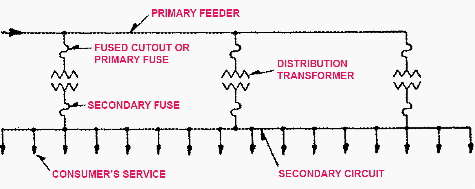

Typical method of connecting distribution transformers between primary feeders and radial secondary circuits
Figure 1 – Typical method of connecting distribution transformers between primary feeders and radial secondary circuits
The secondary leads of a distribution transformer are usually solidly connected to radial secondary circuits from which the consumers services are tapped as shown in Figure 1. This means that no protection is provided the transformer against overloads and high-impedance faults on its secondary circuits. Relatively few distribution transformers are burned out by overloads.
This is largely because distribution transformers are applied so that full advantage is rarely taken of their overload capacity.
Another factor contributing to the small number of distribution transformer failures by overloads is the frequent load checks often made and the corrective measures taken before dangerous overloads occur. Probably high impedance faults on their secondary circuits cause more distribution transformer failures than do overloads. This is certainly true in localities where bad tree conditions exist.
Fuses in the secondary leads of distribution transformers are little if any more effective in preventing transformer burnouts than are primary fuses and for the same reasons. The proper way to obtain satisfactory protection for a distribution transformer against overloads and high-impedance faults is by means of a circuit breaker in the secondary leads of the transformer. The tripping curve of this circuit breaker must be properly coordinated with safe current-time curve of the transformer.
The primary fuse must be coordinated with the secondary breaker so that the breaker tripe on any current that can pass through it before the fuse is damaged.

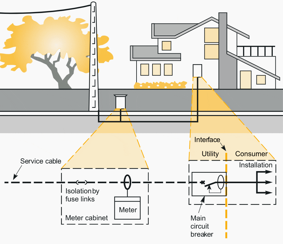

The consumer-service connection
Figure 2 – The consumer-service connection (photo credit: electrical-installation.org)
Faults on a consumer’s service connection from the secondary circuit to the service switch are so rare that the use of a secondary fuse, where the service connection taps onto the secondary circuit, cannot be economically justified except in unusual cases such as large services from underground secondaries.

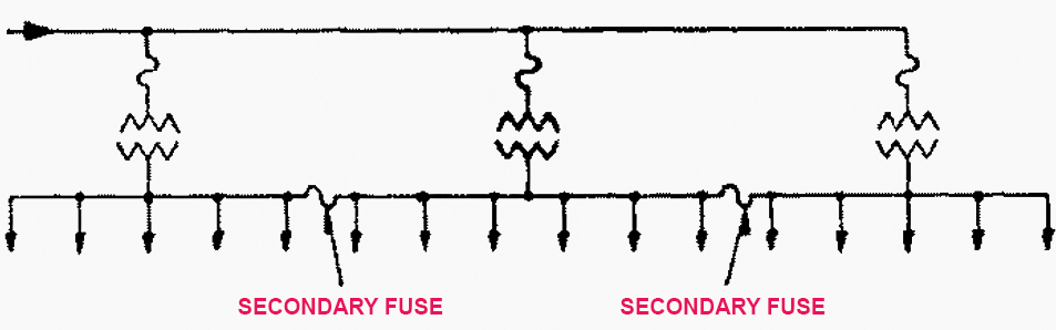

The term banking transformers means paralleling on the secondary side a number of transformers all of which are connected to the same primary circuit as shown in Figures 5 and 6. The secondary circuit, arrangement in a banked transformer layout can take the form shown in Figures 5 and 6, or it may be a loop or grid similar to that used in a secondary network system.
Because of this similarity in secondary-circuit arrangements a banked-transformer layout is sometimes incorrectly referred to as a secondary network system. Banked transformers, because they are connected to and supplied over a single radial-primary feeder, are a form of radial distribution system; whereas a secondary network loop or grid is supplied over two or more primary feeders which results in much greater service reliability.
Banking of distribution transformers is not new and has been used on a number of systems for many years.
The distribution transformers are connected to their primary feeder through primary fuses or fused cut-outs
Figure 5 – Typical method of banking transformers supplied by the same radial primary feeder: The distribution transformers are connected to their primary feeder through primary fuses or fused cutouts
The conversion from the usual radial secondary circuit arrangement of Figure 1 to the banked-transformer arrangement of Figures 5 and 6 can usually be made simply and cheaply by closing the gaps between the radial secondaries of a number of the transformers associated with the same primary feeder and installing the proper primary and secondary fuses.
Two major forms of protection have been used when banking distribution transformers. The arrangement shown in Figure 5 is probably the oldest and most common. The distribution transformers are connected to their primary feeder through primary fuses or fused cutouts. These fuses should blow only on a fault in their associated transformer.
All transformers are connected to the common secondary circuit through secondary fuses.
The purpose of these fuses is to disconnect a faulty transformer from the secondary circuit. The size of the secondary fuse must be such that it will blow on a primary fault between its transformer and the associated primary fuse. Faults on the secondary circuit arc normally expected to burn themselves clear.
To prevent frequent blowing of secondary fuses on secondary-circuit faults these fuses should have relatively long blowing times on all fault currents. Their blowing times should not be so long, however, as not to provide some degree of protection to their transformers against secondary faults that do not burn clear or require an unusually long time to do so.
As previously stated secondary fuses cannot be expected to protect transformers satisfactorily against overloads and high-impedance secondary faults. The use of a secondary breaker having the proper current-time characteristics is preferable to secondary fuses when banking transformers as shown in Figure 5 because greater protection is afforded the transformer against overloads and high-impedance faults.
The secondary fuses or breakers should open in less time than the primary fuses on any possible current so as to prevent the blowing of primary fuses on a secondary fault.
A transformer fault is cleared by the transformer’s primary and secondary fuses without any interruption to service. Most secondary faults will clear themselves quickly. However, when a secondary fault hangs on for a long time or fails to clear altogether several or all of the secondary fuses blow and some of the transformers may be burned out.
Experience indicates that, where a careful study of the fault currents to be expected is made and the primary and secondary fuses are properly selected, this method of banking operates with very little trouble. Occasionally a secondary-circuit fault causes the blowing of all secondary fuses or the blowing of some secondary fuses and the burning out of a few transformers. When this happens the extent of the service interruption is much greater than when radial secondary circuits are used.

The transformers are connected solidly to the secondary circuit and the secondary circuit is sectionalized between transformers by secondary fuses. These fuses are selected so that for any secondary-circuit fault they will blow quicker than any primary fuse.
When a transformer fails it is cleared from the system by its primary fuse and the adjacent secondary fuses on each side of it. Thus, unlike the previous arrangement, a transformer fault results in a service interruption to those consumers associated with the faulted transformer.
A secondary-circuit fault is usually burned clear; however, if the fault persists for an unusually long time it is cleared by the secondary fuses next to the faulty section and the primary fuse associated with the transformer connected to the faulty section. The secondary fuses are usually selected so that they operate even on a high-impedance fault, but the primary fuses are not for the reason previously discussed in connection with the radial-secondary circuits.
Thus even when a high-impedance fault occurs and hangs on, the secondary fuses adjacent to the faulty section blow and prevent interrupting service on the good secondary sections. The transformer associated with the faulty section in this case, however, will be burned out. In order to prevent this a secondary breaker whose current-time curve is coordinated with the safe current-time curve of the transformer can be used in the secondary leads of the transformer.
When such a breaker is used the secondary fuses must be selected so that their blowing times for all fault currents are less than the tripping times of the breakers.
