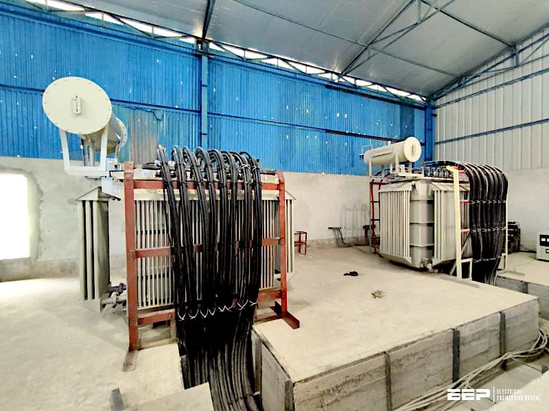

In ideal parallel operating of power transformers, the current in each transformer is directly proportional to its capacity, and the arithmetic sum equals one-half of the total current. This is rarely accomplished because to minor discrepancies in transformers. Nonetheless, some requirements must be met for the parallel operation of transformers.
Principles of Transformers in Parallel Connection - Part 2
Principles of Transformers in Parallel Connection – Part 2 (photo credit: Samrat Rahman via Linkedin)
