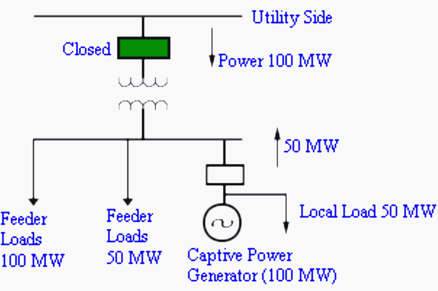

Consider a medium voltage distribution system having local generation (e.g., captive power generation) as shown in figure 1 which is also synchronized with the grid. During grid disturbance, if plant generators are not successfully isolated from the grid, they also sink with the grid.

Captive generator that exports power and meets local demand
Figure 1 – Captive generator that exports power and meets local demand

Underfrequency relay and Rate of change of frequency relay

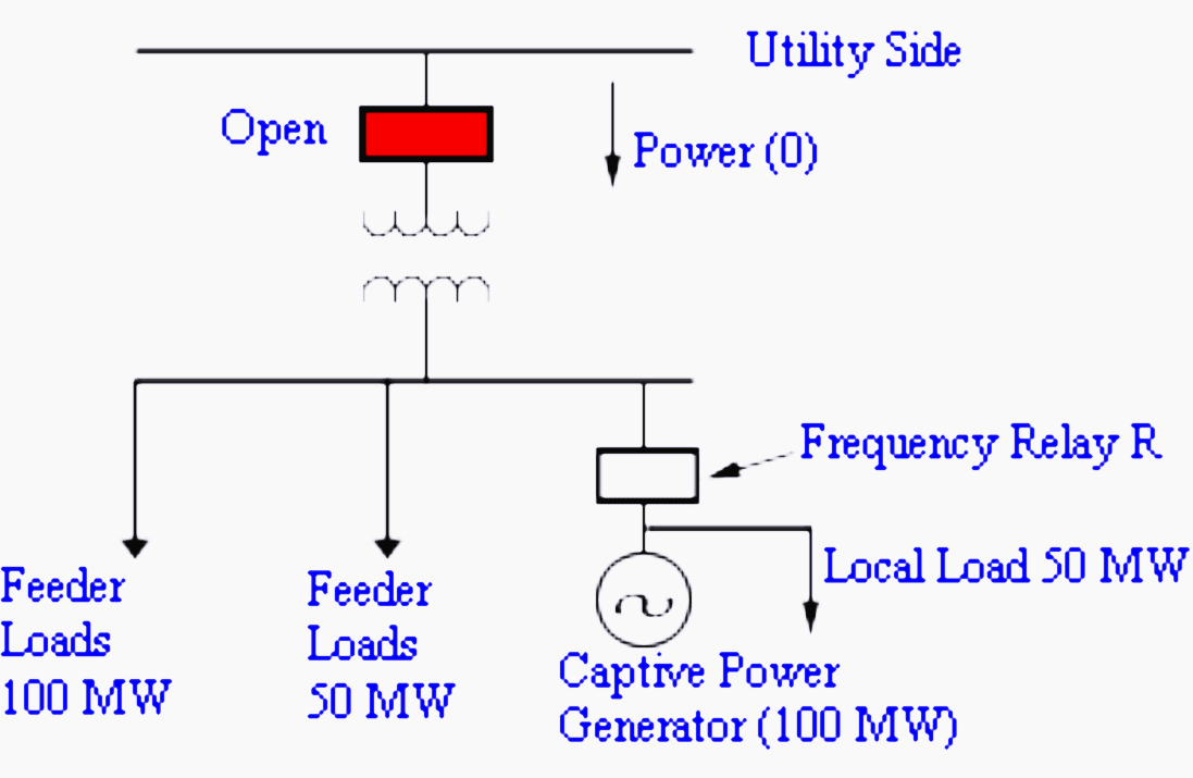

In case of a grid failure (figure 2), captive generators tend to supply power to other consumers connected to the substation. The load-generation imbalance leads to fall in frequency.
The underfrequency relay R detects this drop and isolates local generation from the grid by tripping breaker at the point of common coupling. After disconnection from the grid, it has to be ascertained that there is load-generation balance in the islanded system.
Because of the inertia of the machines, frequency drops gradually. To speed up the islanding decision, rate of change of frequency relays are used.

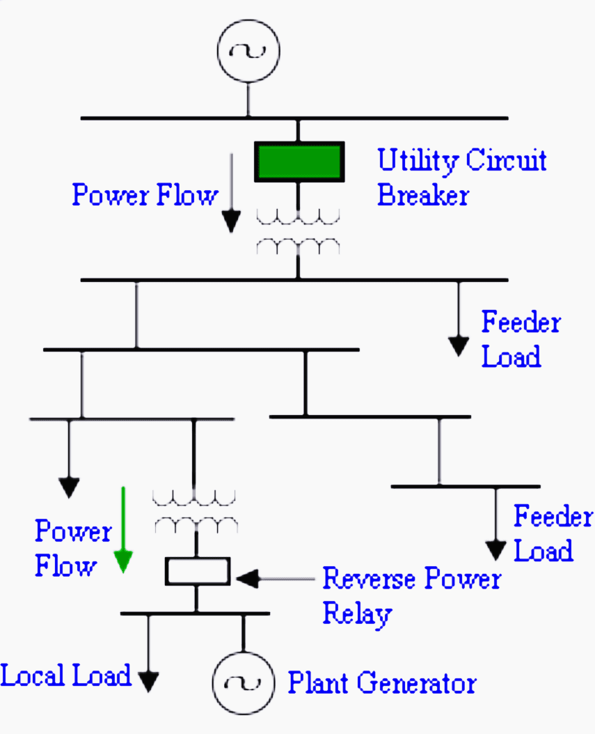

Reverse power relay
Distribution systems are radial in nature. This holds true for both utility and plant distribution systems. If there is a fault on the utility’s distribution system, it may trip a breaker thereby isolating plant from the grid.
This plant may still remain connected with downstream loads as shown in figures 3 and 4. Consequently, power will flow from the plant generator to these loads.
If in the prefault state, power was being fed to the plant, then this reversal of power flow can be used to island the plant generation and load from the remaining system.
This approach is useful to detect loss of grid supply whenever the difference between load and available generation is not sufficient to obtain an appreciable rate of change of frequency but the active power continues to flow into the grid to feed the external loads.

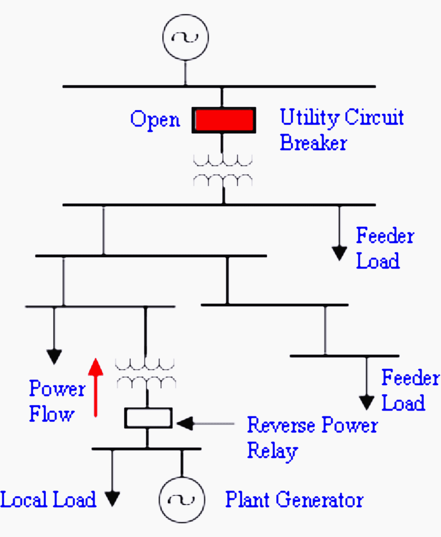

Isolation of grid reversal of power flow
Figure 4 – Isolation of grid reversal of power flow
Example
In figure 4, consider that the plant imports at all times a minimum power of 5 MW. Studies indicate that for various faults in utility side, minimum power export from the plant generator is 0.5 MW. Deduce the setting of reverse power relay.
If the plant generator is of 50 MW capacity, what is likelihood of underfrequency or rate of change of frequency relay picking up on such faults?
ANSWER: Reverse power flow relay can be set to 0.4 MW. Since minimum reverse power flow is 1% of plant capacity, it is quite likely, that utility disconnection may not be noticed by underfrequency or the rate of change of frequency relays.

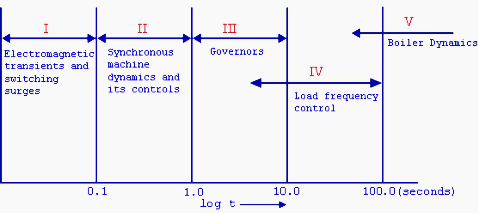

Dynamical nature of the power system
Usually, system protection requires study of the system dynamics and control. To understand issues in system protection, we overview dynamical nature of the power system. Power system behaviour can be described in terms of differential and algebraic system of equations.
Differential equations can be written to describe behaviour of generators, transmission lines, motors, transformers etc. The detailing depends upon the time scale of investigation.
Figure 5 shows the various time scales involved in modelling system dynamics. The dynamics involved in switching, lightning, load rejection, etc. have a high frequency component which die down quickly. In analysis of such dynamics, differential equations associated with inductances and capacitances of transmission lines have to be modelled. Such analysis is restricted to a few cycles.
It is done by Electromagnetic Transient Program (EMTP).

At a larger time scale (order of seconds), response of the electromechanical elements is perceived. These transients are typically excited by faults which disturb the system equilibrium by upsetting the generator-load balance in the system. As a consequence of fault, electrical power output reduces instantaneously while the mechanical input does not change instantaneously.
The resulting imbalance in power (and torque) excites the electromechanical transients which are essentially slow because of the inertia of the mechanical elements (rotor etc).
Detection and removal of fault is the task of the protection system (apparatus protection). Post-fault, the system may or may not return to an equilibrium position.
Transient stability studies are required to determine the post fault system stability. In practice, out-of-step relaying, underfrequency load shedding, islanding etc are the measures used to enhance system stability and prevent blackouts.
