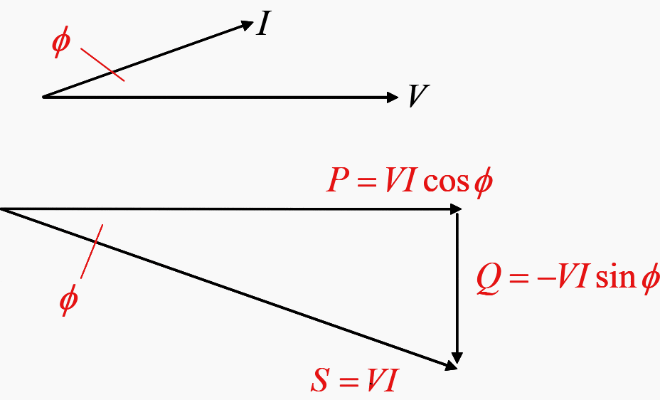

Leading circuit:
Leading circuit
Leading circuit – phasor diagram
Note that (the convention says) reactive power is positive (absorbed) in lagging power factor circuits and is negative (generated) in leading power factor circuits.
Note also that:
Total Current |I| = √((I cosφ)2 + (I sinφ)2)
Apparent power |S| = √(P2 + Q2) = √((VI cosφ)2 + (VI sinφ)2)

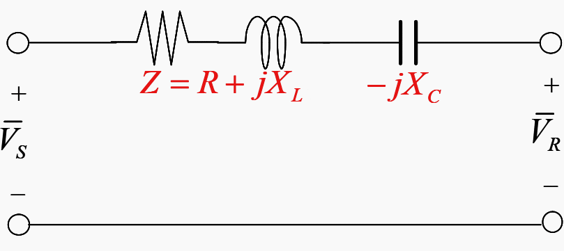

3.1 Series Connection
Series connection of capacitance

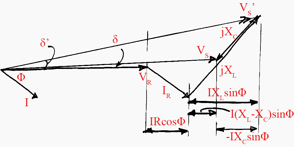

In the diagram below, Vs is the source voltage without capacitance and Vs is the source voltage with capacitance correction.
Series connection diagram
The voltage regulation is:
ΔV = |VS| − |VR|
Thus the added VAR generation is QC = I2 XC and the resulting improvement (decrease) in the voltage regulation is: QC sinΦ / I volts
Series connection has some advantages and disadvantages:
  1. The reduction in total I is small so that the improvement in loss in the line is very small.
  2. Series capacitance is very good for voltage regulation and for improving (smoothing) voltage fluctuations.
  3. The series capacitance helps to improve stability if the line reactance is high.
  4. Series connection is much less flexible than shunt connection in that the capacitance value is not easily able to be changed.

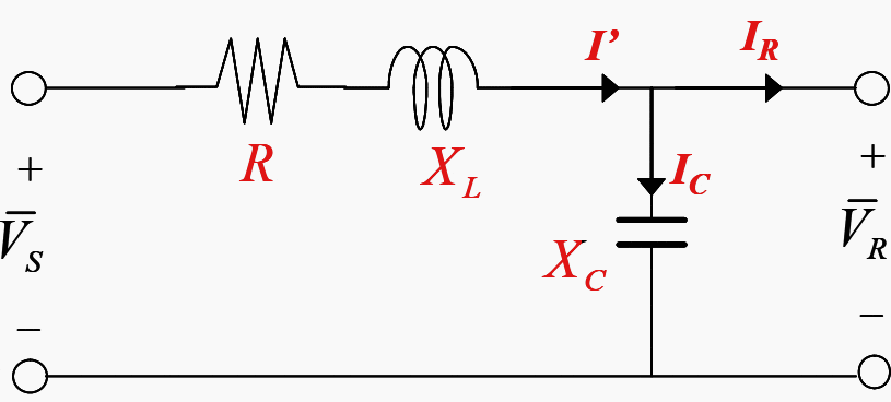

3.2 Shunt Connection of Capacitance
Shunt connection of capacitance
Note that:
I’ = IR + IC
QC = VR IC

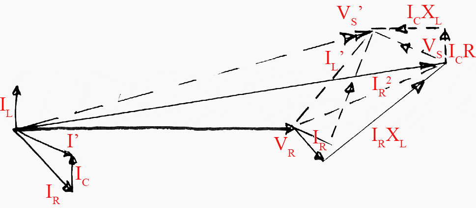

Shunt capacitance connection diagram
Regulation in this case is:
ΔV = IRRcosΦ + IRXLsinΦ − ICXL
And the voltage boost is:
ICXL = QCXL / VR
The advantages and disadvantages of shunt connection are:
  1. Improves power factor and reduces line current significantly and thus reduces line losses significantly.
  2. Not as good as series connection for voltage smoothing.
  3. Has much greater flexibility of use than series as change of the value has no effect on load current.
In general, series connection is rarely used, except in some very high voltage long transmission lines where better voltage regulation is needed.

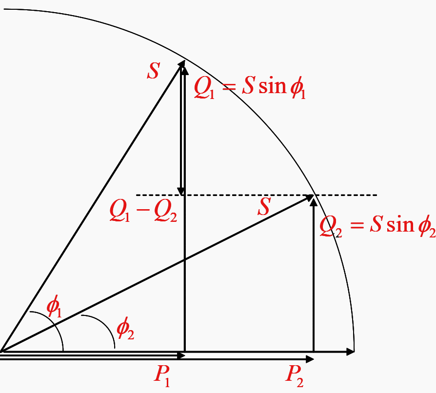

4.2 Correction at constant S
This method increases availability of real power for possible increase of load capacity for a fixed source current.
Correction diagram at constant S
Initially, at cosΦ1, power P1 is available:
P1 = S cosΦ1
Q1 =S sinΦ1
After correction, at cosΦ2, P2 is available:
P2 =  S cosΦ2
Q2 = S sinΦ2
To achieve this we require reactive power generation: ΔQ = S(sinΦ1 − sinΦ2)
In this case there is of course no reduction of loss in the line. However the regulation is improved.

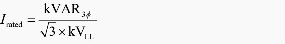

Shunt capacitors are protected by fuses. Fuse links are usually sized at 125% to 135% of the rated capacitor current. This is to allow for overvoltage conditions, transient currents, harmonic. The rated current for a 3-phase capacitor bank is:
Rated current for a 3-phase capacitor bank
