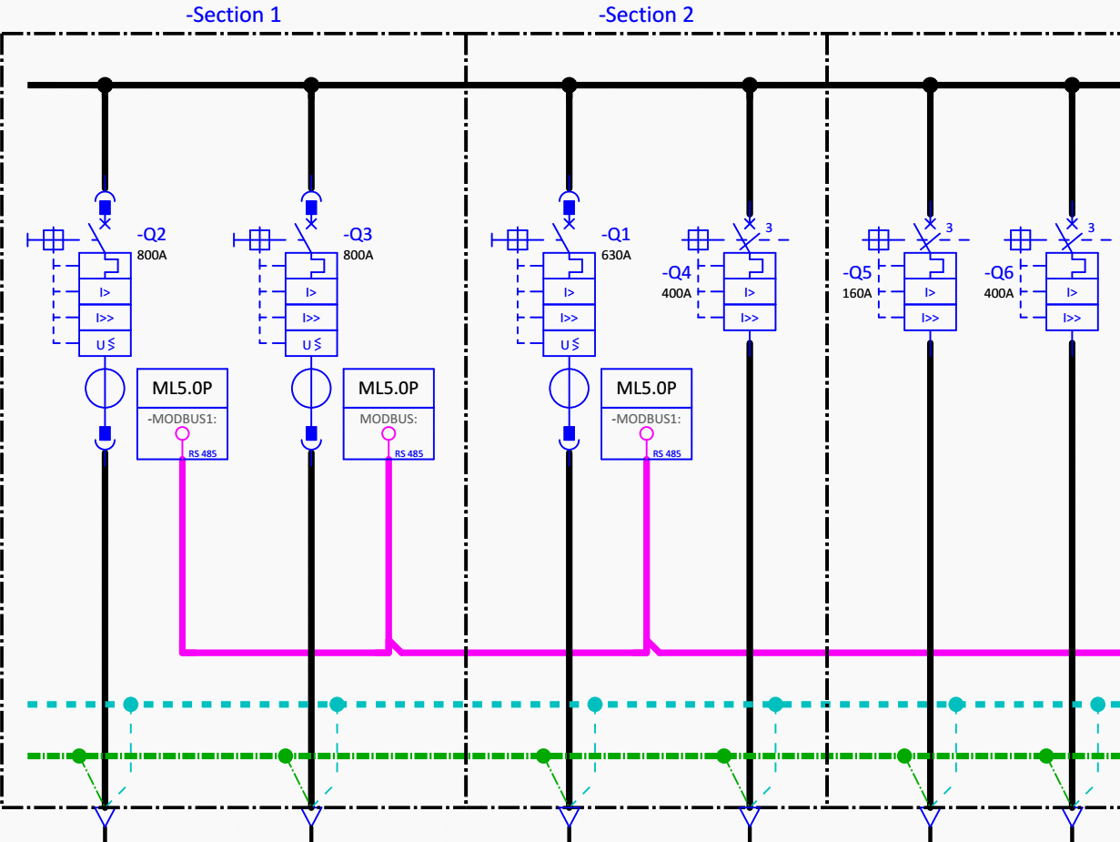

In Figure 1 main low voltage distribution board consisted of five sections, i.e. cubicles, is shown in the form of single line diagram (SLD).
Nowadays, usually =FUNCTION +LOCATION -PRODUCT principle for creation of project tag for equipment is used, according to IEC 81346. Dashed rectangles are most often designation for so called location box, which may be a switchboard, control panel, substation or similar in example.
Example of single line diagram
Figure 1 – Example of single line diagram (click to expand)
There are three incomings: transformer 1 (-T1), transformer 2 (-T2) and generator (-G1) and twelve outgoings, so fifteen circuit breakers in total are shown. “Standby” generator means that it will be started and used for supply only in case when grid supply isn’t available, i.e. in case when neither of two transformers is capable to provide power supply.
Note that standby rating of generator (in this case 320kW/400kVA) differs from some other, e.g. prime rating of same generator.
Black continuous line represents three live conductors or busbars (L1, L2, L3), blue dashed line stands for neutral (N), while green dash-dot line is protective earth (PE). This can be easily concluded, but it is better to be clearly marked in drawing.

Following main electrical characteristics of the switchboard are usually shown above main busbars:
  • Rated supply voltage (e.g. 3×400/230V, 50Hz)
  • Rated current (e.g. 1000A)
  • Short duration withstand current (e.g. 16kA/1s)
This example doesn’t contain those data, which may be considered as a drawback.
