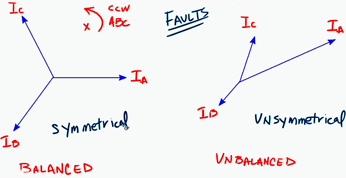

To understand harmonics, we can use an analogy from fault analysis:
5.1 Analogy: Symmetrical Components
When analyzing unbalanced three-phase systems, we break an unbalanced set of phase voltages into:
This mathematical decomposition converts a complex, unbalanced problem into three simple, balanced systems that are easier to study.
Figure 4 – Balanced Vs Unbalanced system
