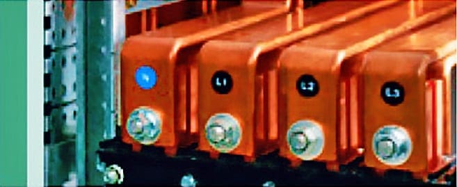

  12. Layout of the busbars (mechanical hold, distances between supports, bolted connectors).

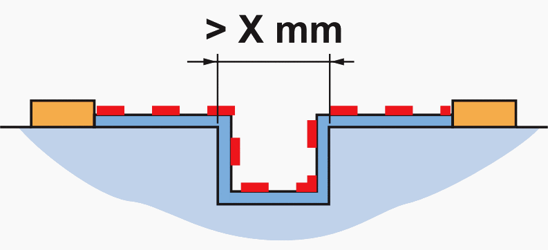

3.4 Checking the clearances
The following items must be checked:
  1. Distances from the device connections (lugs, terminals for cable lugs, etc.) to the nearby exposed conductive parts (chassis, plate).
  2. Bolted connection and connection on the bars: distance between bars and with the exposed conductive part.
Distances in the air
Figure 7 – Distances in the air
Regarding distances from the device connections in the air, these represent the shortest distance between two conductive parts. If there is a breakdown that disrupts the air, the electric arc will follow this path. ribs or partitions can increase the distances in the air.
The distances in the air are sized according the Uimp voltage given for the assembly.

Regarding creepage distances, they represent the shortest distance along the surface of the insulating materials between two conductive parts. They depend on the properties of the insulating materials themselves and the degree of pollution.
Creepage distances
Figure 8 – Creepage distances
Degree of pollutionX mm
(standard value)
21
31.5
Grooves and ribs can increase the creepage distance as long as they are large enough not to retain water.

The phases must at least be marked N, L1, L2, L 3, at the ends and at the connection points
Figure 10 – The phases must at least be marked N, L1, L2, L 3, at the ends and at the connection points
