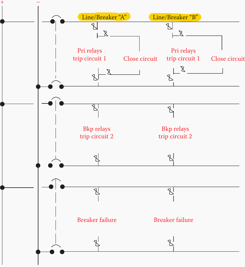

The design arrangement of the DC circuits varies depending on the preference of the utility. In one design, a dedicated DC feeder is provided for each breaker and its associated relaying.
A more economical design that is commonly used is a tapped-feeder arrangement. In such a design, a DC feeder is tapped for supply to a circuit breaker trip coil. The individual tapped circuits are usually fused. When a breaker is equipped with dual trip coils, each coil is supplied from a different tapped circuit.
Tapped circuits that supply a breaker trip coil may also be used to supply relaying associated with the breaker.
It is common practice, however, to use separate circuits to supply primary, backup, and breaker failure relaying.

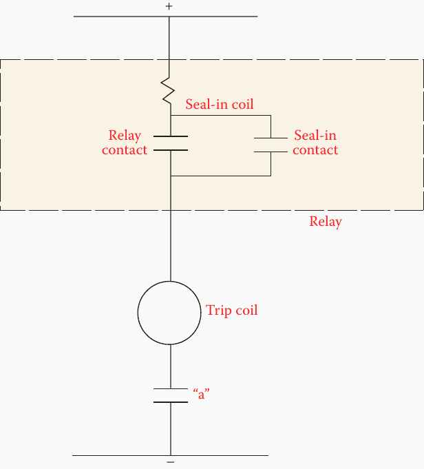

A seal-in device is a contact that bypasses the output contact of a protective relay. Action to close the seal-in contact is usually initiated by trip current flow.
Sometimes the same coil that allows a target to indicate also closes the seal-in contact. The seal-in contact is not allowed to drop out until the associated breaker(s) that has been tripped is open and trip current has been interrupted by breaker auxiliary contacts.
A typical seal-in coil connection is shown in Figure 4.
Figure 4 – Trip circuit illustration showing connection of seal-in coil and associated contacts
The purpose of the seal-in contact is to protect the relay contact from damage if it should attempt to interrupt the DC trip currents. The relay contacts are delicate and are not designed to interrupt the DC trip current. The seal-in contact also keeps closure of the trip circuit intact in the event of the relay contacts chattering.
Target and seal-in coils are rated to match the characteristics of the DC system into which they are connected. On electromechanical relays, the target/seal-in coil pickup current can be set to match the expected current drawn by the circuit.

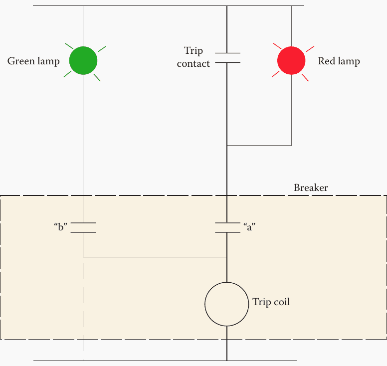

A common means for monitoring availability of DC tripping voltage is by connecting lamps in the DC tripping circuit. A simple arrangement for connecting such lamps in a trip circuit is illustrated in Figure 6.
When the breaker is closed, the red lamp provides indication of the availability of DC voltage to the trip coil. When the breaker is open, the green lamp provides similar indication. The red and green lamps also provide indication for the breaker position—the red lamp will be lit when the breaker is closed and the green lamp will be lit when the breaker is open. The lamps are usually mounted on the control panel within the substation at a location where the associated breaker is clearly identified.
The lamps that are used must meet requirements of the DC circuit into which they are installed and should provide a feature to easily check for burnt-out lamps. Alarm relays may be used in addition or in place of the lamps. Such application allows for sending alarms to remote locations, which is highly recommended for unattended substations.

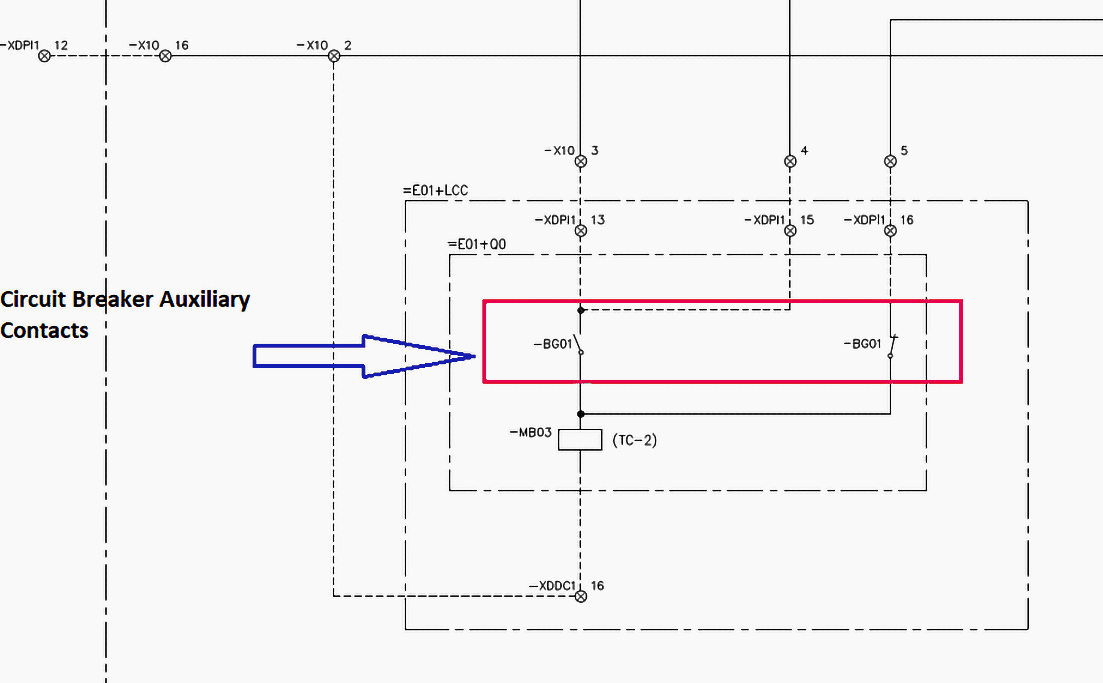

Modern substations with digital control systems employ various electronic methods for providing monitoring and alarming for various functions. Modern microprocessor-based relays contain self-checking ability, which provides local indication, remote alarming, and the blocking of relay operation for certain failures.
The common design for modern numerical protection relays involves the incorporation of a variety of protective and control functions within a rack-mountable case with specific connections for inputs and outputs. The number of protection and control functions available in numerical relays can vary from a few to meet simple or specialized needs to a number suitable for providing complete protection for a line terminal or a generator.
A simple design may include several overcurrent elements. A design that is little more complex may add automatic reclosing functions along with the overcurrent elements. As noted earlier, a more complex relay may include all functions required for protecting a specific power system facility along with logic to provide control for the facility.
Figure 7 – BG01 are the Circuit breaker auxiliary contacts used for the trip circuit supervision
