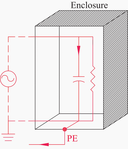

1. High Protective Conductor Currents
Medical electronics equipment may be sensitive to electromagnetic interferences irradiated by “disturbing” loads. For this reason, radio frequency input filters constituted by capacitors connected between supply conductors and enclosures of equipment are employed to enhance the electronic systems’ immunity.
Such filters may cause continuous leakage currents through the protective conductors in excess of 3.5 A. See Figure 1.
Figure 1 – Earth leakage currents due to radio frequency filters
IEC 60950-13 limits the maximum value of leakage currents of Class I, stationary, or pluggable, equipment to 5% of the input current. The presence of high currents on protective conductors might cause nuisance trippings of RCDs, when their residual settings are exceeded even in the absence of ground faults.

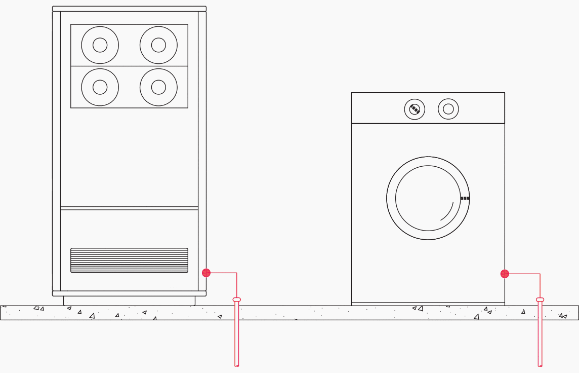

To prevent electrical noise from interfering with sensitive electronic equipment, manufacturers may require a dedicated grounding system. An erroneous interpretation of this condition may lead the designer to install in the same building one separate ground for the high-frequency electronic apparatus and one for the 50/60-Hz equipment.
See Figure 3.
Figure 3 – Grounding electrodes for sensitive 50/60-Hz electronic equipment
Distinct grounding electrodes for sensitive electronic equipment and for 50/60-Hz equipment
Figure 3 – Distinct grounding electrodes for sensitive electronic equipment and for 50/60-Hz equipment
The above arrangement is extremely unsafe and must be avoided, because it does not assure equal potential between equipment under fault conditions. In the case of ground faults on either exposed conductive part, persons in simultaneous contact with both pieces of equipment are subject to the whole earth potential.
Each exposed conductive part becomes, in fact, an extraneous conductive part to the other one. In addition, separate earthing points, possibly energized at different potentials under fault conditions, can cause circulation of ground currents, and be the source of the electrical noise one wants to eliminate.

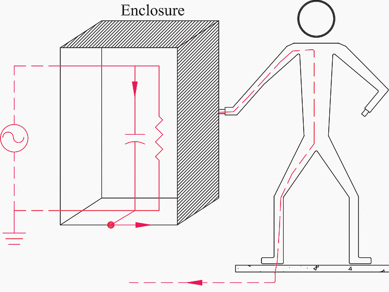

Ordinary Class I equipment, medical or not, during its use may leak current through the insulation, and into the protective conductor. As discussed in previous Section 1, in the case of interruption of the protective conductor, the leakage current may circulate through the persons in contact with the enclosure.
For ordinary equipment (i.e., equipment having low protective conductor currents), the magnitude of such current is so low that it does not constitute a hazard for persons.
In medical locations, though, the interruption of the PE, defined as single fault condition, is very dangerous because the same low amount of  leakage current flowing through the catatherized patient, defined as patient leakage current IP, can cause the microshock.
In Figure 4, it is shown how in a single fault condition, the patient leakage current IP can directly circulate through his/her heart due to contacts with any Class I equipment (Ien) and/or due to applied parts to the body (Iap).
In the above situation, the person is at great risk of microshock, as the patient current may exceed the fibrillation threshold.

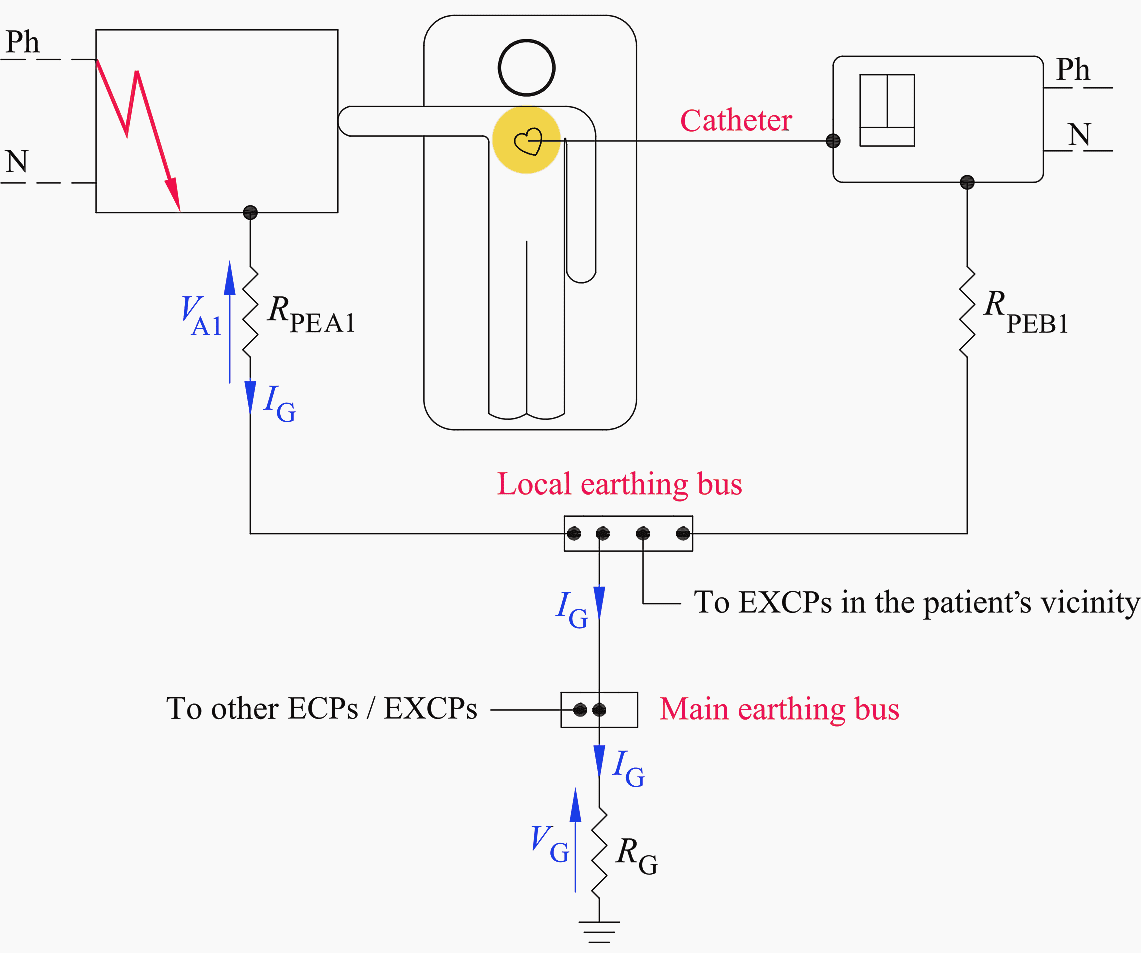

3. Local Equipotential Earthing Connection

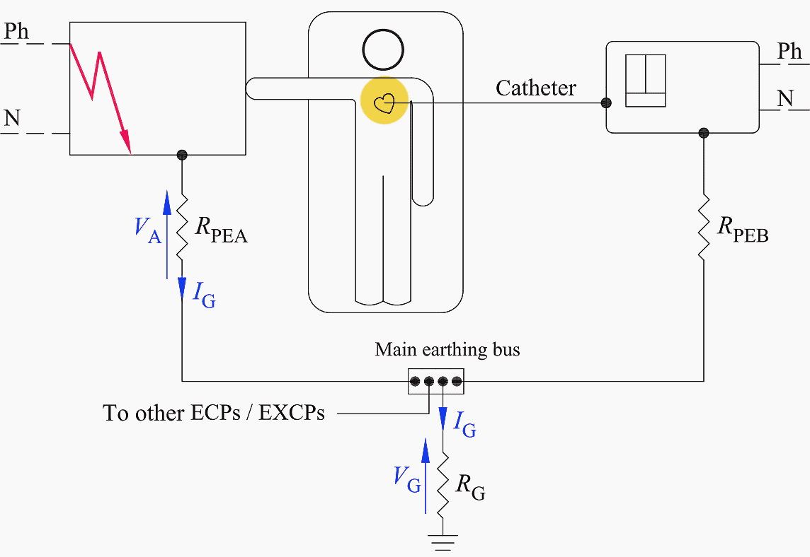

In addition to the “chronic” problem of leakage currents from regularly operating Class I equipment emphasized by the interruption of their protective conductors, the safety of the patient can also be endangered by actual ground faults.
Figure 5 exemplifies a ground fault in TT systems because of the failure of an electrical component in the patient vicinity. The patient vicinity is defined as the space with enclosures likely to be touched by the patient, which extends 1.83 m beyond the perimeter of the bed and 2.29 m above the floor.
In the above situation, a potential difference VA, caused by the voltage drop on the protective conductor of resistance RPEA, appears between the two pieces of equipment the patient may be in simultaneous contact with by touch and via catheters.
Figure 5 – Hazardous condition in the presence of a sound PE
The reduction of such voltage drop can be obtained by connecting together all the exposed conductive parts (ECPs) and the extraneous conductive parts (EXCPs) to a local equipotential earthing bus located within the patient vicinity (see Figure 6).
This supplementary equipotential bonding connection lowers the resistance of the protective conductor serving the faulty exposed conductive part, ECP (i.e., RPEA1 < RPEA), thereby decreasing the touch voltage (i.e., VA1 < VA).
It is important to note that due to the patient’s enhanced sensitivity to electric currents, extraneous conductive parts (EXCPs) in medical locations need to be redefined, with respect to the standard definition that we gave in ordinary locations. In medical locations, in fact, IEC standards assume the threshold of 25 V as the maximum permissible touch voltage, and a lethal current for catheterized patients of 50 A.
In these assumptions, the resulting resistance-to-ground of any metal part in the patient vicinity must exceed 500 kΩ in order not to be an extraneous conductive parts (EXCPs), and therefore, not bonded to the local earthing bus.
Figure 6 – A local equipotential earthing bus reduces the voltage drop on the PE

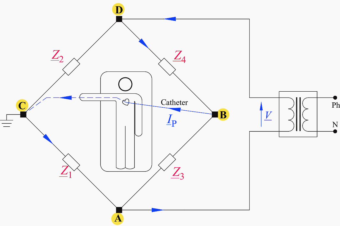

Let Z1, Z2, Z3, and Z4 be the capacitive impedances-to-ground of supply and equipment, as indicated in Figure 8. Upon loss of the protective conductor, the leakage current impressed by pole D through Z4 will reclose toward pole A by circulating through the patient.
Figure 8 – Separated system with interrupted PE
The above impedances are connected in a “bridge” configuration across whose diagonal BC patients may find themselves linked (Figure 9).
Figure 9 – The patient may be connected across the impedance bridge’s diagonal
If the impedance bridge is balanced, that is, Z1×Z4 = Z2×Z3, the patient is safe, as VBC = IP = 0. If the bridge is not balanced, the patient current IP can be obtained by deducing the Thevenin equivalent circuit as seen at the points B and C.

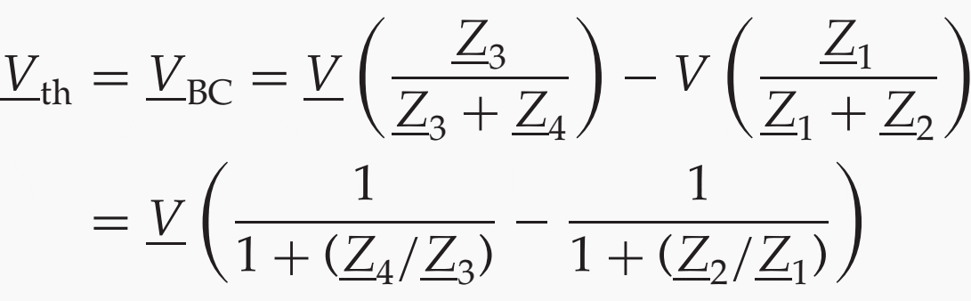

The equivalent Thevenin voltage Vth is calculated by applying Kirchhoff’s second law to the loop DBAD and the voltage divider rule (Equation 1):
Voltage divider rule

In balance conditions of the bridge (i.e., Z1×Z4 = Z2×Z3), it appears clear from Eq. (15.2) that Vth equals zero; therefore, the patient is safe even if the protective conductor of the medical equipment is interrupted.
In practice, the balance condition is rather challenging to both achieve and maintain in time. Although results have been achieved in manufacturing separation transformers with identical capacitance-to-ground, that is, Z1 = Z2, it is rather difficult to obtain medical equipment with symmetrical impedance-to-ground, that is, Z3 ≠ Z3.
Thus, designers cannot rely upon balanced bridges to achieve safety in medical locations.
