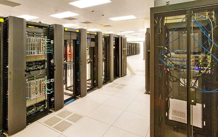

4. SCADA Server Computer
Most SCADA systems include at least one, if not two, data server computers. These computers maintain all of the configuration software for the SCADA system.
The server computer is at the physical centre of the Star topology. Historical data collected over time is maintained on the server computer in the form of databases. Current system operating data from all of the field controllers is also maintained in databases on the server computer.
The server computer performs all of the communications with the PLCs and RTUs on the SCADA network. Each RTU/PLC maintains and collects data pertaining to its process areas. This data is then retrieved by the server computer to update the current process and the historical databases.
This communications is configured to poll or otherwise collect data values from the PLCs/RTUs. Commands and adjustments from the operations workstations are sent out to the PLCs and/or RTUs via the server computer.
In small systems, a single workstation can perform the work of both the server and the operations user workstation.
However, if the system has more than one or two programmable process controllers, then the server operations are best assigned to a dedicated workstation, which could serve as an additional user workstation if needed.
Today, many SCADA applications use Relational DataBase Management System (RDBMS) to store, retrieve and report information. Just as the Comma Separated Value (CSV) file, has become a standard method of transferring data between applications, the RDBMS can be accessed using standardized ‘SQL’ commands from any SQL-compliant application.
Another purpose of the SCADA server computer is to provide an interface to other facilities, typically through the Internet, using Firewalls and SQL interface calls.
It is important that the outside access cannot interfere with the internal operations of the SCADA system, so the server computer often provides a secure interface.
Other departments and users may require data collected by the SCADA system, and so a means of accessing this data can be provided through the SCADA server computer, with the appropriate security measures in place.
SCADA servers
Figure 5 – SCADA servers
