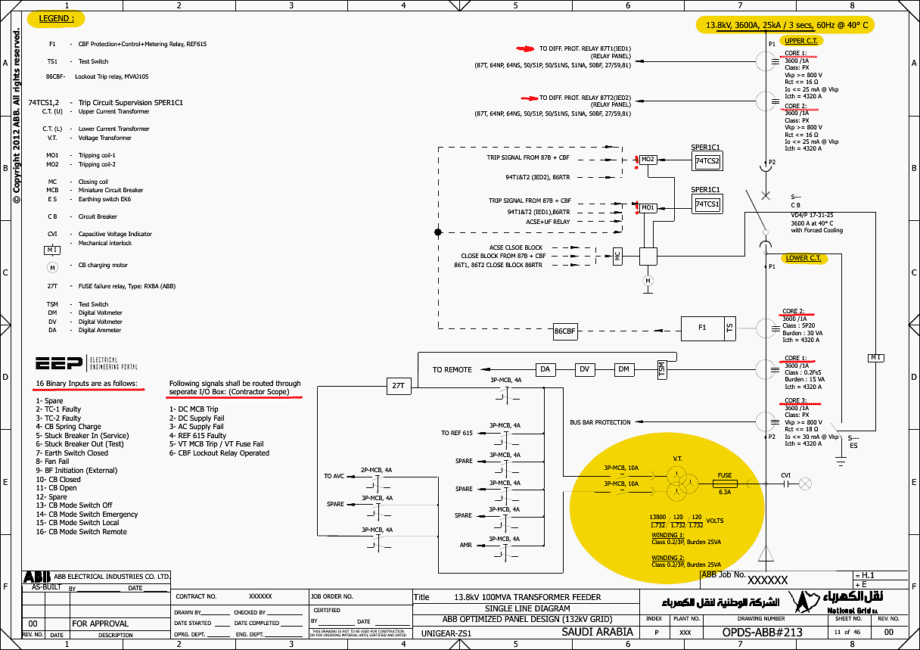

1.2 The Single Line Diagram (SLD)
The Single Line Diagram, located on Sheet 11, serves as the feeder’s power flow and protection arrangement. Power decreases from the 3600A main busbar through various components we’ll mention now.
Immediately below the busbar connection, the Upper Current Transformers +B-CT are positioned. These CTs are dedicated exclusively to providing primary current data to the external transformer differential protection schemes.
Below the upper CTs sits the primary interrupting device, the Vacuum Circuit Breaker +A-Q0. This 3600A breaker is the critical actuator for all protection logic, designed to sever the circuit instantly upon receiving a trip command.
On the load side of the circuit breaker, the Lower Current Transformers +C-CT are installed. These lower CTs are multi-core devices, supplying analog current signals to the digital metering devices, the primary ABB REF 615 feeder protection relay, and the busbar differential protection scheme.
Further down the load side, the Voltage Transformers +C-VT are tapped off the main copper conductors. Protected by primary fuses, these VTs step the 13.8kV potential down to a safe 120V secondary voltage for metering and distance/voltage protection references.
Finally, at the very bottom of the SLD, the Earthing Switch +C-Q2 provides a mechanical means to ground the outgoing cable section, ensuring a zero-potential environment for maintenance personnel.

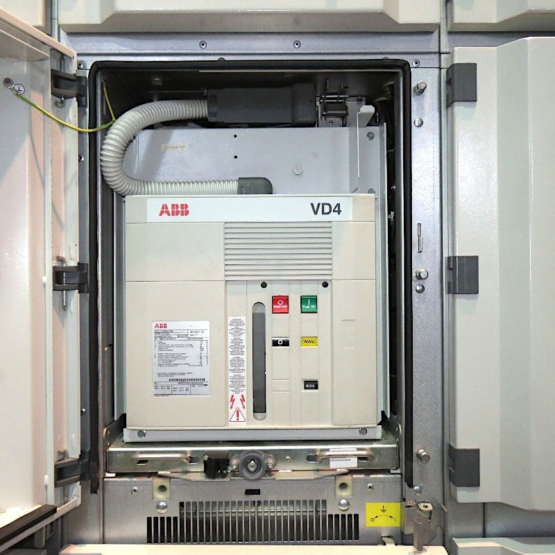

The device is specified as an ABB Vacuum Circuit Breaker, Type VD4/P17.32.25p275. It utilizes an embedded pole design, where the vacuum interrupter is encapsulated within epoxy resin. This encapsulation protects the fragile vacuum bottle from environmental contaminants, dust, moisture, and external mechanical impacts, ensuring long-term dielectric integrity.
The operating cycle defined by IEC standards for this breaker is O-0.3sec-CO-15Secs-CO. This notation dictates the breaker’s duty cycle during an autoreclosing sequence.
It signifies that the breaker can Open (O) to clear a fault, wait for a dead time of 0.3 seconds to allow a transient fault (like a lightning strike) to clear, and then perform a Close-Open (CO) operation.
If the fault persists, it will wait 15 seconds before attempting one final Close-Open (CO) sequence. If the fault is still present, the breaker will lock out.

2.2 Breaker Operating Mechanism and Control Coils
The mechanical operation of the VD4 breaker is driven by a strong spring mechanism. The energy required to close the breaker against the immense electromagnetic forces of a short circuit is stored in this spring. The charging of the spring is controlled by a 125 VDC charging motor -MS.
To ensure unparalleled reliability, the breaker features a suite of 125 VDC control coils, interconnected via a 58-Pole Plug -XB detailed on Sheet 46. These coils execute the commands from the protection relays and safety interlocks:
First Shunt Release OFF (-MO1) – This is the primary tripping coil. Energizing this coil releases the mechanical latch holding the breaker closed.
Second Shunt Release OFF (-MO2) – Complete redundancy is mandatory in protection engineering. -MO2 is an entirely separate coil acting on the same mechanical trip latch. If -MO1 burns out or its wiring fails, -MO2 ensures the breaker can still clear a catastrophic fault.
Shunt Release ON (-MC) – This is the closing coil. When energized, it unlatches the charged closing spring, slamming the vacuum contacts together.
Truck Blocking Coil (-RL2) – This electromechanical lock prevents the breaker truck from being physically racked into or out of the ‘Service’ position unless specific safety conditions are met (e.g., the breaker must be OPEN).
Closing Blocking Coil (-RL1) – This coil acts as a definitive veto over the closing circuit. If -RL1 is not energized (indicating a blocked state), the mechanical closing linkage is disabled, rendering the -MC coil ineffective even if it receives an electrical command.
Furthermore, the breaker contains an internal Anti-Pumping facility. If a continuous mechanical or electrical “CLOSE” command is applied simultaneously with a “TRIP” command, the breaker will open to clear the fault but will mathematically refuse to re-close until the initial “CLOSE” command is entirely removed and re-applied.
This prevents the breaker from continuously “pumping” (opening and closing rapidly), which would destroy the vacuum bottles within seconds.
