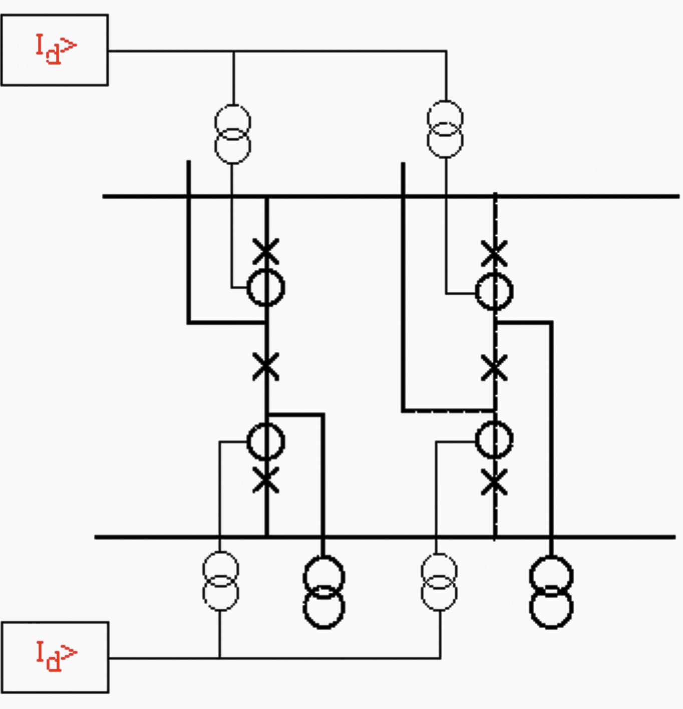

At 1 ½ breakers system arrangements a 2-zone protection must be used as in the Figure 2. If the main CTs have equal ratio, which is normally the case, auxiliary CTs are not necessary.
A two-zone busbar differential relay for 1 ½ breaker switchgear
Figure 2 – A two-zone busbar differential relay for 1 ½ breaker switchgear

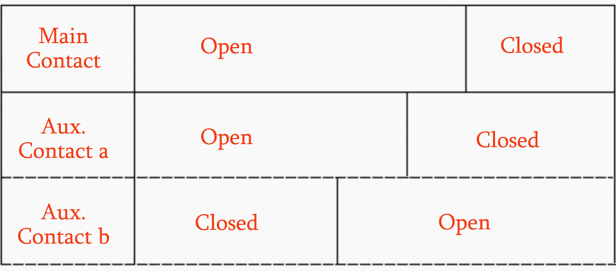

3. Switching in current circuits
For busbar systems, where the object can be connected to more than one busbar, double busbar systems, the current must be switched to the correct zone busbar protection. This switching must be done in such a way that no differential current develops in any of the busbar protections concerned.
The switching is done by using two auxiliary contacts on the busbar disconnectors. These auxiliary contact are energizing throw-over relays which perform the switching in the CT-circuits. The disconnectors auxiliary contacts must be provided as in Figure 5.
Following requirements must be fulfilled by the auxiliary contacts “a” and “b” respectively:
  • The auxiliary contact “a” must close minimum 100 ms before the main contact can start to carry current.
  • The auxiliary contact “b” must open before the auxiliary contact “a” closes.
  • The auxiliary contact “b”must not close before full insulation is secured (normally at 80% of the full insulation distance).
Connection busbar disconnector auxiliary contacts table
Requirements and connection of busbar disconnector auxiliary contacts, for switching of bistable repeat relays
Figure 5 – Requirements and connection of busbar disconnector auxiliary contacts, for switching of bistable repeat relays

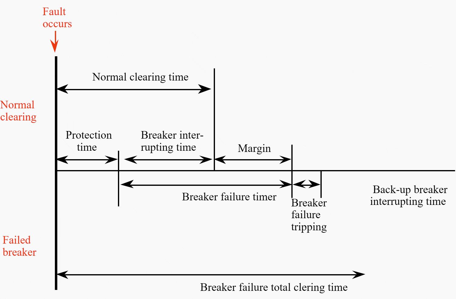

6. Breaker failure relays
In order to take care of possible breaker failure, Circuit Breaker Failure relays normally are installed in high voltage, and extra high voltage systems. All protection tripping (not manual opening) will start a current relay measuring the current through the CB. If the current has not disappeared within the set time, all adjacent CBs will be tripped to clear the fault.
The time “split up” at a normal tripping and a breaker failure tripping is shown in Figure 7.
Time scheme for breaker failure relays
Figure 7 – Time scheme for breaker failure relays
In normal cases the total fault clearing time will be the protection relay operating time plus the CB interrupting time. Every time a relay gives a trip order it will at the same time start the Circuit Breaker Failure (CBF) relay. The CBF-timer will be running as long as the current is flowing through the CB. When the CB interrupts the current the CBF-current relay will reset and the CBF-timer will stop.
The setting of the CBF-timer must be: maximum interrupting time of the ordinary CB, plus the reset time of the CBF-current relay, plus the impulse margin time of the CBF-timer, plus a margin.
With “impulse margin time” is meant the difference between set time and the time “to no return”. If the timer is set to 100 ms and is fed during, lets say 98 ms, it will continue to operate since the margin between the set time and the actual time is small.
The margin should be chosen to at least 50-60 ms to minimize the risk of unnecessary tripping, specially considering the heavy impact on the network a CBF tripping will cause.
