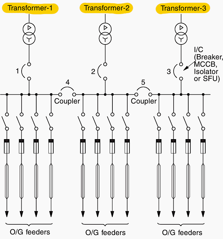

1. Schemes with more than one source of supply
When there are more than one sources of supply, it is advisable to distribute the loads also in as many sections as the incomers, and offer a tie-circuit between every two sections, to achieve additional flexibility. Now fault on one segment or source of supply will not result in power failure to the entire system.
Figures 1 and 2 depict this type of distribution. Current limiting fuses must be installed at both ends of potential/control transformers.
It is important to note that for big industrial and other LV loads, it is common practice to select multiple transformers with lower ratings to meet the needed load rather than a single transformer with greater capacity. Similarly, when more than one transformer is utilized to serve an important industrial load, the load must be distributed in as many sections as there are transformers.
Parallel operation of any two transformers must be avoided, even if they are compatible and have the same power source. Otherwise, the impedances of all transformers operating in parallel would drop in parallel. It reduces the effective impedance of the faulty circuit and increases the system fault level. The use of current limiting reactors on LV systems is not encouraged due to the reactor’s relatively large losses in comparison to the power it handles.
Figures 1 and 2 depict a few typical but widely used distribution networks.
Figure 1 – Interlocking requirements for two-feeders system
Figure 2 – Interlocking requirements for a three-feeders system

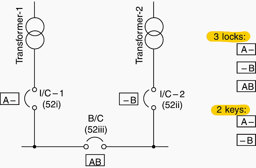

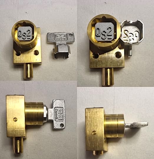

2.1 Use of switchgear castell locks
Different figure locks such as A – , – B and AB are used with a common master key. See Figure 3. The master key can unlock all locks A – , – B or AB because it has grooves for both A and B but will be locked with the lock that it unlocks.
For the removal of the key, the lock must first be locked. Only then can the key be used for the other locks, so accomplishing the required interlocking. The lock secures the lever of the interrupter’s closing mechanism, blocking its closure.
Lock AB can be unlocked by either of the keys A – or – B. The number of locks will be the same as the number of interrupting devices, but the keys will be less and will be for only as many interrupting devices as are permitted to be switched at a time (generally equal to the number of supply sources).
Figure 3 – Switchgear Castell locks

2.3 Scheme with two sources of supplies and a bus coupler
The two incomers (I/C) and the coupler can be fitted with three locks, A –, – B and AB and two keys A – and – B : locks A – and – B for the incomers and AB for the coupler. The key A – can operate I/C-1 or the coupler and key – B can operate I/C-2 or the coupler.
Thus, only two of the three interrupting devices, I/C-1 and coupler, I/C-2 and coupler, or I/C-1 and I/C-2 can be switched at a time to achieve the required interlocking.

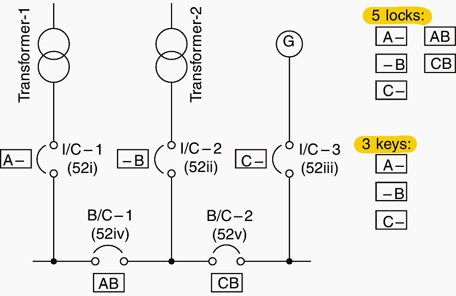

2.4 Scheme with three sources of supplies and two bus couplers
The three incomers and two couplers can be fitted with five locks, A – , – B , C – . AB and CB and three keys A – , – B , and C – .
Figures 4, 5, and 6 are mechanical interlocking schemes.
The interlocking is achieved as follows:
  • Key A – can allow switching of I/C-1 or coupler 1
  • Key B – can allow switching of I/C-2, coupler 1 or coupler 2 and
  • Key C  – can allow switching of I/C-3 or coupler 2
Consequently, just three of the five interrupting devices may be switched simultaneously as necessary, without causing a parallel operation between any two incoming sources.
For a larger number of supply sources, each having two interrupting devices, one as incomer and the other as coupler, two more locks, i.e. – D and CD and one key, i.e. – D may be added for each extra source and so on.
See Figure 6.
Figure 6 – Three sources of supply and two bus couplers

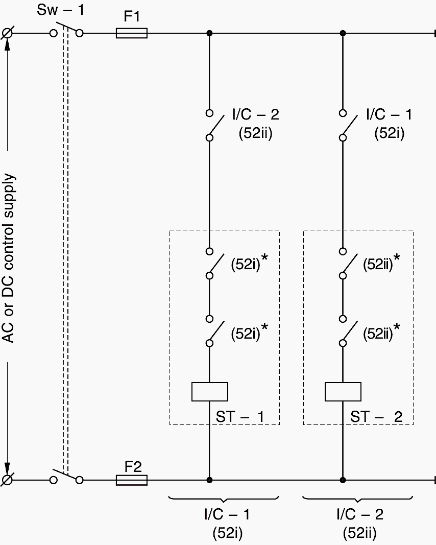

3.1 Scheme with two sources of supplies
The NO (normally open) contact of I/C-1 (52i) is wired in the trip circuit of I/C-2 (52 ii) and vice versa. As soon as an interrupter is closed, the tripping circuit of the other gets ready to trip. See Figure 7.
Important Note!
The function of a shunt trip coil is to trip an interrupter. It releases the interrupter’s closing lever and trips it as soon as its coil is energized. The coil is rated for a short-time, since it is in the circuit for a very short-period only when it is required to trip the interrupter.
To ensure that it does not continue to remain energized after carrying out its function, the interrupter’s ‘NO’ contacts are also wired in series with the coil as shown.
The coil becomes de-energized as soon as the interrupter trips. Normally two NO contacts of the interrupter are wired in series, as standard practice, by the interrupter (breaker or MCCB) manufacturers to share the arc energy on a trip and enhance contact life, particularly when the control supply is d.c. which normally is the case.
Figure 7 – Electrical interlocking scheme for manually operated breakers for two sources of supplies
* Note: Normally 2NOs of the interrupters are wired in series to share the arc energy and enhance the contact life.

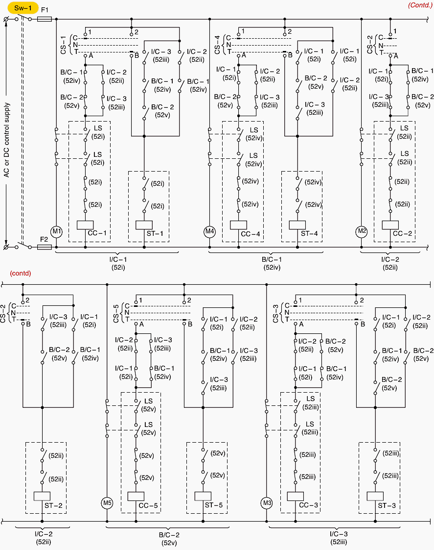

3.3 Scheme with three sources of supplies and two bus couplers
The scheme is now more complicated but the following logical approach will make it simple. See Figure 9.
(a) When I/C-1 (52i) is required to be switched
  1. (i) Interlocking with I/C-2 (52ii): I/C-2 (52ii) and B/C-1 (52 iv) should not be in a closed position at one time.
  2. (ii) Interlocking with I/C-3 (52iii): I/C-3 (52iii), B/C-1 (52iv) and B/C-2 (52v) should not all be in a closed position at one time. Refer to the control scheme for I/C-1 (52i).
(b) When I/C-2 (52ii) is required to be switched
  1. Interlocking with I/C-1 (52i): I/C-1 (52i) and B/C-1 (52iv) should not both be in a closed position at one time.
  2. Interlocking with I/C-3 (52iii): I/C-3 (52iii) and B/C-2 (52v) should not both be in a closed position at one time. Refer to the control scheme for I/C-2 (52ii).
(c) When I/C-3 (52iii) is required to be switched
  1. Interlocking with I/C-2 (52ii): I/C-2 (52ii) and B/C-2 (52v), should not both be in a closed position at one time.
  2. Interlocking with I/C-1 (52i): I/C-1 (52i), B/C-1 (52iv) and B/C-2 (52v) should not all be in a closed position at one time. Refer to the control scheme for I/C-3 (52iii).
(d) When B/C-1 (52iv) is required to be switched
  1. Interlocking with I/C-1 (52i) and I/C-2 (52ii): These should not be in a closed position at one time.
  2. Interlocking with I/C-1 (52i) and I/C–3 (52iii): I/C-1 (52i), B/C-2 (52v) and I/C-3 (52iii) should not all be in a closed position at one time. Refer to the control scheme for B/C-1 (52iv).
(e) When B/C-2 is required to be switched
  1. Interlocking with I/C-2 (52ii) and I/C-3 (52iii): Both should not be in a closed position at one time.
  2. Interlocking with I/C-1 (52i) and I/C-3 (52iii): I/C-1 (52i), B/C-1 (52iv) and I/C-3 (52iii) should not all be in a closed position at a time. Refer to the control scheme for B/C-2 (52v).
Figure 9 – Electrical interlocking scheme for manually operated breakers for three sources of supplies and two bus couplers
* Note! Normally 2NOs of the interrupters are wired in series to share the arc energy and enhance the contact life.

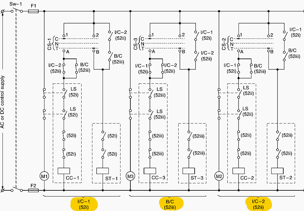

3.4 Electrical interlocking schemes
When the interrupters are also electrically operated

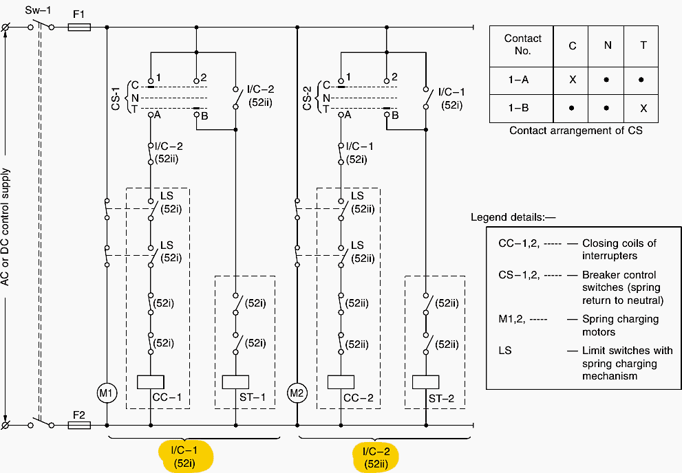

Motor-operated interrupting devices are applied when the system requires remote-controlled power switching, like for an auto-reclosing scheme. With the addition of a circuit for the motor spring charging mechanism and the interrupter’s closing coil, the electrical interlocking schemes essentially stay the same. See the Figure 10.
Brief details of the electrical closing features are as follows.
Spring charging motor mechanism
The purpose of the motor is to charge the closing spring that closes the interrupter, independently of the speed and operation of the motor or of the operator when closed manually. (The interrupter can be closed manually or electrically when the spring is fully charged.)
As soon as the spring is discharged, the motor recharges it automatically to prepare it for the next operation. The motor may be fed through the same source as for the main control scheme or another source, depending upon the system design. But the source must be reliable and independent of the main power supply as far as possible (such as through a battery).
Important Note! Small interrupters and MCCBs particularly may be electrically operated through a solenoid valve.
Figure 10 – Control scheme for two electrically operated breakers and two sources of supplies
3.4.1 Limit switch (LS)
The spring charging mechanism is fitted with a limit switch, having generally 2NO and 2NC change-over contacts. The 2NC contacts are wired in series with the motor to allow it to charge the spring mechanism immediately on discharge of the spring, to prepare it for the next operation.
As soon as the spring is fully charged, the NC contacts change over to NO and cut off the supply to the motor terminals. See Figure 11 below.
The 2NO contacts of the limit switch are wired in series with the closing coil of the interrupter. As soon as the spring is fully charged these contacts change over to NC and the closing coil circuit gets ready to close.

Figure 11 – Control scheme for two electrically operated breakers, a bus coupler and two sources of supplies
