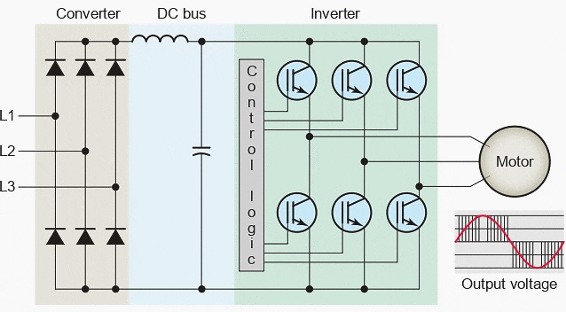

Figure 1 shows the block diagram of a typical three-phase VFD controller.
Figure 1 – Block diagram of a typical Variable Frequency Drive (VFD)
Block diagram of a typical VFD
Figure 1 – Block diagram of a typical VFD
The function of each VFD block is as follows:
Converter
A full-wave rectifier that converts the applied AC to DC.
DC bus
Also referred to as a DC link connects the rectifier output to the input of the inverter. The DC bus functions as a filter to smooth the uneven, rippled output to ensure that the rectified output resembles as closely as possible pure DC.
Inverter
The inverter takes the filtered DC from the DC bus and converts it into a pulsating DC waveform. By controlling the output of the inverter, the pulsating DC waveform can simulate an AC waveform at different frequencies.

Control logic
The control logic system generates the necessary pulses used to control the firing of the power semiconductor devices such as SCRs and transistors. Fairly involved control circuitry coordinates the switching of power devices, typically through a control board that dictates the firing of power components in the proper sequence.
An embedded microprocessor is used for all internal logic and decision requirements.
The number of pulses of a converter defines the number of commutations, which are used within one fundamental period, to convert AC to DC. The basic converter for a three-phase system is a B6 topology (see Figure 2). The B6 converter uses 6 commutations within one fundamental period. This results in a commutation every 60 degrees.
