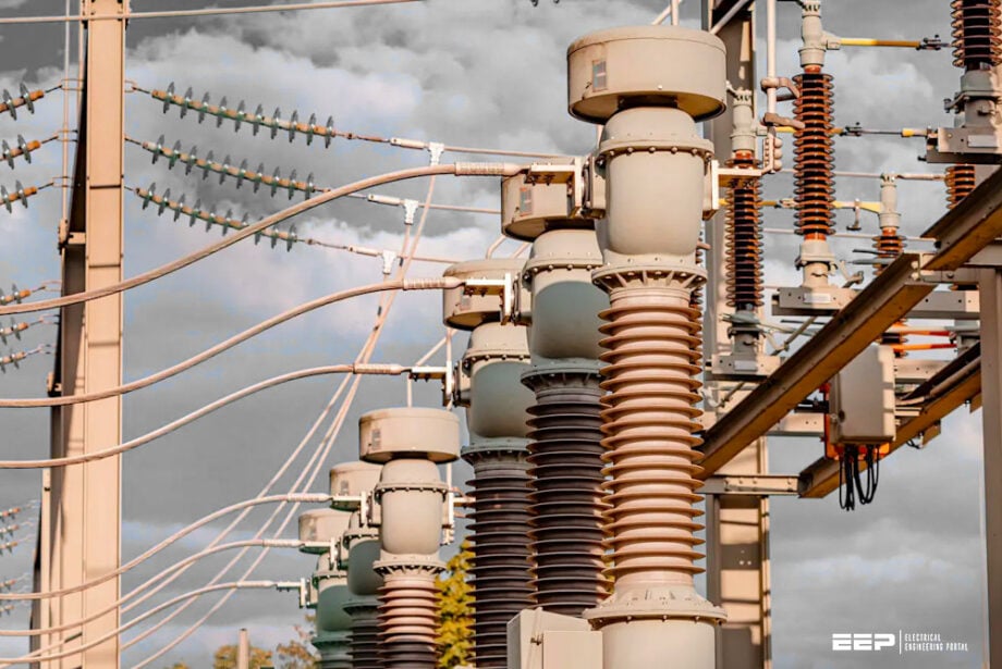

Strategy #2: Low-profile equipment
The second strategy, as an option is a low-profile equipment configuration utilizing rigid tubular conductors mounted on post insulators instead of traditional flexible strung conductors, along with redesigned gantry and equipment structures to replace steel lattice frameworks.
A rigid conductor arrangement possesses superior aesthetic appeal compared to flexible strung conductors.
Figure 2 – Substation rigid busbars

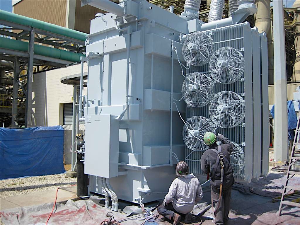

Strategy #3: Coating heavy equipment
Third strategy is coating heavy equipment, including transformers and their supporting frameworks, so they blend with the surrounding area.
Figure 3 – Transformer coating
Transformer coating

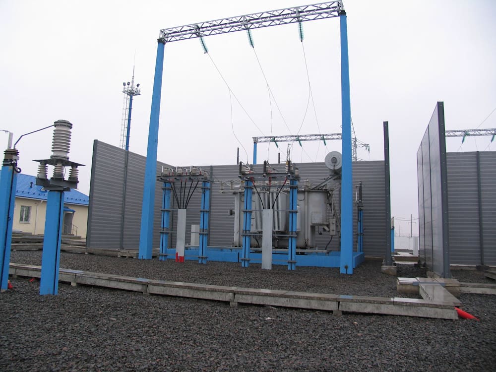

The lack of appropriate countermeasures to address design, size, color, etc., makes it difficult to blend these buildings into the surrounding landscape, even though they may be quite small.
See Figure 4.
Figure 4 -The roof of the control building is painted blue to pair with support structures for transformer incoming/outgoing lines
Figure 4 – The roof of the control building is painted blue to pair with support structures for transformer incoming/outgoing lines

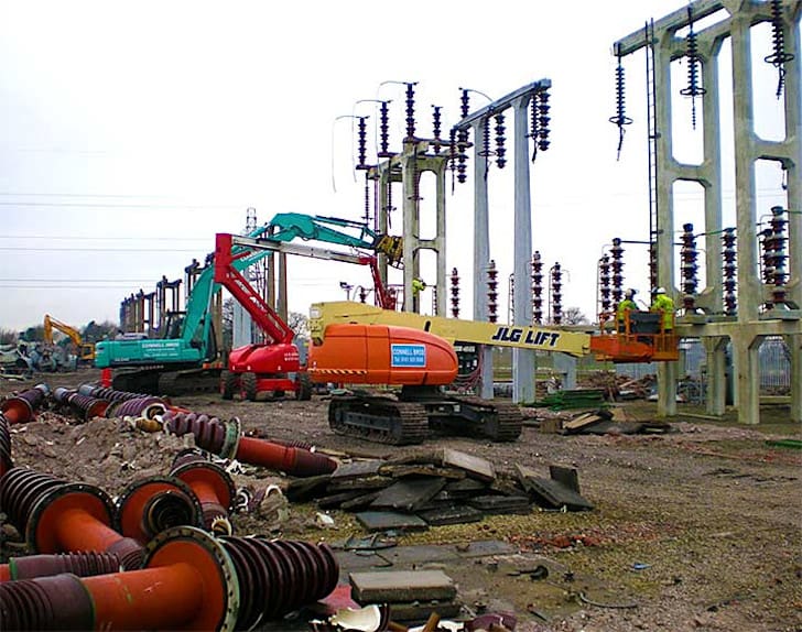

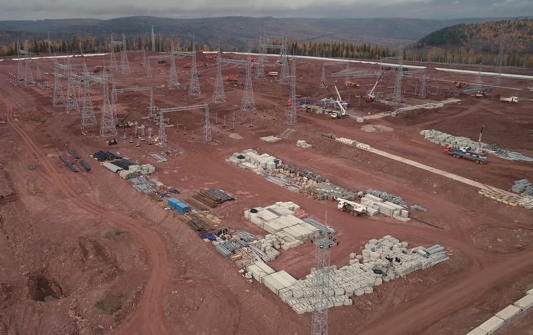

2.2 Warehouses and storage areas
Substations may also include clearly defined facilities for storing spare parts and waste materials. Some substations may have waste products and spare parts dispersed across the site, making it impossible for an outsider to differentiate between the two.
Figure 6 – Substation in construction lacking storage area
Substation lacking waste storage area
A preferable alternative would be to designate separate storage locations for spare parts and waste goods. These places should be properly identified and, if possible, should not be positioned in regions of high visibility.
Routine maintenance of storage and trash sites is advised in order to improve substation aesthetics and achieve community acceptability.

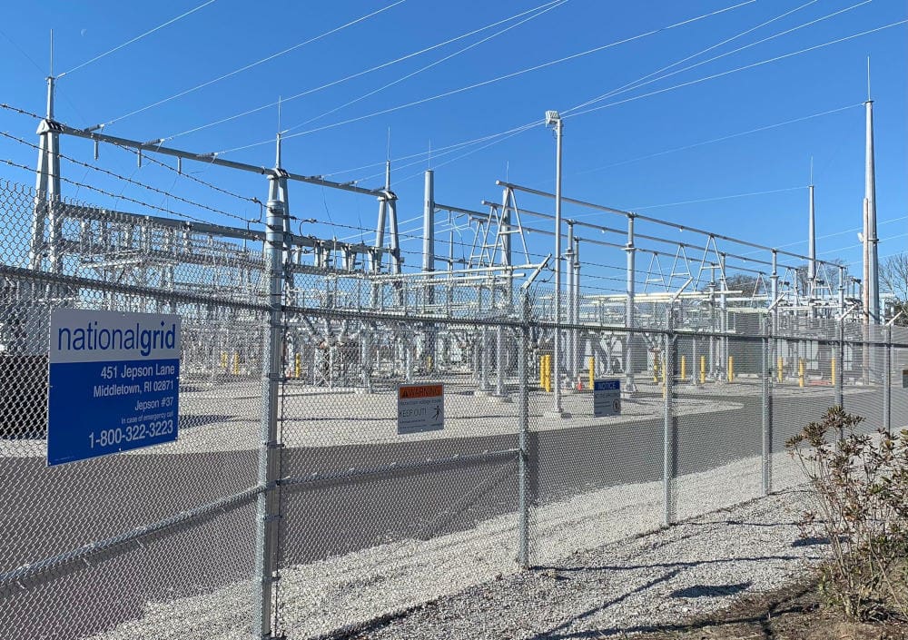

3. Measures to be taken on Perimeter Fences
Power regulations and guidelines mandate that all power substations be secured by a chain-link fence or masonry wall of certain height. The perimeter fence must display high voltage warning signs on all sides to caution non-substation personnel against trespassing on the site.
Substations are required to be enclosed by one or more fences around the whole perimeter of the facility. Typically, perimeter fence consists of reinforced galvanized steel chain links. Alternatively, substations may be surrounded by concrete barriers.
The benefit of employing a chain-link fence is its transparency, which may diminish the visual impact of the substation in more natural environments, such as agricultural fields and farmlands. Furthermore, the average expense of a chain-link fence is inferior to that of any sort of wall.
Moreover, the implementation of a chain-link fence may motivate substation personnel to maintain the interior in an orderly manner, as its contents will be accessible to the public.
Figure 8 – The interior of the substation is visible through the chain-link fence
To visually screen the substation with natural features in the environment, plants can be installed along the perimeter of the chain-link fence to create a fence of vegetation. This way we can diminish the visual impact of the substation by alterations to the perimeter fence.
In the case of a 400/220kV transmission substation in the Figure below, the interior of the substation is lined with trees.

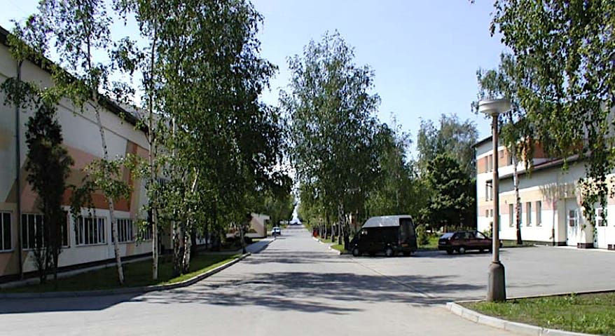

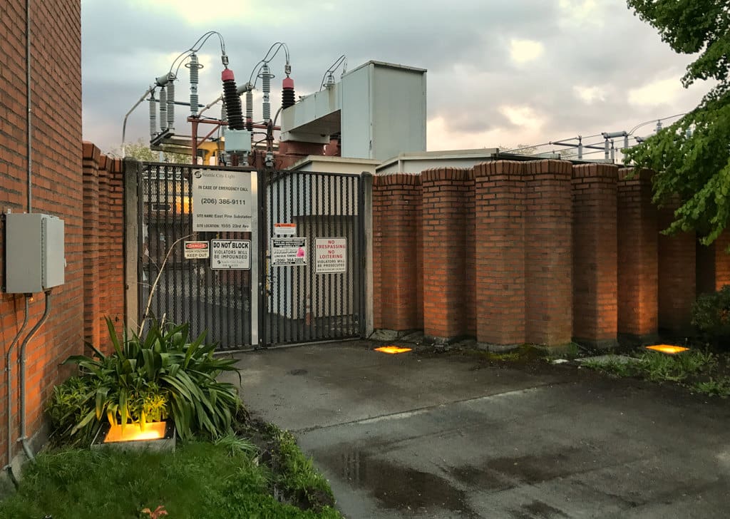

4. Important Steps Regarding Access Roads and Gates
Substations typically have metal gates installed for vehicle access. Usually, a single-leaf gate is utilized to grant access to personnel. The chances of being able to change the gate’s design after installation are low.
Hence, it’s probable that current gates will only be able to have their paint colors changed if any changes are made to their design.
Figure 10 – Substation gates
Substation gates

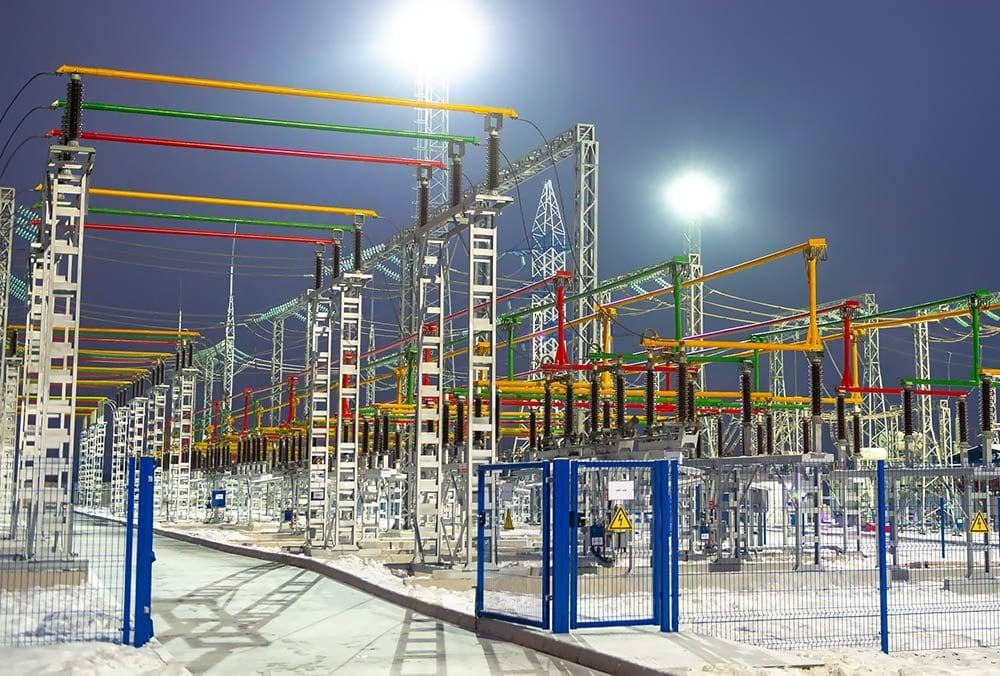

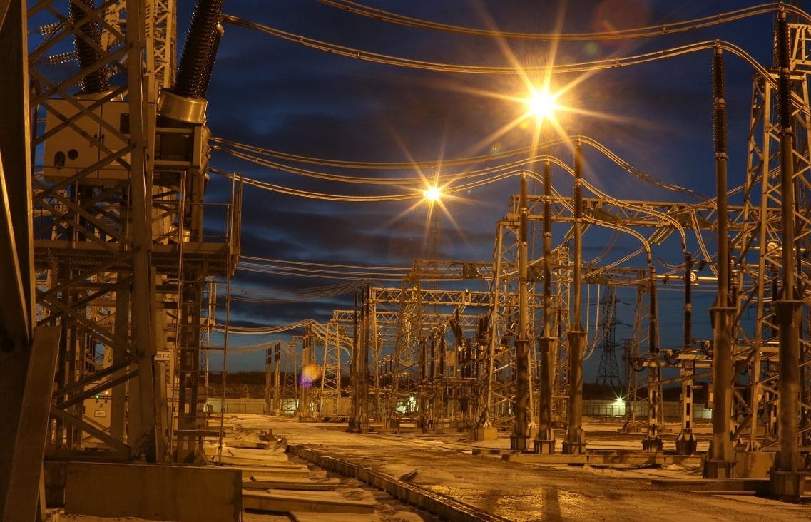

6. What has to be done regarding lighting
In order to facilitate nighttime emergency work and to prevent break-ins and theft, substations should be fitted with powerful lighting systems. Substations sometimes have powerful illumination that can be a nuisance to local residents due to the increased light pollution in the area. The local wildlife’s habits could be influenced by the illumination as well.
To circumvent these consequences, it is recommended to establish a lighting control system that limits the lumens in the switchyard. At night, it is also possible to apply specialized lighting effects like spot lighting, light guides, color lights, etc.
The amount of light needed for on-site work in unusual situations, including beak-downs or outages, should be different from the amount of light needed for security purposes. To allow for lighting in the substation to be adjusted according to the situation, it is advised to construct two supplementary lighting systems with varying light intensities.
It is advised that the substation lighting system be comprised of two parts: one that deters burglars with a lower light intensity and another that improves the yard’s visibility for substation visits and nighttime repairs. In the control room, there can be a physical switch for the backup system.
In order to floodlight the substation in case of unwanted access, an automated lighting system that is linked to the substation control system could also be considered.
In order to determine the best lighting system for a substation in terms of efficiency, effectiveness, cost, and user-friendliness, it is typically advised to undertake a lighting study.
Figure 12 – An example of good lighting design in a substation

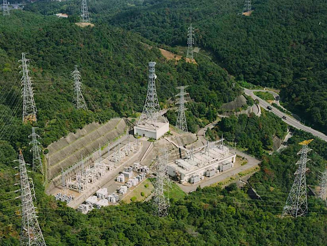

The solutions chosen to condition the slopes will determine the substation’s visual impact. For instance, by incorporating shrubs, bushes, or tree cover into the slopes, they can better balance with the surrounding environment. Depending on the needs of a certain substation, any or all of the aforementioned actions can be taken.
A substation with a “stepped” switchyard that takes advantage of the surrounding landscape’s natural slopes is shown in case study below. Here, the cost of land leveling the substation was significantly lowered by implementing a stepped switchyard.
Figure 13 – 275/154/77kV stepped substation constructed on a mountain
This case study pertains to a 275/154/77kV substation constructed on a mountain. Two critical factors must be considered when situating a substation on a mountain: obtaining a level location of sufficient size and assessing the substation’s impact on the surrounding terrain. Both problems can be resolved via a “stepped” switchyard.
The steps of the substation were built as follows:
  1. 1st Layer: 275kV switchgear and 275/ 154kV transformer yard
  2. 2nd Layer: 154/77kV transformer and 77kV shunt reactor
  3. 3rd Layer: 154 kV switchyard
  4. 4th Layer: Control/ protection room and 77kV switchyard
Minimal impact on the natural environment and drastic curtailment of land reclamation expenditure were achieved.
