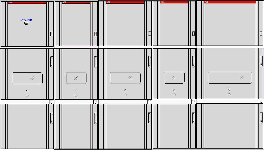

1. Switchgear Layout and Foundation Details
The physical configuration of the 10kV Motor Control Centre is explicitly detailed in the ‘Front View (total)’ drawings on sheets =S01&ELU/1 and =S01&ELU/2. The switchgear lineup is constructed as a contiguous array of modular, metal-enclosed cubicles.
The total height of the assembly is defined as 2200 mm, a standard dimension that accommodates the vertical stacking of the circuit breaker truck compartment, the busbar compartment, and the low-voltage control cabinet situated at the top of each panel.
The lineup consists of several distinct panels, each dedicated to a specific operational role within the substation environment. Moving across the front view, the widths of the panels vary based on their internal equipment requirements.
We observe panels with widths of 800 mm, 640 mm, and 650 mm.
Figure 1 – MCC Front View
MCC Front View
The wider 800 mm panels typically house the incoming feeders or complex motor starters that require additional spatial volume for current transformers, heavy cabling, and potential autotransformer accommodations. The 650 mm and 640 mm panels are standard widths for outgoing motor feeders and metering panels.

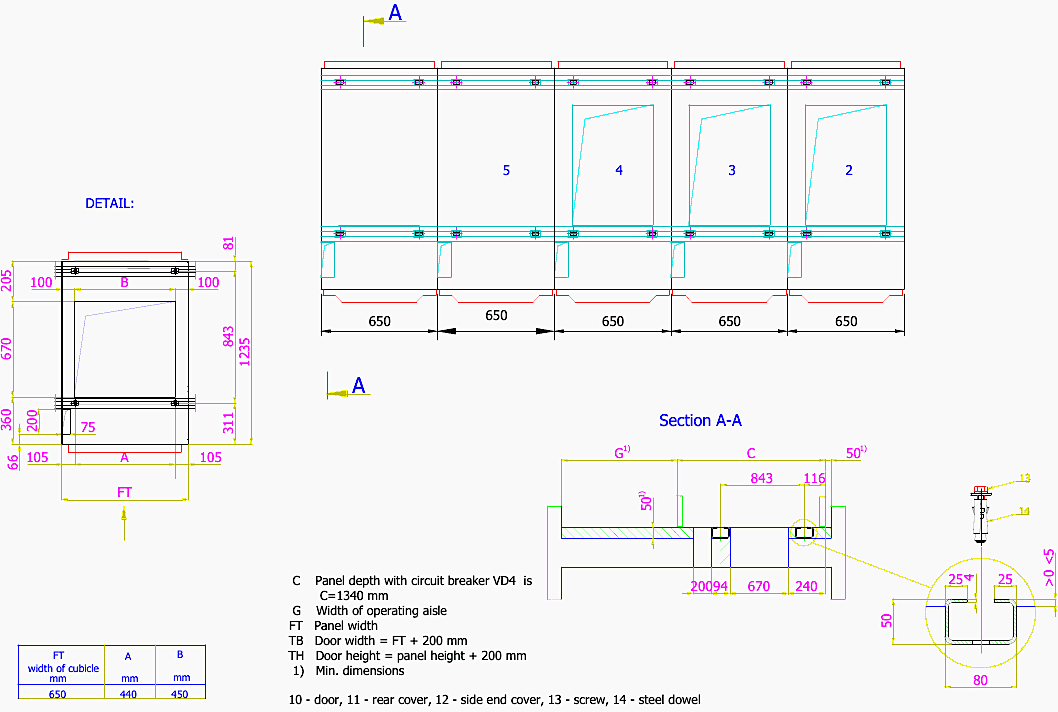

Sheet =S01&ELU/3 provides the ‘Foundation frame‘ details, which dictate the civil engineering requirements for the switchgear installation. The depth of the panels equipped with the primary VD4 circuit breakers is specified as 1340 mm.
Furthermore, the drawing explicitly mandates a minimum operating aisle width (labeled as dimension ‘G‘) to ensure safe personnel movement and breaker extraction.
The panel width (‘FT’) directly influences the required floor cutout dimensions. The foundation drawing illustrates the exact placement for the 10-door, 11-rear cover, and 12-side end cover structural mounting points, ensuring the mechanical integrity of the metal-clad structure during an internal arc fault event.
Figure 2 – MCC Foundation frames

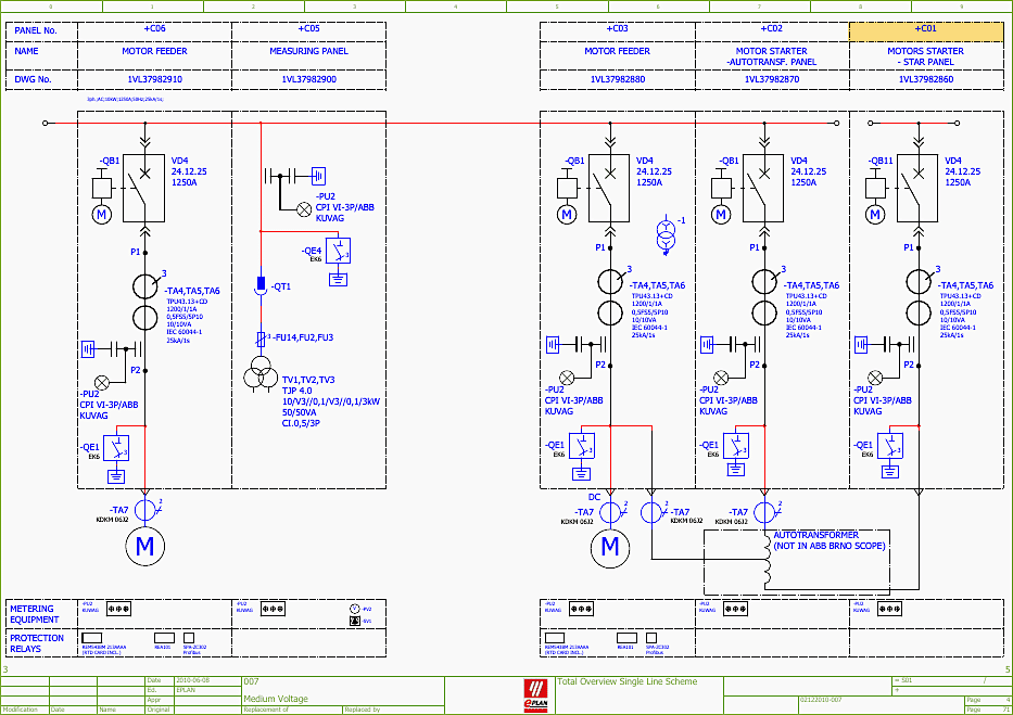

The primary electrical components are mapped on the ‘Total Overview Single Line Scheme’ on sheet =S01&EFA/4. This drawing provides the macro-level view of the power distribution architecture. The panels are designated as follows:
  • +C06 (Motor Feeder),
  • +C05 (Measuring Panel),
  • +C04 (Motor Feeder),
  • +C03 (Incoming Feeder),
  • +C02 (Motor Starter / Autotransformer Panel), and
  • +C01 (Motor Starter Star Panel).

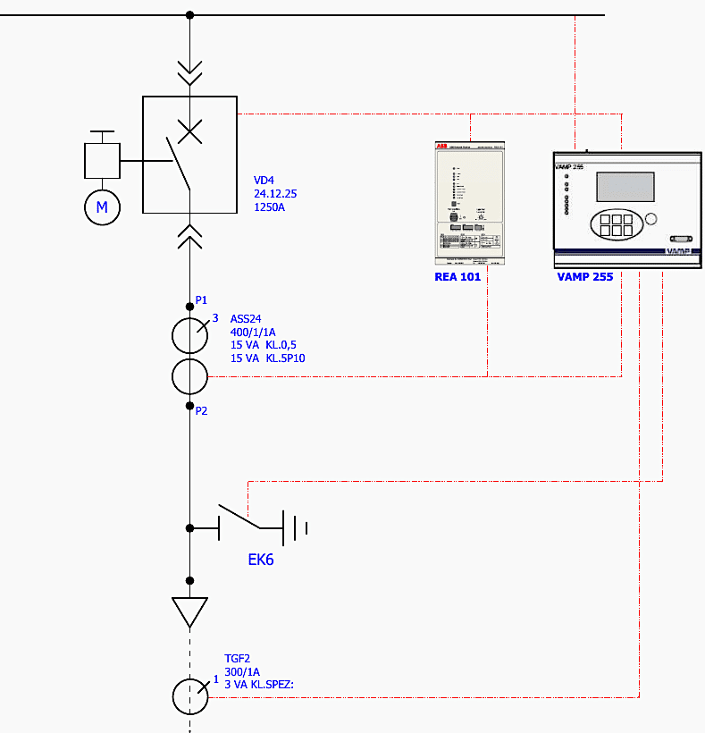

At the heart of the power interruption capability in panels +C01, +C03, +C04, and +C06 is the ABB VD4 vacuum circuit breaker. The specific model referenced in the drawings is the VD4 24.12.25 1250A. This indicates a breaker rated for up to 24kV maximum system voltage, a short-circuit breaking current of 25kA, and a nominal continuous current rating of 1250A.
The VD4 utilizes vacuum interrupters embedded in epoxy resin poles.
Figure 3 – MCC Single Line Scheme
When a trip command is issued, the spring-operated mechanism rapidly separates the contacts within the vacuum chamber. The high dielectric strength of the vacuum instantly quenches the resulting arc at the first zero-crossing of the AC current waveform, ensuring rapid and safe fault clearance.
This breaker is truck-mounted, allowing it to be racked in (Service position) and out (Test/Disconnected position), which is a critical feature integrated into the interlocking logic.

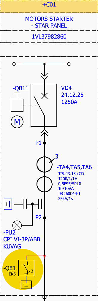

For personnel safety during maintenance, the switchgear relies on the EK6 Earthing Switch, identified as -QE1. As seen on the single-line diagram (sheet =S01&EFA/4), the EK6 is a fast-acting, make-proof earthing switch. This means it is mechanically designed to safely close onto a live short circuit without catastrophic failure, protecting the operator if the switch is inadvertently closed while the feeder is energized.
The operation of the EK6 is tightly interlocked with the VD4 breaker truck position.
Figure 4 – EK6 Earthing Switch in +C01 panel

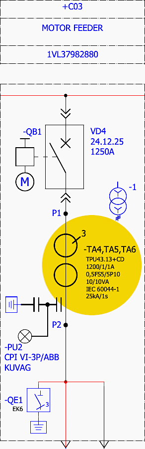

Current and voltage measurement is handled by high-precision instrument transformers. The Current Transformers (CTs) are specified as TPU43.13+CD. These are high-performance cast-resin CTs with a ratio of 1200/1/1A, meaning they have a primary rating of 1200A and two secondary cores rated at 1A each.
One core is dedicated to highly accurate metering (Class 0.5FS5), and the other is dedicated to protection relays (Class 5P10).
The 5P10 designation guarantees that the CT will maintain its specified accuracy up to 10 times the rated current without core saturation, which is vital for the overcurrent protection relays to ‘see’ the true magnitude of a fault.
Figure 5 – Current Transformers (CTs) in +C03 Motor Feeder Panel
The Voltage Transformers (VTs), designated as TJP 4.0, provide stepping down of the 10kV primary voltage to standard secondary voltages (e.g., 100V or 110V) for the metering equipment and directional protection elements.

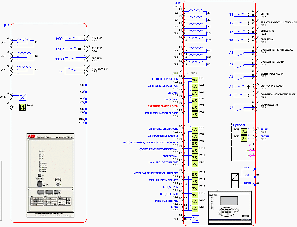

The secondary protection is provided by an array of digital relays. The primary motor protection relay utilized in the starter panels is the ABB REM5438M (motor protection terminal listed on the overview sheet). This device handles comprehensive motor protection algorithms, including thermal overload, locked rotor, repeated starts, unbalance, and short circuit protection.
It interfaces with an RTD card to directly monitor motor winding and bearing temperatures.
Figure 6 – Arc Fault Protection Using the VAMP 255 and REA 101 relays
Additionally, the system incorporates dedicated arc fault protection using the VAMP 255 and REA 101 relays. These systems use optical sensors distributed throughout the busbar and cable compartments. If an internal arc flash occurs, the optical sensors detect the intense light, and the relay simultaneously measures an overcurrent spike.
This dual-verification allows the VAMP/REA system to issue a trip command in less than 2 milliseconds, vastly reducing the destructive energy of an internal arc.

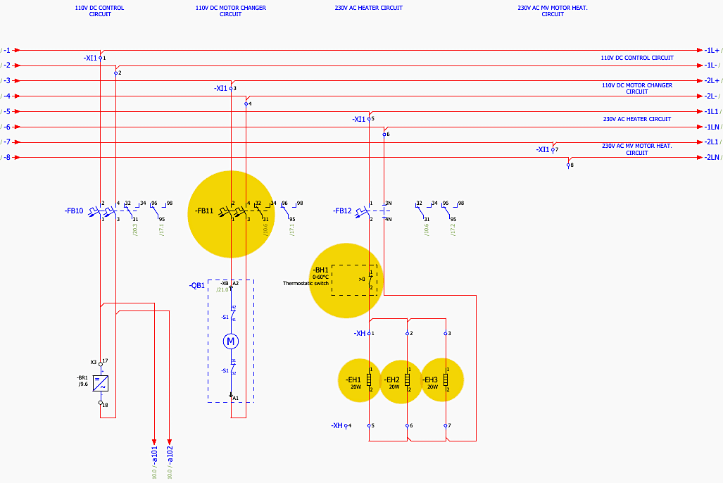

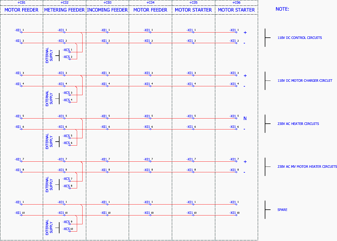

3. Auxiliary Voltage Circuits and Control Circuits

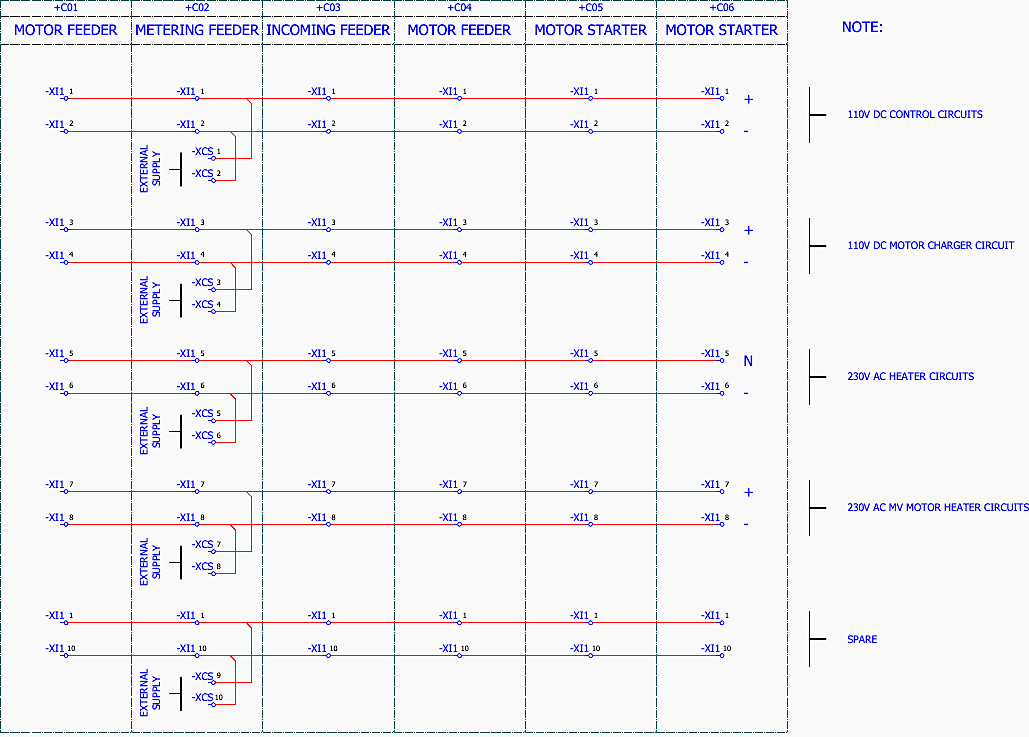

The operational reliability of the MCC depends entirely on the integrity of its auxiliary power supplies. The detailed schematic for these supplies is located on sheet =S01+C01&EFS/5 (Aux. voltage supply). The drawing is divided vertically into discrete functional circuits, typically referenced by columns (e.g., columns 1 through 8 across the page).
The primary control voltage is 110V DC, entering the panel through terminal block -XI1. The 110V DC Control Circuit is protected by a two-pole miniature circuit breaker (MCB) designated as -FB10.
This MCB, explicitly listed in the bill of materials as a Siemens 55X2106-8 (though standard Siemens part numbers usually follow the 5SY4 or 5SP format, the drawing specifically uses this string), ensures that a short circuit in the delicate relay logic wiring does not compromise the entire substation DC battery bank.
Figure 7 – Interconnection Terminal -X11 that distributes 110V DC Control Circuit
Parallel to this is the 110V DC Motor Charger Circuit, protected by -FB11. This circuit is exclusively dedicated to supplying power to the charging motor -MS inside the VD4 circuit breaker.
Isolating the spring charging motor from the sensitive control logic prevents the heavy inductive current draw of the motor from causing voltage dips or transients that could reset the digital protection relays.
Environmental control within the switchgear cubicles is managed by the 230V AC Heater Circuits. High voltage switchgear is susceptible to partial discharge and insulation degradation if condensation forms inside the compartments. To combat this, the panels are equipped with anti-condensation heaters (-EH1, -EH2, and -EH3, rated at 20W each). These heaters are powered through terminal -XI1 (pins 5 and 6) and protected by MCB -FB12.
The operation of these heaters is regulated by a thermostatic switch -BH1, which has an adjustable range of 0-60°C. When the internal ambient temperature drops below the setpoint (or humidity rises, depending on the specific hygrostat/thermostat combo), -BH1 closes its contact, energizing the 20W heaters to raise the temperature above the dew point.
An additional 230V AC circuit is provided specifically for the MV Motor Space Heater, routed through terminal -XI1 pins 7 and 8, ensuring the primary 10kV motors remain dry during prolonged standstill periods.
Figure 8 – Auxiliary Voltage Supply

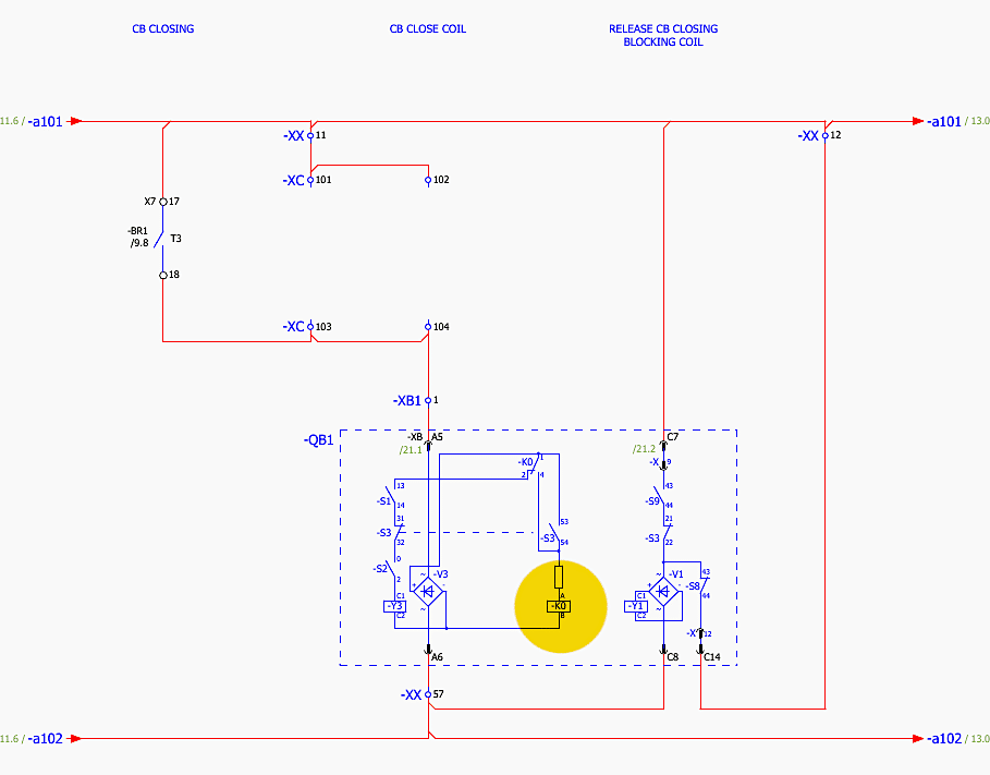

4. Analysis of Tripping and Closing Circuits
The core function of the switchgear is its ability to reliably close and open the primary circuit under both normal and fault conditions. The Closing Circuit is depicted on sheet =S01+C01&EFS/12, and the Tripping Circuit on sheet =S01+C01&EFS/13. These schematics require careful column-by-column analysis to understand the logical flow of command signals.
Starting with the Closing Circuit =S01+C01&EFS/12, the 110V DC positive rail -a101 feeds into the circuit. The actual closing operation of the VD4 breaker is initiated by energizing the shunt closing release coil, designated as -Y3.
However, before voltage can reach -Y3, the circuit must pass through a series of stringent permissive contacts. Firstly, the signal must pass through the ‘Release CB Closing Blocking Coil’ logic. This ensures that a close command cannot physically execute if a blocking condition (such as an active trip signal or an interlocking failure) is present.
Once past the block, the command is routed through the local/remote control switches and the internal auxiliary contacts of the breaker itself (-S1, -S2, -S3).
Figure 9 – Closing Circuits
Closing Circuits
Specifically, the breaker’s internal anti-pumping relay -K0 is integrated here. If a continuous closing signal is applied while a trip condition exists, the breaker will open and the -K0 relay will latch, preventing the breaker from repeatedly closing and opening (pumping) and destroying itself.

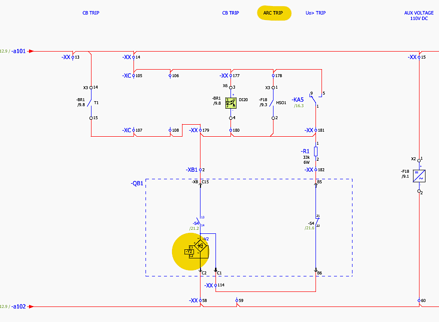

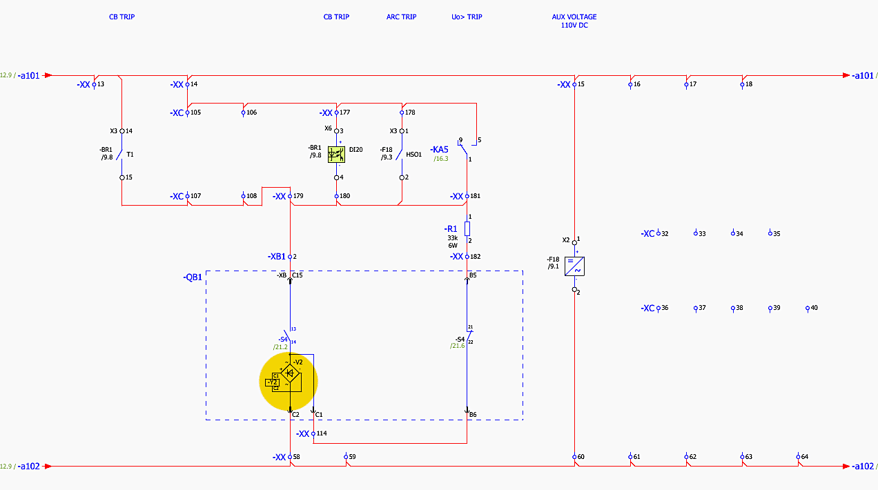

The Tripping Circuit =S01+C01&EFS/13 is intentionally designed for maximum redundancy and failsafe operation. The primary shunt tripping coil is identified as -Y2. Unlike the closing circuit, which has many permissive constraints in series, the tripping circuit utilizes multiple parallel pathways to ensure that any critical protection function can immediately dump 110V DC into the -Y2 coil.
As seen on the schematic, the trip signal from the main REM5438M protection relay enters the circuit.
Parallel to this are specialized, high-speed trip routes. For instance, the ‘ARC TRIP’ signal (originating from the REA 101 / VAMP 255 arc protection system) has a direct, hardwired path to the trip coil, bypassing all non-essential logic to guarantee the absolute minimum clearing time.
Figure 10 – Tripping Circuits
Tripping Circuits
Similarly, the ‘Uo TRIP’ (zero-sequence voltage trip for ungrounded or impedance-grounded earth faults) commands immediate opening.
Furthermore, the tripping circuit features continuous coil supervision. A small trickle current passes through the Y2 trip coil via a supervision relay or the digital input of the REM5438M. If the internal wire of the trip coil breaks, or if the 110V DC tripping voltage is lost, this trickle current is interrupted.
The system instantly recognizes this as a critical failure and raises a ‘Trip Circuit Supervision‘ alarm, alerting operators that the breaker is functionally paralyzed.

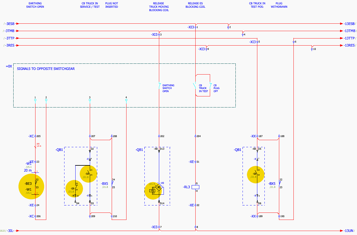

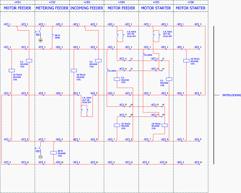

5. Tripping Interlocking and Safety Mechanisms
Interlocking is the cornerstone of switchgear safety, designed to physically and electrically prevent operators from performing sequences that would result in fatal arc flashes or equipment destruction. The interlocking logic for the 10kV MCC is extensively detailed on sheets =S01+C01&EFS/14 and =S01+C01&EFS/15.
The most critical mechanical and electrical interlock exists between the VD4 Circuit Breaker truck position and the EK6 Earthing Switch -QE1.
The logic explicitly dictates that the Earthing Switch can only be closed if the Circuit Breaker truck is completely racked out into the ‘Test/Disconnected’ position.
On the schematic =S01+C01&EFS/14, this is governed by the ‘CB Truck in Test Pos’ contacts. The earthing switch mechanism contains an electrical blocking coil -Y0. If the VD4 breaker is in the ‘Service’ position, the 110V DC supply to the earthing switch blocking coil is interrupted by the breaker’s position auxiliary contacts (-S8, -S9).
The blocking coil remains de-energized, keeping a physical locking pin engaged in the earthing switch drive mechanism, making it physically impossible for an operator to insert the operating handle and close the earth switch onto live busbars.
Figure 11 – Interlocking Circuits
Conversely, the Circuit Breaker cannot be racked from the ‘Test’ position into the ‘Service’ position if the Earthing Switch is closed.
The drawing shows the ‘Earthing Switch Open’ signal routing through auxiliary contacts (-BE2, -BE3) located on the EK6 switch shaft. Only when the earthing switch is fully open do these contacts close, completing the circuit to energize the ‘Release Truck Moving Blocking Coil’ (often a locking magnet on the breaker truck chassis).
If the earthing switch is closed, the magnet remains locked, preventing the lead screw from turning and blocking the breaker from being racked into the live busbars and creating a dead short to ground.
Additional interlocking involves the secondary control plug. The ‘Plug Not Inserted’ logic ensures that the breaker cannot be operated electrically if the multi-pin control umbilical is disconnected.
Auxiliary contacts (like -BX5) monitor the physical insertion of this plug. Furthermore, ‘Signals to Opposite Switchgear’ denote cross-panel interlocking, ensuring that in complex transfer schemes (like a main-tie-main arrangement), breakers coordinate their states to prevent out-of-phase paralleling or connecting disparate sources.
Figure 12 – Interlocking Circuits

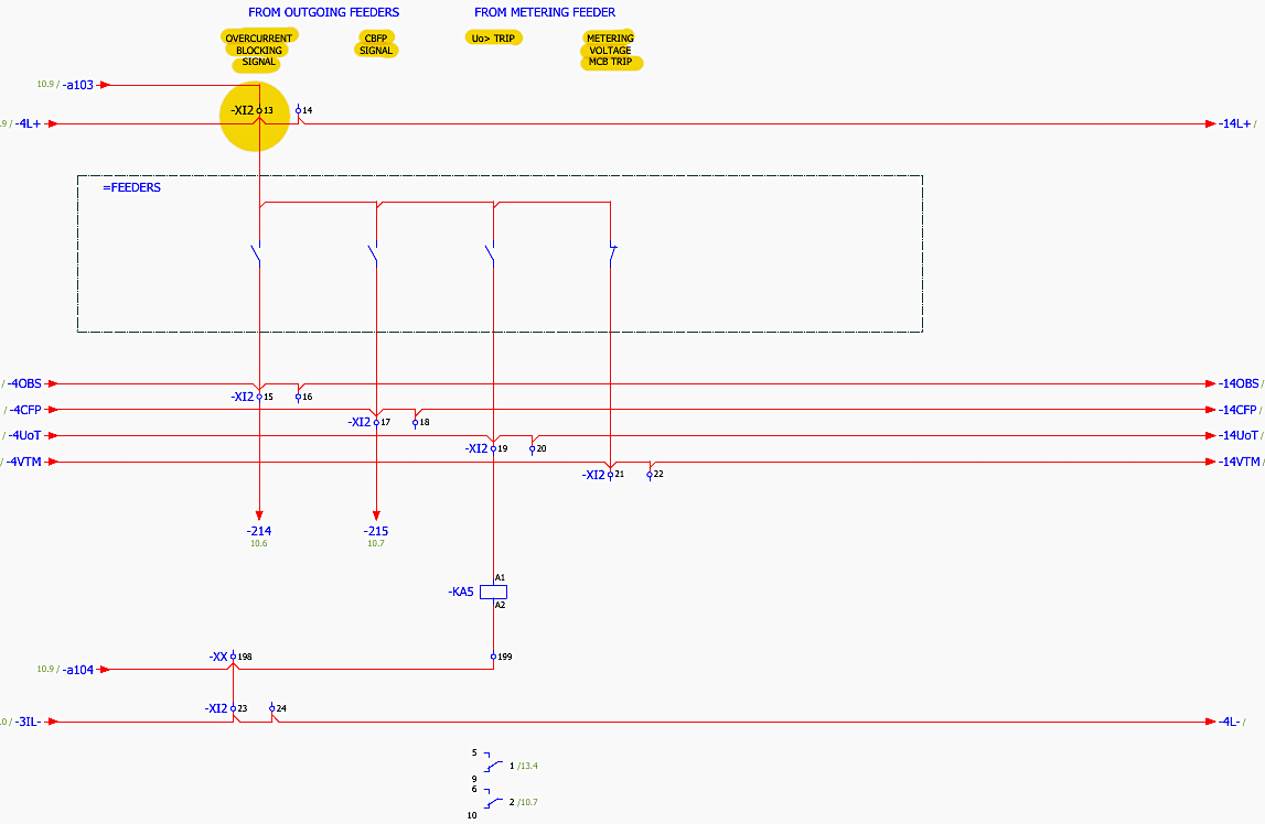

6. Blocking and Alarm Signals

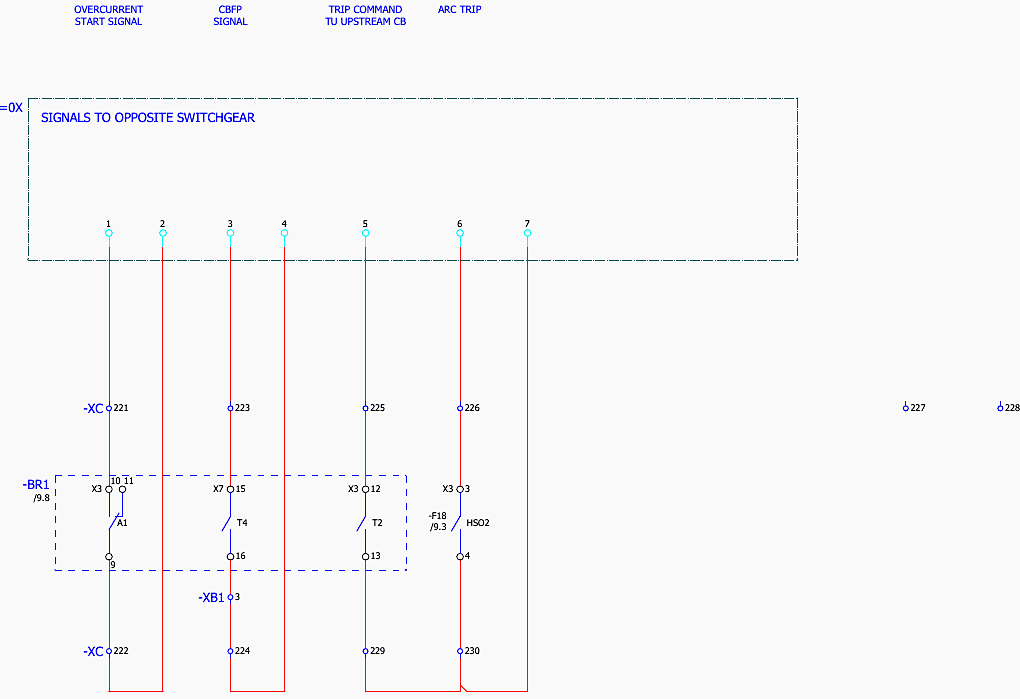

Situational awareness and protection coordination are managed by a complex array of blocking and alarm signals, meticulously mapped on sheets =S01+C01&EFS/16 (Blocking Signals) and =S01+C01&EFS/17 (Alarm Signals).
Blocking signals (=S01+C01&EFS/16) are fast-acting logic commands used to enforce protection selectivity. A prime example shown in the drawings is the ‘Overcurrent Blocking Signal’.
In a radial distribution network, a fault on an outgoing motor feeder will be detected by both the feeder’s protection relay and the upstream incoming feeder’s protection relay. To prevent the incoming breaker from tripping and shutting down the entire MCC, the outgoing feeder relay instantly sends an Overcurrent Blocking Signal via terminal -XI2 (pins 13/14) to the upstream relay.
This signal temporarily freezes the upstream relay’s fast overcurrent element, allowing the localized feeder breaker to clear the fault.
Figure 13 – Blocking Signals
Blocking Signals
Another critical block is the ‘CBFP Signal’ (Circuit Breaker Failure Protection). If a relay issues a trip command but detects that the fault current is still flowing after a predefined time delay (indicating the VD4 breaker mechanically failed to open), it generates a CBFP signal. This signal is routed to upstream breakers, commanding them to trip immediately to clear the uncleared fault, overriding normal time-delay coordination.

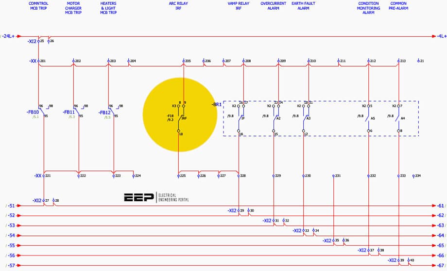

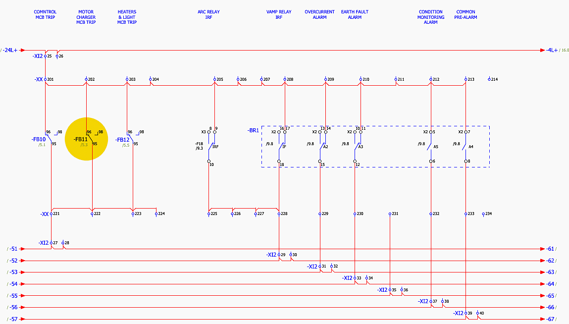

Alarm Signals (=S01+C01&EFS/17) provide operators with non-critical but vital diagnostic information. These signals are typically aggregated and sent to a centralized SCADA system. The schematic outlines several distinct alarm paths.
The ‘Control MCB Trip’ (-XI2 pins 25/26), ‘Motor Charger MCB Trip’, and ‘Heaters & Light MCB Trip’ alarms are generated by auxiliary contacts physically attached to the respective Siemens MCBs (-FB10, -FB11, -FB12). If any of these breakers trip due to an internal low-voltage short circuit, the contact closes, sending an alarm.
This allows maintenance to identify a dead control circuit before attempting to operate the switchgear.
Figure 14 – Alarm Signals
Alarm Signals
More severe alarms include the ‘Arc Relay IRF’ (Internal Relay Failure) and ‘VAMP Relay IRF’. Modern digital relays continuously run self-diagnostic routines on their CPU, memory, and A/D converters. If a hardware or software fault is detected internally, the relay drops out a dedicated IRF watchdog contact.
This immediately alarms the SCADA system that the specific panel is currently operating without protection, necessitating urgent intervention.
Additional alarms routed through the -XI2 terminal block include the ‘Overcurrent Alarm’ (a pre-trip warning that load is approaching the trip threshold), ‘Earth Fault Alarm’, and generalized ‘Condition Monitoring Alarm’ which could tie into SF6 gas pressure monitors (if applicable) or breaker wear algorithms computed by the REM5438M.

The physical realization of the schematic logic is achieved through the interconnection terminal blocks, primarily designated as: -XI1, -XI2, -XI3, -XI4, and -XI5. These blocks, detailed on sheets =S01&EFS/5 through =S01&EFS/13, act as the neural synapses of the switchgear, allowing cross-panel communication and external SCADA interfacing.
Terminal Block -XI1 serves as the primary conduit for auxiliary power. As documented on sheet =S01&EFS/5, this block distributes the lifeblood of the control system. Pins 1 and 2 carry the main 110V DC Control Circuit positive and negative rails, branching off to supply the protection relays and logic loops.
Pins 3 and 4 are dedicated strictly to the 110V DC Motor Charger Circuit, isolating the motor current from the clean relay supply.
Pins 5 and 6 provide the 230V AC supply for the panel’s anti-condensation space heaters, ensuring the internal environment remains optimal. Pins 7 and 8 provide the secondary 230V AC supply specifically designated for the MV Motor Heater Circuits, which run out to the field to keep the 10kV stator windings dry.
Figure 15 – Interconnection Terminal -XI1
Terminal Block -XI2 is a densely populated block dedicated primarily to analog measurements, blocking logistics, and critical alarms.
Sheet =S01&EFS/6 reveals that pins 1 through 12 are allocated to the Metering Voltage circuits. These carry the scaled-down AC voltages from the TJP 4.0 VTs (phases L1, L2, L3, N, and the open-delta da-dn configurations used for zero-sequence voltage polarization).
This allows external utility meters or specialized power quality analyzers to tap into the busbar voltage. Moving down the block, pins 13/14 handle the aforementioned Overcurrent Blocking Signal.
Pins 15/16 interface with the VAMP Arc Protection system. Pins 17/18 carry the CBFP Tripping Signal, a vital last-resort command. Pins 19 through 24 route the Uo> Tripping Signal and the Metering Voltage MCB Trip Signal. The remainder of -XI2 (pins 25 through 48) forms the comprehensive alarm bus.
This includes dedicated pin pairs for MCB Trips, IRF (Internal Relay Failure) contacts for both the main protection and arc relays, Overcurrent Alarms, Earth Fault Alarms, External Trip Alarms, Condition Monitoring, and Overload Pre-alarms. Each pair represents a dry, potential-free contact that closes to signal an event to the substation RTU.
Terminal Block -XI3 handles the heavy mechanical interlocking logic. Sheet =S01&EFS/9 details these connections.
Pins 1/2 route the status of the Circuit Breaker Rack Out or Plug Off condition. Pins 3/4 and 11/12/13/14 are deeply integrated into the Earthing Switch (E.S.) Release Coil and the CB Truck Release Coil.
Figure 16 – Interconnection Terminal -XI3
By routing these signals through -XI3, the panel allows for complex, multi-panel interlocking schemes. For example, a bus-tie breaker can physically block the earthing switch of a feeder panel from closing via connections through -XI3, ensuring absolute topological safety across the entire lineup.

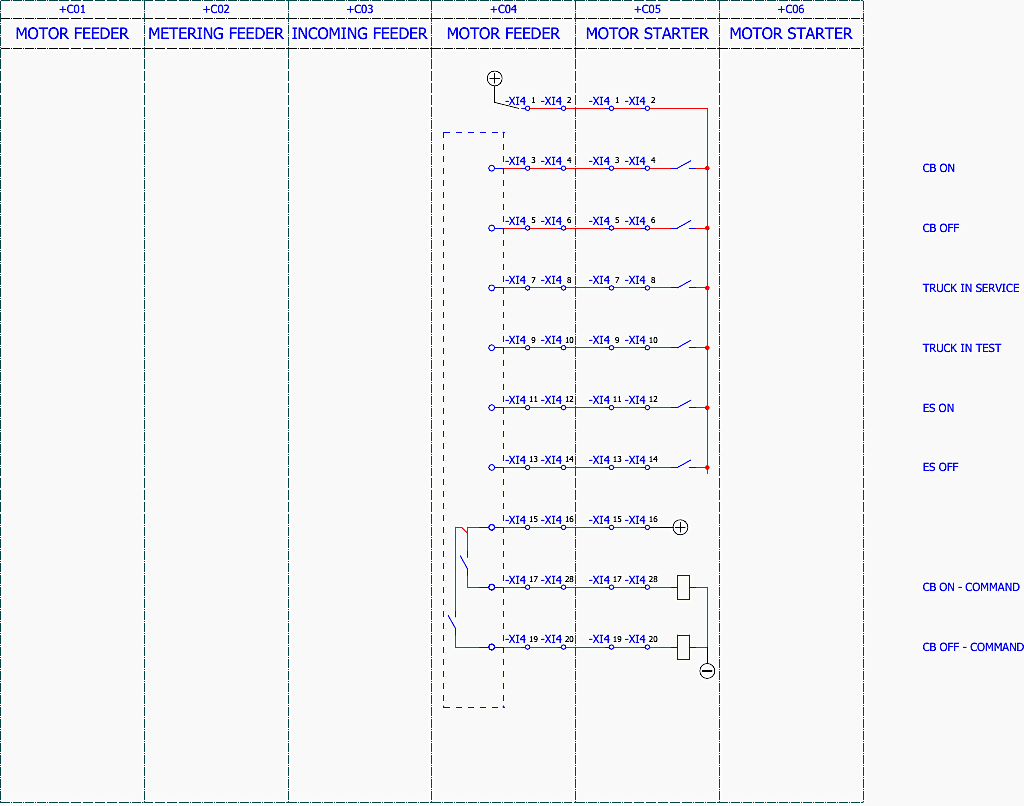

Terminal Block -XI4 provides the macro-level operational status of the switchgear components. Sheet =S01&EFS/10 maps these points:
  • Pins 1/2 report ‘CB ON’ (Main contacts closed), while pins 5/6 report ‘CB OFF’.
  • Pins 9/10 indicate the ‘Truck in Service’ position, verifying the breaker is physically connected to the high voltage bus.
  • Pins 11/12, 13/14 indicate ‘Truck in Test’, ‘ES ON’ (Earthing switch closed), and ‘ES OFF’.
  • Pins 15/16 and 19/20 provide the external connection points for remote SCADA ‘CB ON-COMMAND’ and ‘CB OFF-COMMAND’. By applying 110V DC across these specific pins, a remote operator miles away can trigger the closing or tripping coils described earlier in section 5.
  • Further down the block, pins 41-48 monitor the status of the metering truck,
  • while pins 55-68 monitor specialized alarms like ‘CB Spring Discharged’ (meaning the breaker cannot perform a close-open-close cycle), ‘CB Mechanical Failure’, and ‘Autotrafo Buchholz Alarm’ (for panels equipped with liquid.

The translation of physical switchgear states into digital logic is accomplished through the Binary Inputs of the protection relays. The detailed mapping of these inputs is located on sheets =S01+C01&EFS/10 and =S01+C01&EFS/11.
The protection relay (e.g., REM5438M) acts as the brain of the panel, but it requires ‘eyes’ to see the state of the breaker. This is achieved by wiring the auxiliary contacts of the VD4 breaker, the EK6 earthing switch, and various MCBs directly into the digital input cards of the relay.
The schematic labels these inputs as DI1 through DI18.
A systematic review of the drawing shows the exact assignments. DI1 is assigned to ‘CB IN TEST POSITION’. When the breaker is racked out, a microswitch closes, applying 110V DC to DI1. The relay’s software now registers the breaker is in test mode, which automatically alters the relay’s behavior, it may disable specific trip outputs or enable logic testing algorithms.
Figure 17 – Binary Inputs of Protection Relay
DI2 monitors the ‘CB IN SERVICE POSITION’. It is a critical safety parameter that DI1 and DI2 should never be active simultaneously; if they are, the relay software will flag a discrepancy error.
The actual open/closed status of the primary contacts is read via DI3 (‘CB OPEN’) and DI4 (‘CB CLOSED’). This provides the relay with positive feedback. If the relay issues a trip command via its output contacts to the -Y2 coil, it immediately starts a timer. It expects to see DI4 drop low and DI3 go high within approximately 50 milliseconds.
If this transition does not occur, the relay software confirms a mechanical breaker failure and instantly triggers the CBFP (Circuit Breaker Failure Protection) logic discussed in the blocking signals section.
The safety topology is further reinforced by DI5 (‘EARTHING SWITCH OPEN’) and DI6 (‘EARTHING SWITCH CLOSED’). The relay uses these inputs to inhibit motor starting logic. It is impossible for the relay to issue a remote close command to the motor if DI6 is true. DI7 reads the ‘CB SPRING DISCHARGED’ status.

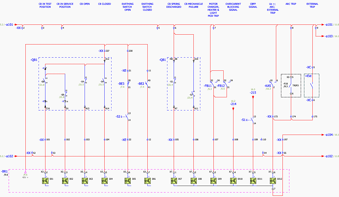

Figure 18 – Binary inputs scheme
The VD4 mechanism relies on a heavily tensioned mechanical spring to snap the vacuum interrupters open and closed. If the charging motor fails, the spring will eventually discharge. DI7 warns the relay that the breaker lacks the stored mechanical energy required for operation.
More complex fault scenarios are monitored via the higher-numbered digital inputs.
DI9 monitors the ‘MOTOR CHARGER, HEATER & LIGHT MCB TRIP’. DI10 receives the ‘OVERCURRENT BLOCKING SIGNAL’ from downstream devices. When DI10 goes high, the relay dynamically adjusts its internal overcurrent time-delay curves to allow the downstream breaker time to clear the fault.
DI11 receives incoming ‘CBFP SIGNALS’ from other panels. Finally, DI12 is an aggregate input for ‘Uo >; ARC; EXTERNAL TRIP’, acting as a master external kill switch that bypasses normal software delays.

Panel naming does not agree between sheets. The structure identifier overview (&EAC/7, PDF 6) defines +C01 and +C02 as motor starter, +C03 motor feeder, +C04 incoming feeder, +C05 measuring panel, +C06 motor feeder. The total overview (PDF 11) agrees.
The column headings on all the interconnection sheets (PDF 12 to 20) instead read +C01 MOTOR FEEDER, +C02 METERING FEEDER, +C03 INCOMING FEEDER, +C04 MOTOR FEEDER, +C05 and +C06 MOTOR STARTER. The two conventions cannot both be right!?
Verification #2
The incoming feeder does not appear on the overview. The total overview single line (PDF 11) shows only five fields: +C06, +C05, +C03, +C02 and +C01. Location +C04, for which a complete schematic set exists (PDF 40 to 58), has no single-line field.

Two different CT types are specified for the same location. ASS24 400/1/1 A on the +C01 single line (PDF 21) versus TPU43.13+CD 1200/1/1 A on the overview (PDF 11, column 9).
Verification #4
Two different breaker types are named. The single lines specify VD4 24.12.25, 1250 A; the circuit breaker overview (PDF 38, title block area) is drawn for TYPE VM1.

Cubicle widths differ between drawings. The front view (PDF 8) dimensions the five cubicles as 800/640/650/800/650 mm; the foundation frame (PDF 10) shows five bays of 650 mm and a table entry FT = 650 mm.

Terminal numbering anomalies. On PDF 17 and 20 the CB ON – COMMAND pair is numbered -XI4:17 / -XI4:28 and -XI4:37 / -XI4:38 respectively, so the first sheet appears to use 28 where 18 would be expected.
On PDF 12 the spare pair in the -XI1 group is labelled -XI1:1 and -XI1:10, duplicating terminal 1.

11.1 The Vacuum Circuit Breaker
The Vacuum Circuit Breaker (VD4 24.12.25 1250A) in the Context of IEC 62271-100
The ABB VD4 breaker specified in panels +C01, +C03, +C04, and +C06 is not merely a mechanical switch; it is a complex kinetic energy storage device and plasma suppression system. When the -Y2 shunt trip coil is energized by the protection relay (as traced through sheet =S01+C01&EFS/13), it unlatches a mechanical sear.
The large stored energy of the primary opening spring is released, driving the moving contact away from the fixed contact inside the vacuum interrupter bottle. Because this occurs in a vacuum (typically 10-7 mbar or lower), there are no gas molecules to ionize. As the contacts separate, the immense heat vaporizes a microscopic amount of the metal contact material itself, creating a metal vapor arc plasma.
This plasma is highly conductive and allows the fault current to continue flowing momentarily.
Video Lesson – Circuit Breaker (52)
However, vacuum interrupters utilize specialized contact geometries, such as transverse magnetic field (TMF) or axial magnetic field (AMF) designs.
The current flowing through the contacts generates a powerful magnetic field that forces the arc plasma to spin rapidly around the perimeter of the contact surface. This spinning prevents localized overheating and gross melting of the copper-chromium contact material.
As the alternating current approaches its natural zero-crossing point, the energy sustaining the plasma drops to zero.
The metal vapor instantly condenses back onto the contacts and the surrounding vapor shield. Within microseconds, the dielectric strength of the gap recovers to its full potential, capable of withstanding the Transient Recovery Voltage (TRV) of the 10kV system without re-striking. This entire process occurs in roughly 30 to 50 milliseconds from the moment the relay issues the trip command.
The rigorous testing dictated by IEC 62271-100 ensures that the VD4 can perform this fault-clearing operation repeatedly without degrading its nominal 1250A continuous current carrying capacity.

11.3 Optical Arc Fault Protection
Optical Arc Fault Protection Physics (VAMP 255 / REA 101)
Traditional overcurrent protection relies on detecting an increase in current. However, an internal arc fault within the metal-clad switchgear presents a unique challenge. An arc fault is a highly chaotic, resistive plasma discharge. The resistance of the arc itself limits the fault current.
In many cases, the fault current of a devastating internal arc flash may be lower than the starting inrush current of a large 10kV motor.
Therefore, traditional time-delayed overcurrent protection cannot clear an arc fault quickly enough to prevent catastrophic pressure buildup and the vaporization of the copper busbars. The VAMP 255 and REA 101 systems solve this by utilizing a completely different physical principle: the detection of photons.
An electric arc generates intense light across the visible and ultraviolet spectrum.
Optical sensors (lens or bare fiber optics) are routed throughout the busbar, circuit breaker, and cable compartments. These sensors are continuously monitored by the arc protection relay. Because camera flashes or sunlight could cause false tripping, the relay employs a dual-verification condition.
Figure 19 – Optical Arc Fault Protection
It simultaneously monitors the current transformers for an abrupt step-change in current. If the relay detects a large flash of light AND a sudden surge in current simultaneously, it bypasses all software delays and fires a dedicated, high-speed insulated gate bipolar transistor (IGBT) output contact directly into the -Y2 trip coil circuit (as seen on sheet =S01+C01&EFS/13).
This drops the total clearing time to less than 2 milliseconds for the relay logic, limited only by the mechanical opening time of the VD4 breaker itself. This ultra-fast operation limits the incident energy of the arc, protecting personnel and preventing the switchgear from blowing apart from the internal pressure wave.

11.4 The Criticality of the EK6 Earthing Switch Making Capacity
The interlocking logic discussed in Section 5 prevents the EK6 earthing switch from closing when the breaker is in the service position. However, human error or complex induced voltages from adjacent parallel lines can still create dangerous scenarios.
If a maintenance worker closes the EK6 earthing switch onto a line that is still energized from a remote source, the resulting short-circuit current will immediately jump to the switchgear ground bus. An ordinary disconnect switch would be  blown open by the immense electromagnetic repulsion forces generated by the fault current, drawing an unconfined arc that would likely be fatal to the operator holding the handle.
The EK6 is specifically engineered as a ‘make-proof’ earthing switch. Its mechanical drive utilizes a powerful spring mechanism that drives the grounding blades into the stationary contacts with overwhelming force. The contact geometry is designed such that the electromagnetic forces actually pull the contacts tighter together (blow-on effect) rather than pushing them apart.
This allows the EK6 to safely conduct the full 25kA short-circuit current for 1 second, maintaining mechanical integrity and containing the fault until upstream protection clears it. The operator is shielded by the earthed metal enclosure, and the switch itself survives the event, albeit requiring inspection before re-use.
