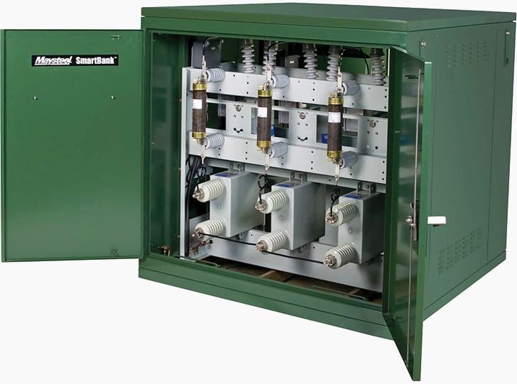

5. Distribution capacitor banks
Distribution capacitors are installed close to the load, on the poles, or at the substations. Although these capacitor units provide reactive power support to local load, they may not help reduce the feeder and transformer losses.
Low voltage capacitor units are cheaper than high voltage capacitor banks. Protecting distribution capacitor banks from all types of fault conditions is difficult.
Sometimes pad-mounted installations are used for low or medium voltage distribution capacitors. A typical pad-mounted capacitor bank is shown in Figure 5. Although the pad-mounted capacitors are outdoor installations, they are protected by metal enclosures from outdoor environment and are similar to pad-mounted transformer installations.
Pad-mounted capacitor banks are usually available in ratings of 15-25kV.
Pad-mounted capacitor banks have broad applicability through out the industry, including non-utility facilities. The capacitors are installed to boost the voltage back within the operating tolerance of the system and, thereby, provide voltage stability.
A pad-mounted three-phase capacitor bank
Figure 5 – A pad-mounted three-phase capacitor bank (photo credit: Switchgear Power Systems – SPS)
