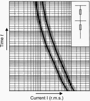

Selectivity between fuses connected in series
Fuses connected in series act selectively if their time current-characteristic curves have sufficient mutual spacing and their tolerance bands do not touch (Figure 1).
Figure 1 – Selectivity between fuses connected in series
At high short-circuit currents the melting I2t value of the upstream fuse must be larger than the  breaking I2t value (melting and clearing time) of the smaller downstream fuse. This is usually the case if their rated currents differ by a factor of 1.6 or more.

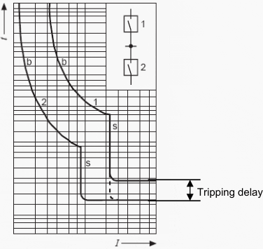

Time selectivity
If current selectivity between circuit breakers is not possible, selectivity must be achieved by cascading of the trip times, i.e. the upstream circuit breaker operates with a short delay to give the downstream circuit breaker time to clear the short-circuit.
If the short-circuit occurs between the two switches, then it will continue during the short trip delay time of the switch 1 and after lapse of this time it will be switched off by the latter (Figure 3).
Time selectivity of two circuit breakers in series
Figure 3 – Time selectivity of two circuit breakers in series
b = Overload release
s = Short-circuit release (switch 1 with short-time delay; utilization category B)
The cascading of trip times requires that Switch 1 is capable of carrying the short-circuit current during the trip delay time. This is the case when using circuit breakers of utilization category B.
The critical variable is the rated short-time current Icw that determines the magnitude of the permissible short-time current during a defined period. It is usually stated as the 1s – current and can be converted for other times with I2t = const.

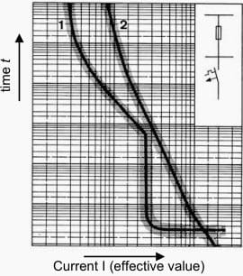

Selectivity between fuse and downstream circuit breaker
Figure 4 – Selectivity between fuse and downstream circuit breaker
1 = Circuit breaker
2 = Fuse
In the overload range selectivity is given, if the trip characteristic of the overload release lies under the characteristic curve of the fuse (considering the tolerance band). In the short-circuit range selectivity is given to the extent that the total breaking time (including clearing time) of the circuit breaker is below the melting characteristic of the fuse.
