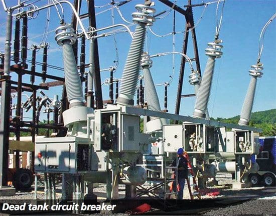

Circuit-breakers of the ‘dead tank’ type have interrupters housed in an earthed metal enclosure and either form part of a GIS substation or their connections are taken out through bushings. In this arrangement the bushings may be used to house the current transformer secondary windings.
“Dead tank” circuit-breakers are seldom used in Europe and are more popular in the USA and Japan.
Any circuit-breaker drive most be fitted with an energy storage device which permits a complete standard sequence of operation without further input of energy.
Figure 4 – Dead-tank circuit breaker
