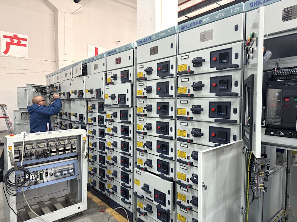

Figure 2 – FAT of newly manufactured 0.4kV withdrawable switchgear
FAT of newly manufactured low-voltage 0.4kV withdrawable switchgear
Figure 2 – FAT of newly manufactured low-voltage 0.4kV withdrawable switchgear (photo credit: Jane Qiu via Linkedin)

Factory Acceptance Tests are conducted at the manufacturing facility to ensure compliance with specified specifications, hence producing high-quality products. The tests are typically conducted with the customer and, in more rigorous circumstances, with a third-party inspection agency.
While all electrical panels are expected to be fault-free upon arrival from the subcontractors responsible for their assembly, defects may occasionally arise. Consequently, these manufacturing acceptance tests are essential.
During a FAT, all installations and wirings are verified to ensure they conform to the project-specific drawings. Functions intended to operate upon panel installation at the site are also simulated to verify automated capability. All potential problems, deviations, and requests are duly recorded.
