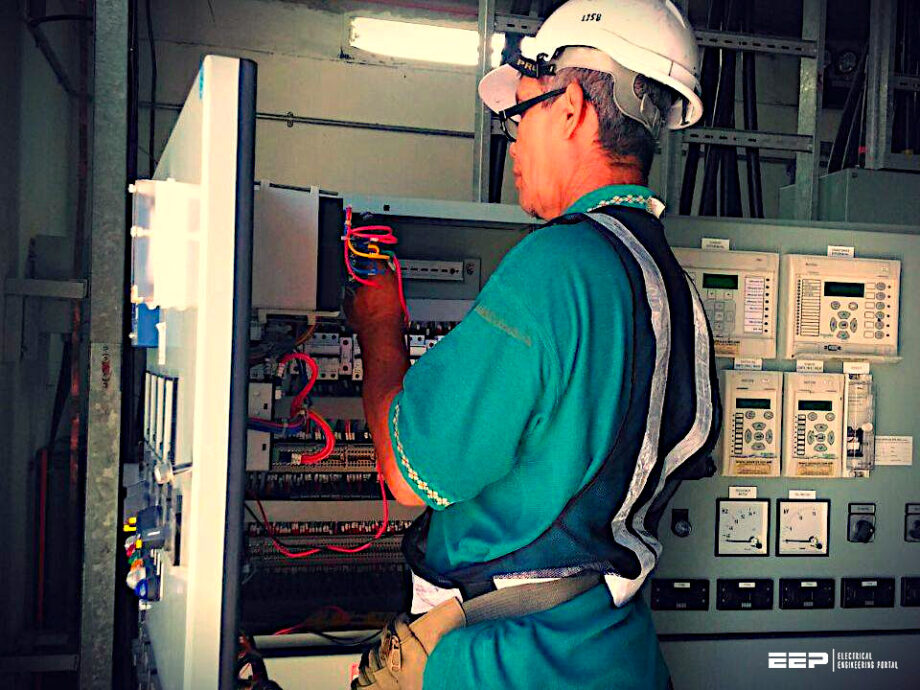

Changing Substation Maintenance Philosophy
This article explores the complete spectrum of substation maintenance philosophies from Corrective and Preventive Maintenance to Predictive, Condition-Based, and ultimately Risk-Based Maintenance (RBM). It explains how each approach evolved, where it fits within modern substations, and how utilities can transition toward data-driven and risk-informed asset management models.
Substation Maintenance Transition Toward Clever Data-driven Asset Management
Substation Maintenance Transition Toward Clever Data-driven Asset Management (photo credit: Warna RS Sdn. Bhd.)
Particular focus is given to EHV substations, where asset failure consequences are severe impacting grid stability, public safety, regulatory KPIs (SAIDI/SAIFI), and financial performance.
The article also examines Asset Criticality Ranking, a foundational element in implementing effective RBM frameworks aligned with ISO 55000 asset management principles.
Through practical examples, implementation strategies, and lessons learned from real-world environments, this guide aims to provide engineers, asset managers, and utility leaders with a structured understanding of how maintenance philosophy shapes grid reliability and how to move toward intelligent, risk-optimized asset management in modern power systems.
In modern power systems, substations are not merely switching points, they are strategic reliability hubs that determine the stability, safety, and availability of the entire grid.
Whether operating at distribution level or at EHV and HVDC transmission voltages, the maintenance philosophy adopted for substation assets directly influences system resilience, operational expenditure, and long-term asset health.
Historically, utilities relied heavily on reactive maintenance, addressing failures after they occurred. While this approach may have been acceptable in less complex networks, today’s interconnected grids, renewable integration, high fault levels, and regulatory performance targets demand a far more structured and intelligent maintenance strategy.
