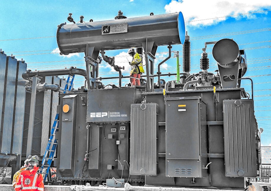

This article will try to shed some light on the most common noise-related concerns associated with existing substations and provide mitigation methods to address these concerns. The continuous noise created by the operation of power transformers and reactors, as well as the noise produced by the operation of high-voltage circuit breakers or load interrupters, are the two main sources of noise in substations.
The limit of the substation noise level over which it begins to irritate the community
The limit of the substation noise level over which it begins to irritate the community (Photo credit: Grej Jones via Linkedin)
Other noise sources in substations worth mentioning are corona discharges (buzzing), arcing during the operation of switches, etc. Power transformers and reactors generate the most important and the most significant noise. Continuous humming noise these equipment generate is very often disturbing for communities living near the substation.
Existing substations are often equipped with older, vintage power transformers and reactors. The technology used to manufacture such equipment typically results in relatively high levels of noise emission. Most of the existing substations were initially built far from residential areas to limit the effect of this noise on the public and the surrounding neighbourhoods.
However, back in earlier years, there were fewer guidelines and regulations regarding acceptable noise levels available during the construction of substations. In the last couple of decades, the expansion of urban and suburban areas has resulted in many substations being located within or in direct proximity to residential areas.
In these new situations, the noise level generated by the equipment in the substation might not be acceptable, and corrective measures are often required to reduce the noise level to acceptable levels.
Furthermore, throughout the last few decades, public concern about industrial noise has grown, and new, more strict regulations and bylaws have been enacted to control noise levels in residential areas.
All these occurrences highlight the importance of audible noise as a problem, one that the utility industry must address fully during the planning and retrofitting of existing substations.
