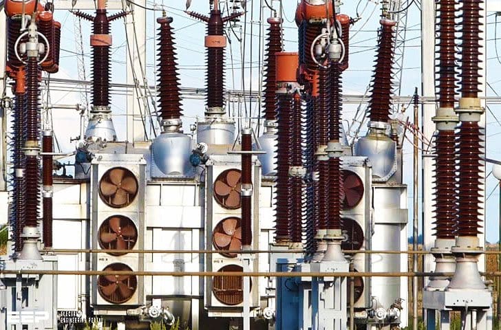

The substation ownership demarcation between the utility and the plant is very important and should be determined carefully. Specific ownership of the substation and associated equipment may be a complicated issue that may be determined by a number of conditions and factors.
Substation ownership demarcation between the utility and the plant (considerations & issues)
The chief considerations are the rate structure and operating philosophy of the utility, the operating philosophy and return on capital of the plant owner, and the particular situation that may determine such policies. Once all these factors are considered, ownership and lines of demarcation can be determined.
The ownership point may vary for utility-owned substations. The transformer low-voltage bushings or low-voltage terminations at the plant’s switchhouse are typical points of owner- ship demarcation.

Insurance coverage is commonly provided by the plant and the utility for their respective facilities as part of their normal course of doing business. If plant substation ownership is involved, the plant management must include insurance for the facility.
In the case where underground duct systems are involved, ownership can change at a man-hole on either side of the plant’s property line. Splices inside the manhole may or may not be the utility’s responsibility. The cable and ducts connecting to the substation may or may not be the customer’s responsibility, generally depending upon the voltage level.
Cable termination at the substation may or may not be the plant’s responsibility. The delivery voltage level may also determine the point of ownership change.
The ownership point issue may also vary for customer-owned substations. In this case, possible change of ownership may be at a termination of utility services at towers near the plant’s property line, at the plant’s substation property line, or at the high voltage terminations in the plant’s substation yard at either the high voltage breakers or the transformer high voltage bushings.
Since the high voltage protective devices in the yard may be an integral part of the utility’s transmission system, utilities may often retain ownership and control of this equipment.
In this case, the ownership point may be at the transformer high voltage bushings. In some cases, partitions in the substation yard may be required to separate areas of ownership for security and safety reasons.
