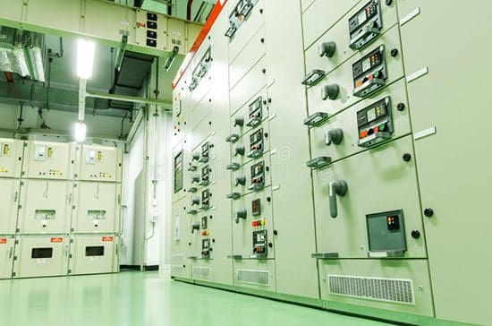

2.1.6. Industrial substations
Those substations which supply power to individual industrial concerns are known as industrial substations.
Figure 4 – Industrial substation, LV and switchgears displayed
