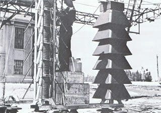

Lightning arrestors being installed at Kingston sub-station in 1928. Photo: ACTEA.
