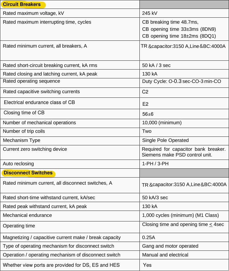

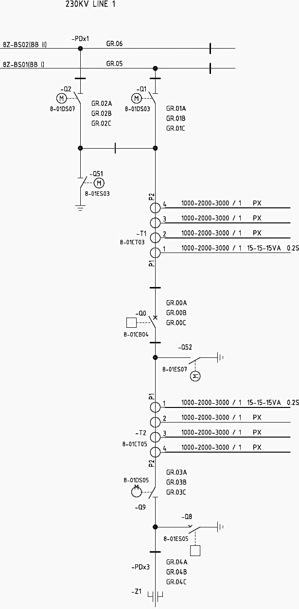

1.1 Circuit Breakers
The installation employs specific circuit breaker variants depending on the functional bay. Breakers assigned to the transformer and capacitor bank feeders possess a rated minimum continuous current of 3150A.
In contrast, the line and bus coupler circuit breakers are rated for 4000A.
The breakers demonstrate an electrical endurance class of E2 and a mechanical endurance exceeding 10,000 operations. The rated operating sequence is standardized at O-0.3sec-CO-3min-CO. The actuation mechanism is single-pole operated and utilizes dual trip coils energized by a 125V DC auxiliary supply (+10%, -15%).
The 8DN9 breaker variants exhibit a breaking time of 48.7ms and an opening time of 33±3ms, whereas the 8DQ1 variant achieves an opening time of 18 ±2ms. The capacitor bank breakers are augmented with a Phase Synchronizing Device (PSD) to manage current zero switching and mitigate capacitive switching transients.
See pages 25 and 26.
Figure 1 – 8DN9 GIS swichgear feeder
8DN9 GIS swichgear breaker
1.2 Disconnect and Earthing Switches
The disconnect switches (DS) are motor-operated, facilitating both manual and electrical gang operation. They are rated for a mechanical endurance of 1,000 cycles (Class M1) and are capable of interrupting the charging current of the connected GIS bus.
The magnetizing and capacitive current make/break capacity is 0.25A. Standard earthing switches (ES) and high-speed grounding switches (HSGS) are rated for a minimum continuous current of 1250A and a short-time withstand of 50kA for 3 seconds.
The high-speed grounding switches possess an electrical endurance class of E1, capable of executing at least two full fault closing operations.
The spring charging time for the HSGS is 6 seconds, achieving closing and opening times of less than 60ms, compared to the standard grounding switch operation time of less than 4 seconds.
See pages 26 and 27.
Figure 2 – CBs, Disconnect and Earthing Switches Datasheets

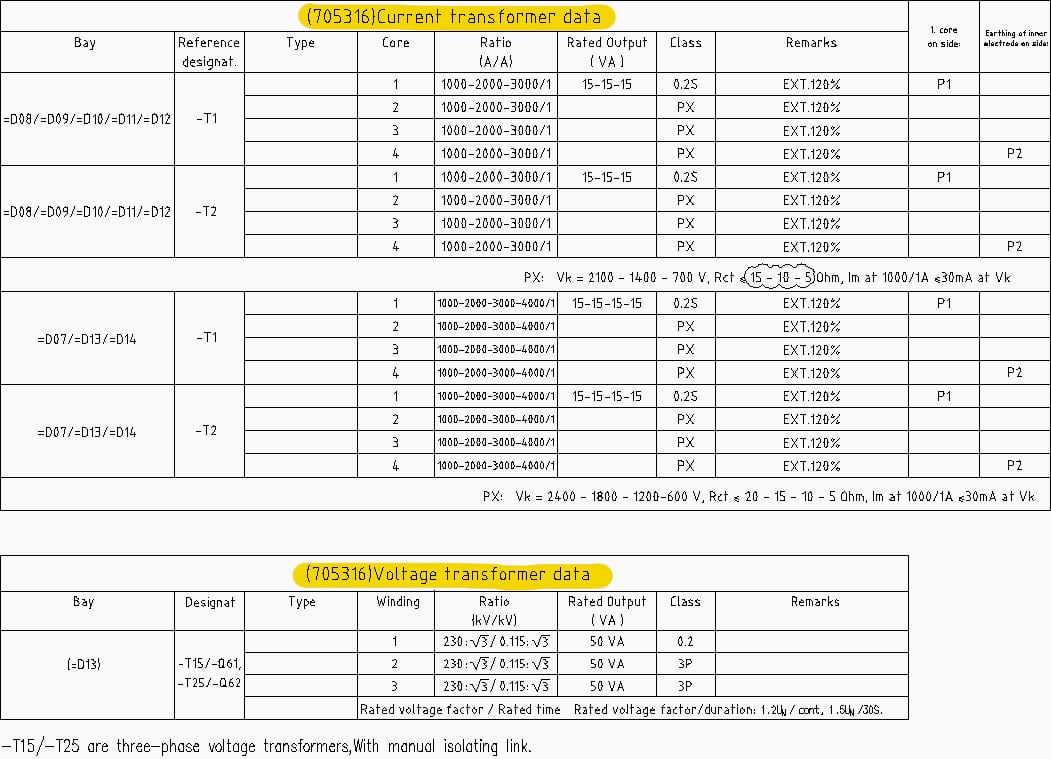

1.3 Instrument Transformers and Bushings
Voltage Transformers (VT) are SF6 gas-insulated, electromagnetic types designed for three-phase, phase-to-ground applications within an effectively grounded system. The VTs incorporate a disconnecting link to permit isolation during high-voltage AC testing, and exhibit a partial discharge value of ≤ 5 pC at 1.2Ur / √3.
The VTs step down the 230kV primary voltage to 115V or 115/√3V secondary potentials. The metering windings provide a 50VA output at an accuracy class of 0.2, while the protection windings deliver 50VA at a 3P accuracy class.
The VTs are rated for a continuous voltage factor of 1.2 and a short-duration factor of 1.5 for 30 seconds.
Current Transformers (CT) feature variable ratios to accommodate differing protection and metering requirements. The 230kV CTs are specified with ratios ranging from 1000-2000-3000/1 A up to 1000-2000-3000-4000/1 A.
Core 1 is designated for metering with an accuracy class of 0.2S and a rated output of 15VA, operating at an extended primary current factor of 120%. Protection cores (e.g., cores 2, 3, 4) are designated as Class PX, possessing specific knee-point voltages (Vk) and internal secondary resistances (Rct) tailored to prevent magnetic saturation during asymmetrical fault currents.
For example, the 4000/1 A ratio PX core exhibits a knee point voltage of 2400V and an internal resistance of 20 Ohms.
See page 34.
Figure 3 – Instrument transformers datasheet

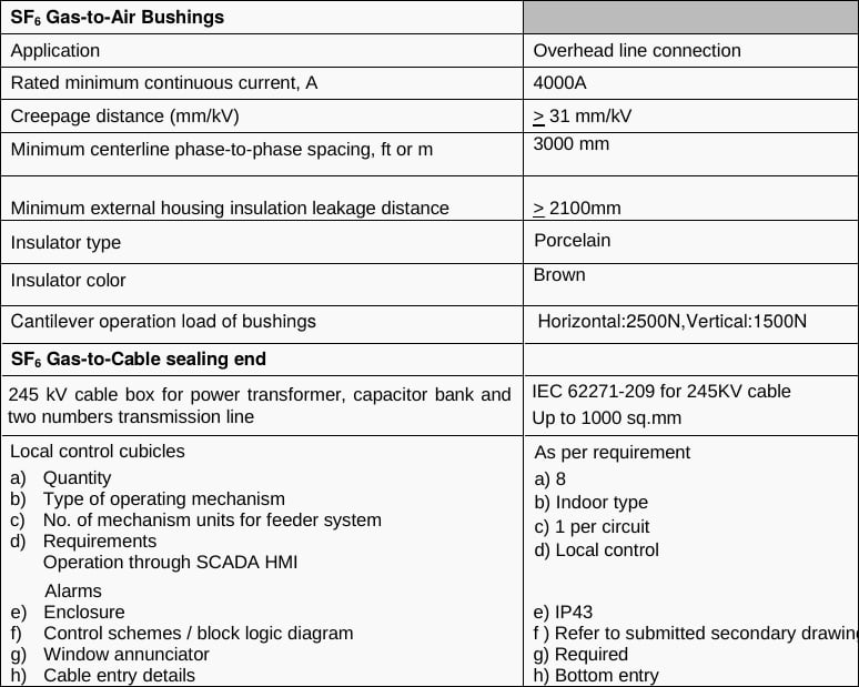

The SF6 gas-to-air bushings, utilized for overhead line interfaces, consist of brown porcelain insulators with a minimum centerline phase-to-phase spacing of 3000mm. These bushings support a 4000A continuous current and provide a creepage distance exceeding 31 mm/kV, resulting in an external housing insulation leakage distance greater than 2100mm.
The cantilever operational load is rated at 2500N horizontally and 1500N vertically.
Additionally, 245kV cable sealing ends comply with IEC 62271-209, accommodating cross-sections up to 1000 sq.mm for the power transformer, capacitor bank, and transmission lines.
See page 28.
Figure 4 – SF6-gas-to-air bushings datasheet
