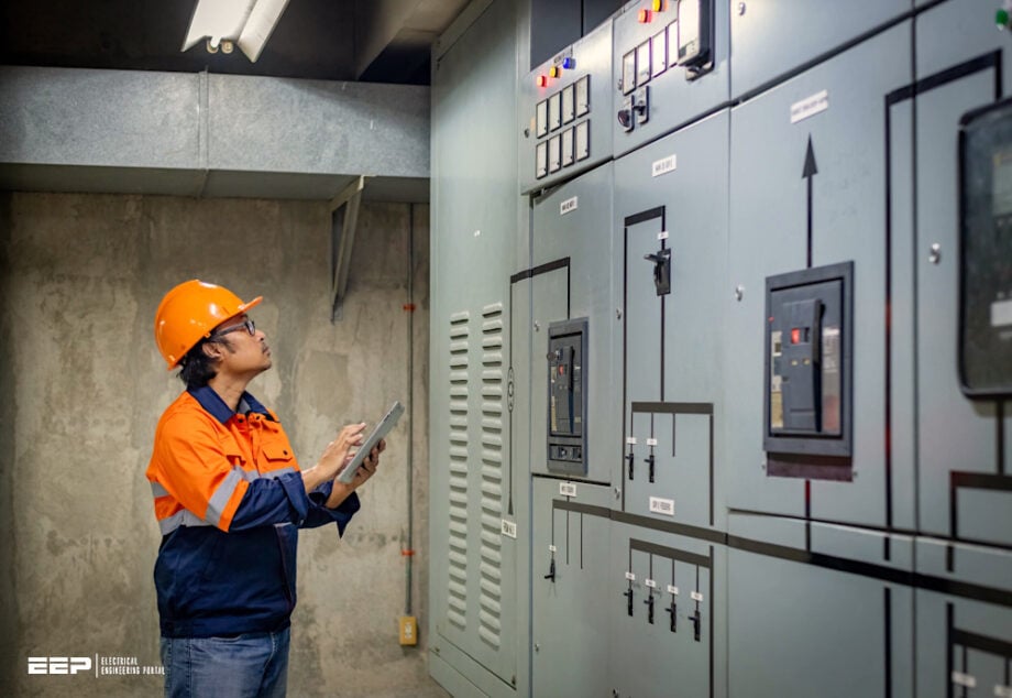

The Symphony of Impending Failure
Let ‘s talk about the acoustic diagnostics of low-voltage substations, focusing on the ten most dangerous acoustic emissions, their underlying physics, and diagnostic methodologies. In the realm of electrical distribution, low-voltage (LV) substations—typically operating at or below 1000V AC—form the critical nexus between medium-voltage distribution networks and end-user loads.
The Ten Most Dangerous Noises in a Low-Voltage Substation
While sophisticated supervisory control and data acquisition (SCADA) systems monitor voltage, current, and thermal telemetry, one of the most vital diagnostic metrics remains acoustic emission.
A substation is never truly silent; it operates with a baseline acoustic signature dictated by electromagnetic forces and fluid dynamics. However, deviations from this baseline—specifically anomalous sounds—serve as early-warning indicators of mechanical fatigue, dielectric breakdown, and impending catastrophic failure.
This article analyzes the ten most dangerous noises in an LV substation, exploring the physics behind their generation, the risks they pose, and the diagnostic strategies required to mitigate them.

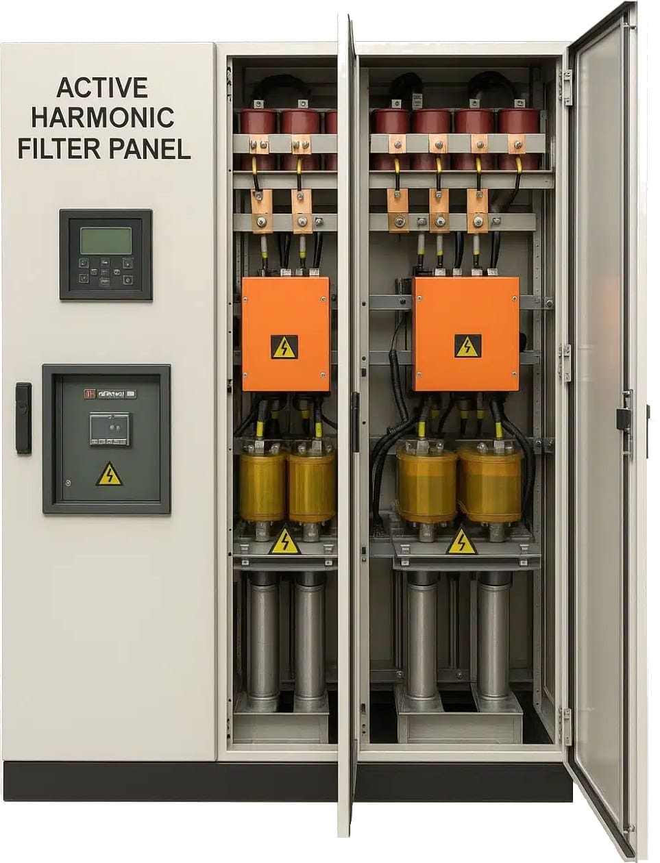

Diagnostics and Mitigation: Acoustic spectrum analysis using a Fast Fourier Transform (FFT) algorithm can separate the acoustic frequencies. If high-amplitude peaks are found at 300Hz, 500Hz, etc., harmonic pollution is confirmed.
Mitigation requires installing active harmonic filters or utilizing K-rated transformers designed to withstand harmonic heating.
Figure 1 – Low-voltage active harmonic filters
