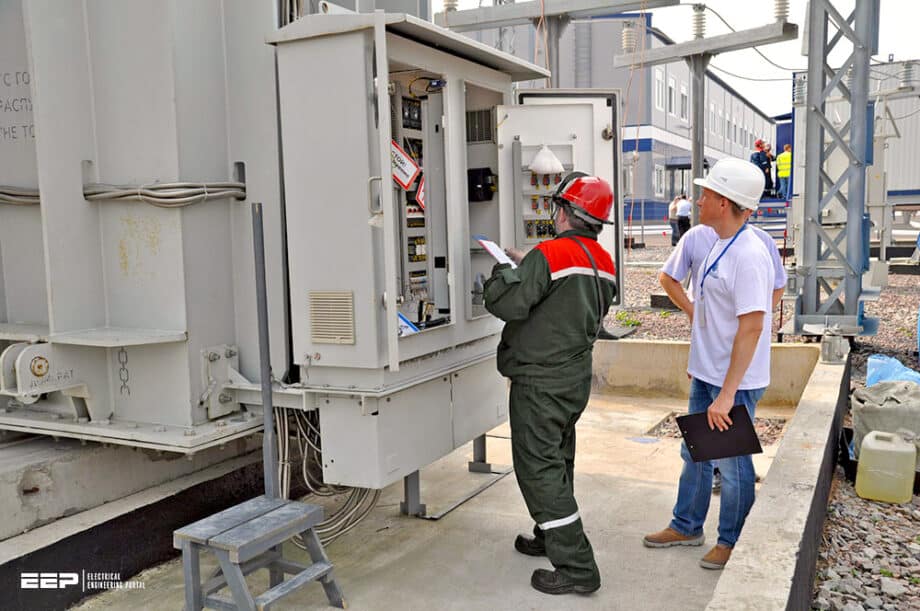

4. Transformer Pre-Commissioning
The commissioning stage is anteceded by the pre-commissioning stage to prove that new transformers have been properly shipped and correctly erected and installed.
Generally, all electrical equipment types must be tested in the factory to generate the so-called Site Acceptance Test (SAT). The pre-commissioning testing is conducted to prove that:
  1. No equipment was subjected to any damage during transportation
  2. All equipment types have been installed correctly
  3. Equipment is working in harmony with other equipment as per specifications
  4. Protection and control schemes function in accordance with relevant specifications
  5. Equipment is adjusted as per approved settings
  6. Safe installation to energize equipment (very important!)
The pre-commissioning procedure could be divided into three phases: before, during, and after the pre-commissioning tests. Also, some mechanical and electrical checks should be done before the commissioning phase starts. It is not uncommon to find that at many stages during the commissioning phase the contractor is not ready and then the commissioning team has to wait for some test results that might have been missed or ignored.
A procedure is required to check the complete readiness of the contractor prior to the pre-commissioning tests and to prepare for the commissioning tests.
This procedure has to outline the project (transformer) readiness for the commissioning tests, the contractor is fully equipped and ready from all aspects to conduct the commissioning tests, and the time of witnessing the pre-commissioning tests is at minimum duration with high-quality performance.
Transformer pre-commissioning tests and after-receipt checks you MUST perform
A joint inspection that involves the contractor and the client is mandated, and the elements of such an inspection could be viewed in Figure 1.
