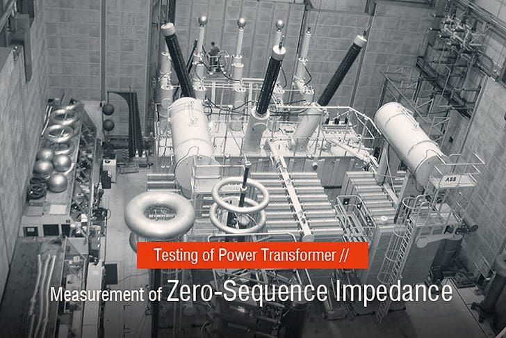

The zero-sequence impedance is usually measured for all star-connected windings of the transformer. The measurement is carried out by supplying a current of rated frequency between the parallell connected phase terminals and the neutral terminal.
Testing of Power Transformer – Measurement of Zero-Sequence Impedance
Testing of Power Transformer – Measurement of Zero-Sequence Impedance (on photo: preparing the 400 kV transformer for the test field inside the ABB’s factory)
The zero-sequence impedance per phase is three times the impedance measured in this way. The zero-sequence is needed for earth-fault protection and earth-fault current calculations.
