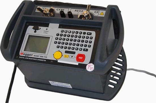

4. Circuit Breaker Contact Resistance Measurement Test
Stationary and moving contacts are built from alloys that are formulated to endure the stresses of electrical arcing.
However, if contacts are not maintained on a regular basis, their electrical resistance due to repeated arcing builds up, resulting in a significant decrease in the contact’s ability to carry current. Excessive corrosion of contacts is detrimental to the breaker performance.
One way to check contacts is to apply DC and measure the contact resistance or voltage drop across the closed contacts.
The breaker contact resistance should be measured from bushing terminal to bushing terminal with the breaker in closed position. It is recommended that for MV and HV the resistance test be made with 100 A or higher DC. The use of a higher current value gives more reliable results than using lower current values.
The resistance value is usually measured in microohms (µΩ). The average resistance value for 15 kV class circuit breakers is approximately between 200 and 250µΩ. Several companies make good, reliable microohmmeters to perform this testing.
One such instrument is the Megger DLRO 200. It can generate test currents from 10 to 200 A and can measure resistances ranging from 0.1µΩ to 1 Ω.
The Megger DLRO 200 is shown in Figure 4.
Megger DLRO 200
Figure 4 – The Megger DLRO 200-115 High Current Digital Low Resistance Ohmmeter, 200 Amp is designed to check and measure contact resistance in high voltage circuit breakers, disconnecting switches (isolators), busbar joints, or for any low resistance measurement

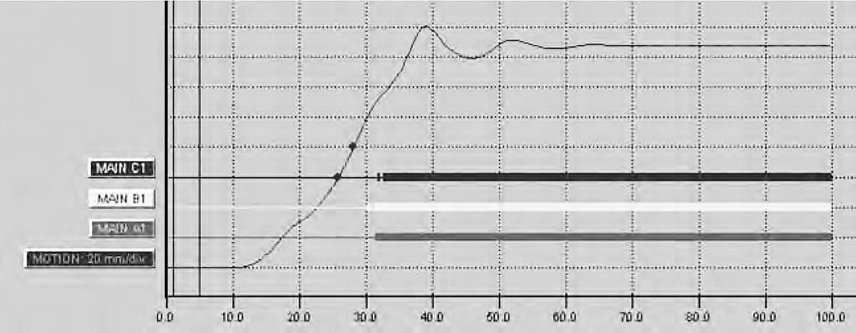

1. Closing and opening time
In the example below, the closing time of the contacts is shown to be 31.4 ms (phase A), 30.2 ms (phase B), and 31.8 ms (phase C).
ParametersValueUnit
001 Close time A31.4ms
060 Bounce time A0.0ms
001 Close time B30.2ms
060 Bounce time B1.1ms
001 Close time C31.8ms
060 Bounce time C0.8ms
010 Diff time A – B – C1.6ms
016 Cls speed8.40m/s
Also closing times of a breaker can be viewed in a graph form as displayed in Figure 5.
Graph showing closing time of contacts of a breaker
Figure 5 – Graph showing closing time of contacts of a breaker

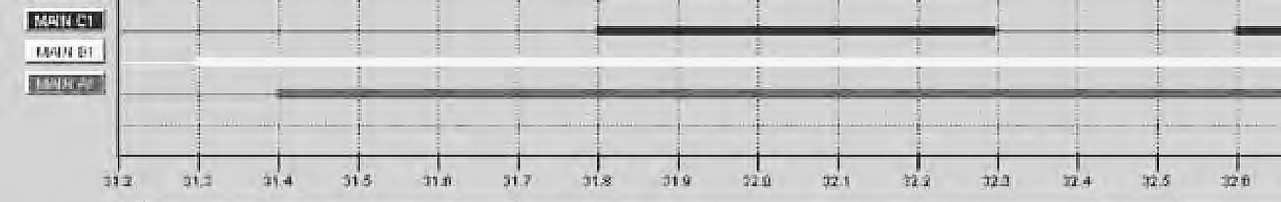

2. Contact bounce
If we expand the x-axis in Figure 5, we can actually view the contact bounce associated with the above breaker operation as shown in Figure 6.
It is clear to see that there is 0.8 ms bounce associated with the contact movement in phase C. These series of contact bounces can be compared with future tests to see if there is any degradation to the actual mechanism associated with breaker contacts.

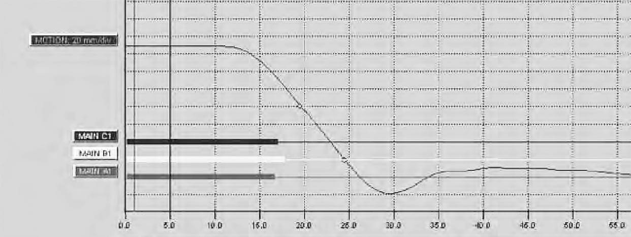

5. Trip operation
The trip operation of a breaker is another name for an open operation. Most utility companies and plant owners want to perform a trip (or open) operation to monitor the speed of the opening mechanism and contacts to make sure there is enough energy in the spring mechanism to open under a fault condition.
The graph for a trip is similar to the one for a close operation, except the motion of the mechanism is going in the opposite direction, i.e., from closed contacts to fully open position as seen in Figure 7
Graph showing speed of the contacts opening for trip (or open) operation of a breaker
Figure 7 – Graph showing speed of the contacts opening for trip (or open) operation of a breaker

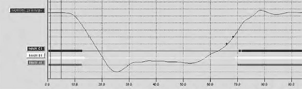

6. Trip-free operation
This operation simulates the condition when an open breaker is closed into a fault and then it is tripped free by a protective relay.
Trip-free is an operation where the breaker contacts are in the open position and the breaker is operated to perform a close–open sequence. In this operation, the breaker is closed and then immediately sent a control command to open.
This operation confirms whether a breaker, if closed into a fault, can clear it.
The graph for a trip-free operation is shown in Figure 8 below.
Graph showing trip-free operation of a breaker
Figure 8 – Graph showing trip-free operation of a breaker

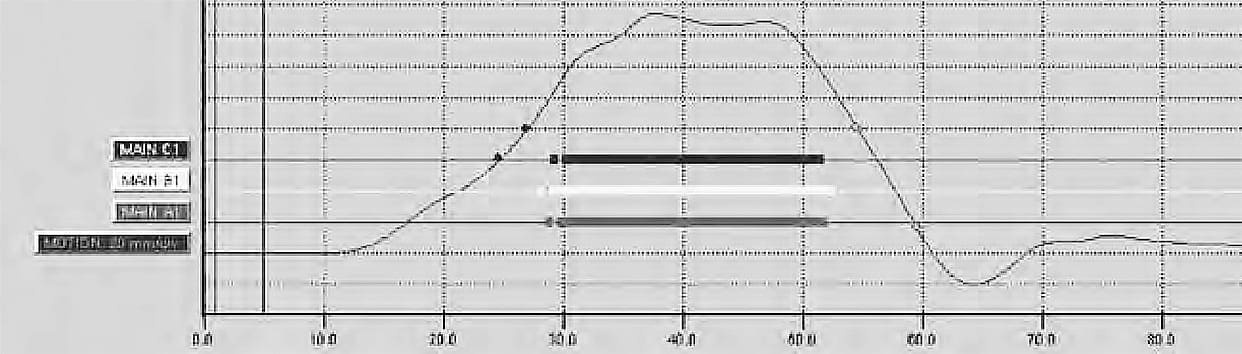

7. Close operation
This test is performed to verify a breaker’s closing mechanism. The graph for close operation of a breaker is shown in Figure 9 which is similar to the graph of Figure 5.
Graph showing close operation of a breaker
Figure 9 – Graph showing close operation of a breaker
8. Trip-reclose operation
In this test, the reclose operation of the breaker is checked to assure that the breaker closing time is within specified limits after a trip operation. The reclose time is measured either in milliseconds or cycles.
The trip-reclose operation of the breaker is shown in Figure 10.
Graph showing trip-reclose operation of a breaker
Figure 10 – Graph showing trip-reclose operation of a breaker
