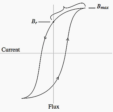

Attempted interruption anywhere here leaves Br on the core.
Hysteresis curve showing the residual flux during a circuit interruption
Figure 1 – Hysteresis curve showing the residual flux during a circuit interruption
The worst inrush occurs with residual flux left on the transformer core.
Consider Figure 1 and Figure 2, which shows the worst-case scenario. A transformer is deenergized near the peak core flux density (Bmax), when the voltage is near zero.
The flux decays to about 70% of the maximum and holds there (the residual flux, Br). Some time later, the transformer is reenergized at a point in time when the flux would have been at its negative peak. The system voltage is crossing through zero and rising positively.
