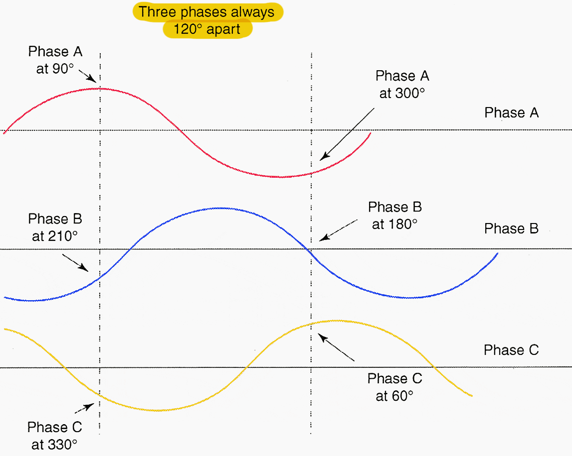

1.3 Phases 120 Degrees Apart
When three phases are 120 degrees apart, as shown in Figure 1, the values also can be shown in graph form as in Figure 2. The first vertical line in Figure 2 shows the values being generated in Figure 1.
Phase A, at 90 degrees, is generating at the maximum value, phase B, at 210 degrees is climbing towards the zero value, and phase C, at 330 degrees, is approaching the maximum return or negative value.
The second vertical line shows what is happening to the power generated in each phase when phase A is 120 degrees (one-third of the way) into the cycle, phase B would be 240 degrees (two-thirds of the way) into the cycle, and phase C would be at 360 degrees (at the end, which is also the beginning) of the cycle.
A three-phase circuit is like having three separate AC single-phase circuits with identical voltage that reach their peak values at a different time. At 60 hz, the second phase reaches its positive peak at 1/180 (0.00556) seconds after the time the first phase reaches a positive peak, and the third phase reaches its positive peak 1/180 (0.00556) second later. The first phase again reaches a positive peak 1/180 (0.00556) seconds after the third phase, starting the next cycle.
Even though each phase has the same voltage, they are out of phase with each other and there is a voltage difference between them.
Figure 2 – Relationship of three phases
When the load on each phase is identical, the instantaneous power output of the three phases added together is constant. When one phase of a three-phase circuit reaches a peak voltage, another phase is close to zero volts and the third phase is on the return flow. As simple as it is!
So, each phase is 120 degrees out of phase with the other phase. The voltage and current in each phase are 1/180 second, or one-third distance in a cycle behind another phase.
