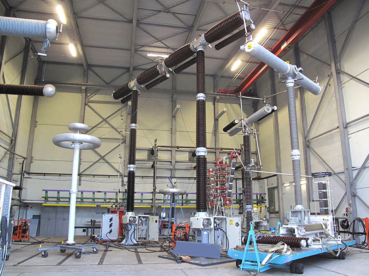

Dielectric measurements indicate that switchgear with a specific voltage rating can withstand the voltage stresses expected in service from switching operations or lightning surges. The switchgear is subjected to one-minute power frequency voltage withstand testing. A voltage greater than the rated voltage of the switchgear is used to validate proper clearances and insulation strength between phases, across open contacts, and between phase and earth.
The tests also examine the withstand capabilities of switchgear closing and opening resistors, GIS designs, and grading capacitors. When calculating the test voltage to be used, a suitable margin between the withstand voltage levels and transitory overvoltages that may occur during switching operations must be provided for.
Furthermore, the performance of asymmetric electrode morphologies at various high test voltage polarities must be examined.
However, additional elements, like humidity, dust, radiation, and especially the electrode design, can have a much larger impact on the breakdown strength of air than just pressure and temperature. Therefore, type test voltages employed in the lab require correction factors to adequately represent a range of real-world situations.
Switchgear operating at high altitude, where the air density is lower, requires, for instance, larger switchgear clearances to be accounted for in designs. To account for the higher withstand voltage of air at sea level, the type test voltage is also raised.
Type testing should be carried out under the most unfavorable conditions, as the dielectric strength of SF6 fluctuates with density.
Figure 1 – Dielectric tests performed on GIS switchgear
Figure 1 – Dielectric tests performed on GIS switchgear (photo credit: High Voltage Testing and Engineering Commission)

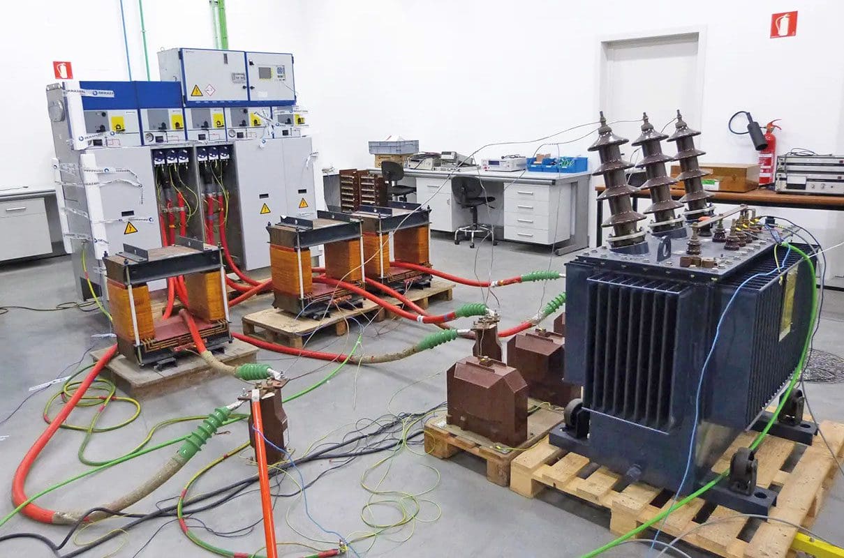

Figure 2 – High-Voltage Testing and Partial Discharge Measurements in GIS-Air Connection GIS Bushing
Figure 2 – High-Voltage Testing and Partial Discharge Measurements in GIS-Air Connection GIS Bushing (photo credit: dexotechpower.com)
The above GIS Test Transformers typically either use oil or SF6 as their insulating medium. Oil transformers have significantly higher power outputs and tuning ranges, however they cannot be connected directly to the GIS bus and must utilize external  air connections. SF6 transformers with direct SF6 bus to the test object are the preferred method of connection for PD measurements.
