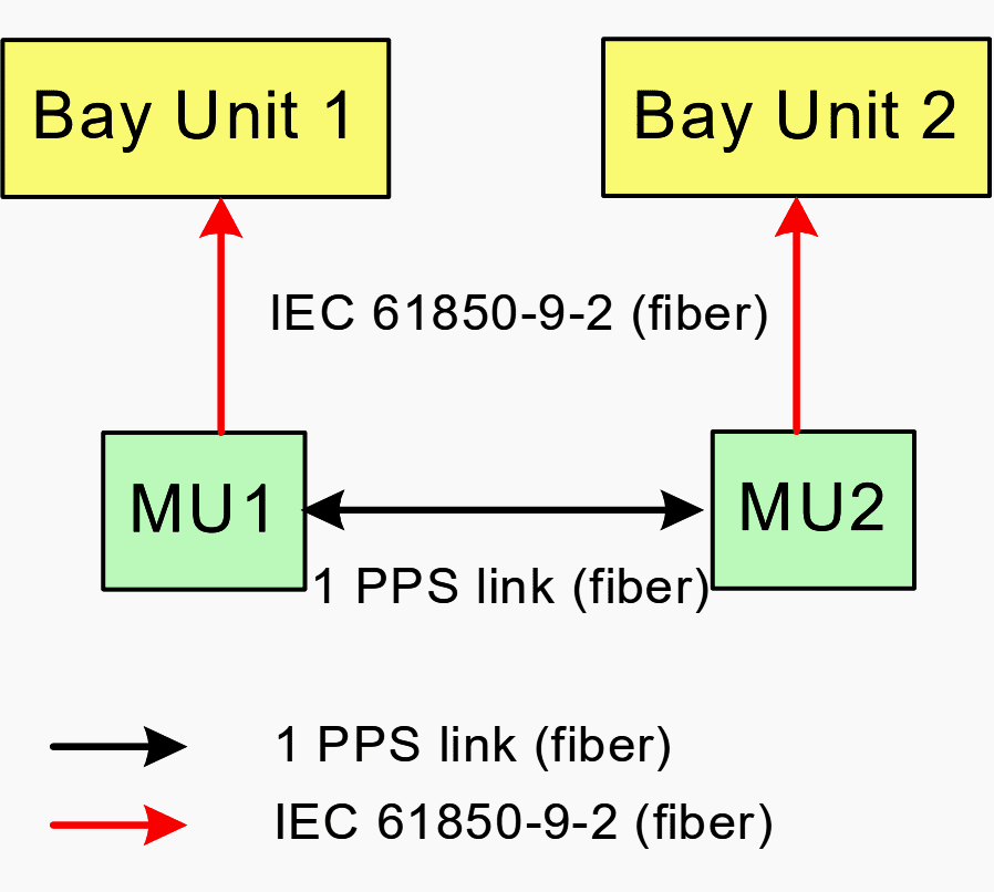

Approach #1
Synchronise two MUs using a direct connection between the MUs as shown in Figure 1. This may be required for parallel line compensation where the synchronisation is between two independent MUs located in two bays.
It may also be required for voltages, when the time information associated with them needs to be distributed by the MU to all the bays requiring this voltage.
Architecture Scenario 1
Figure 1 – Architecture Scenario 1

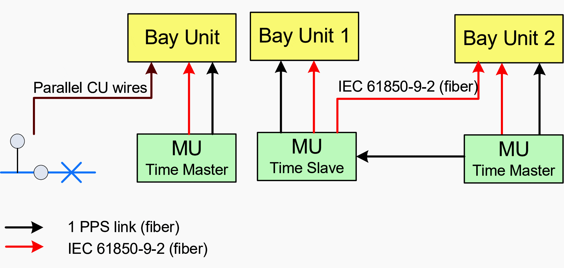

Figure 2 shows the scenario to synchronise the bay device from the MU directly or with one slave MU synchronised by another time master MU.
This can be adopted when the bay device has local sampling of the conventional CT and VT signals and these need to be synchronised with the data of the MU or via a technique which time correlates the output to the sampled input data.
Architecture Scenario 2
Figure 2 – Architecture Scenario 2

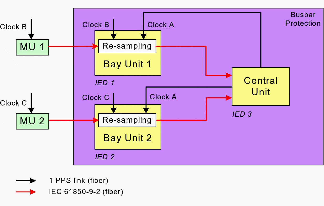

Approach #3
Synchronise the busbar protection from the MU in each bay as shown in Figure 3. This allows for re-sampling of the data from all bays to a common time base in the busbar protection.
This will require different topologies for the 1 pulse per second (PPS) that is dependent on whether the protection is centralised or decentralised. It will also support mixed mode with local sampling in the busbar protection.
Architecture Scenario 3
Figure 3 – Architecture Scenario 3
