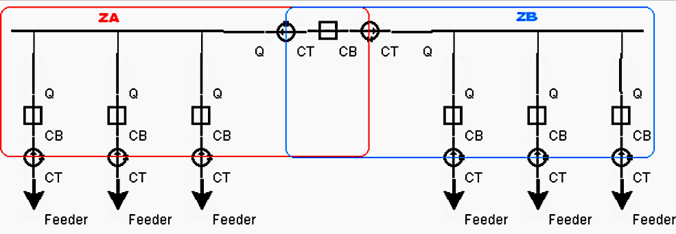

3.6 CT Disconnection for Bus Section and Bus Coupler Current Transformer Cores
In practice there are two different solutions for bus section or bus coupler bay layout. First solution is with two sets of main CTs, which are located on both sides of the circuit breaker, as shown in Figure 11.
Two differential zones overlap across the bus-section or bus-coupler circuit breaker. No special considerations within busbar protection scheme are then necessary for this type of stations.
Figure 11 – Two Busbars with 2 CTs Tie

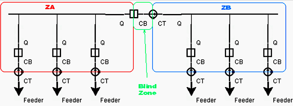

Due to the high cost of the HV current transformer often only one current transformer is available in bus-section or bus-coupler bay. This is a solution shown in Figure 12.
For this type of solution just one main CT is located on only one side of the circuit breaker. Thus, there is no zone overlapping across the section/coupler circuit breaker as shown in Figure 12.
For an internal fault in the dead zone, the differential zone ZA will unnecessarily operate and open the bus section breaker and all other feeder breakers associated with it. Nevertheless the fault will still exists on other busbar section, but is outside the current transformer in the bus section bay and hence outside the zone ZB (i.e. it is external fault for zone ZB). Similar problem will also exist if section/coupler circuit breaker was open before the internal fault in the dead zone.
Therefore, the busbar protection scheme does not protect the complete busbar.
In order to improve the busbar protection scheme with this type of station layout, it is often required to disconnect the bus-section or bus-coupler CT from the differential zones as soon as the bus-section or bus-coupler circuit breaker is opened. This arrangement can be achieved in following example.
The open contact of the section/coupler circuit breaker is normally used. However, the timing of this auxiliary contact is very important. Please note that this auxiliary contact initiating CT disconnection shall be a type which closes as soon as the main breaker contacts leave the open position. It shall not be a type which closes when the main breaker contacts reach the closed position. This solution requires good CB maintenance and might experience problems during the life time of the circuit breaker.
Figure 12 – Two Busbars with 1 CT Tie
Using external relays and this solution does not depend on contact timing between the main contacts and auxiliary contact of the breaker. This will disconnect the section/coupler CTs after about 150ms from the moment of opening of the section/coupler CB.
Nevertheless this time delay is absolutely necessary in order to prevent racing between the opening of the main breaker contact and disconnection of the CT from the differential zones.
This scheme will as well disconnect the CT in case of the operation of any of the two differential zones involved. This will secure the delayed (about 150ms) clearing and tripping of the internal fault within the dead zone even in case of section/coupler circuit breaker failure during this fault.
This facility will improve the performance of the busbar protection scheme when one CT is located on only one side of the bus-section/bus-coupler circuit breaker.
