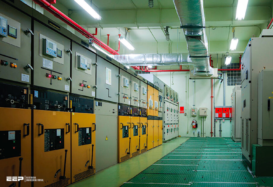

1.2 Secondary Systems
The application of Wide area monitoring, control and protection will become more prevalent as System Operators are faced with more dynamic networks and large scale interconnections. Embedded generation and active control within distribution networks will require significant coordination between neighbours and make traditionally separate networks much more interdependent on each other.
The communication necessary to support these developments will be central to the security and reliability of the strategy. There is likely to be a greater dependency on these systems to facilitate the changes in power networks.
Compared with the substation primary plants and instrument transformers which generally remain in-service for long life-cycles, renewed only when physically or mechanically life-expired, the secondary systems (protection and control equipment) are often changed more frequently.
The short life of protection and control equipment means that during the typical 40 year asset life of primary switchgear the secondary equipment needs to be replaced at least once and probably twice.
Based on the statistics from the construction industry, currently achievable replacement rate for protection and control systems is about 3-5% per annual. It would take around 20+ years or less to complete a whole cycle of a replacement. However, the modern protection and control equipment asset life is 15 years, and in many cases, they only last 10 years due to the availability of technical support and technology change.
In addition, the replacement and maintenance of substation secondary equipment may also lead to downtime, which negatively influences the overall availability of the substation. One factor which contributes to this problem is the complex wiring required for the installation of a relay. Another possible contributing factor is relay obsolescence. If a new relay has to be installed, it may require a new configuration in order to communicate with the existing substation equipment, and this may not be possible without the use of expensive protocol converters.
Normally, outages for replacement of protection and control devices are eight weeks in duration and National Grid would like to reduce these to typically one to two weeks.

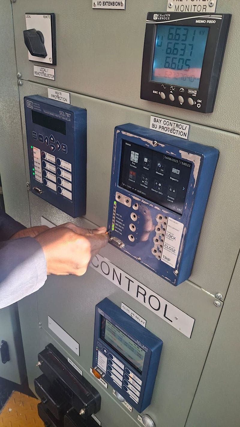

Figure 2 – Secondary equipment: Control and protection panel
Figure 2 – Secondary equipment: Control and protection panel (photo credit: Nonofo Unami Ketlhaotswe via Linkedin)
One way to overcome the problem is to develop a new architecture for substation secondary systems by deploying some new technologies such as standard interface modules, process bus and IEC61850 communication protocol. The deployment of IEC61850 process bus technology will allow ongoing substation secondary equipment retrofitting (refurbishment) projects to proceed whilst limiting the duration and frequency of circuit outages, required to facilitate the work.
Once the new technology is installed, secondary equipment renewals occurring mid-life in the primary plant lifecycle can be undertaken in a safer, quicker and easier way with much reduced outages of primary systems.
This will also enable vendor interoperability and easier modification and extension of the secondary schemes, particularly allowing reconfiguration and feature enhancement by software means, rather than the modification of wiring as would have been the case in the past.
As the new secondary systems transmit data of CT and VT analogue signals via the process bus, this poses no safety risks of opening CT circuits, and hence improving the safety when the protection replacement is carried out with primary circuit in service.
