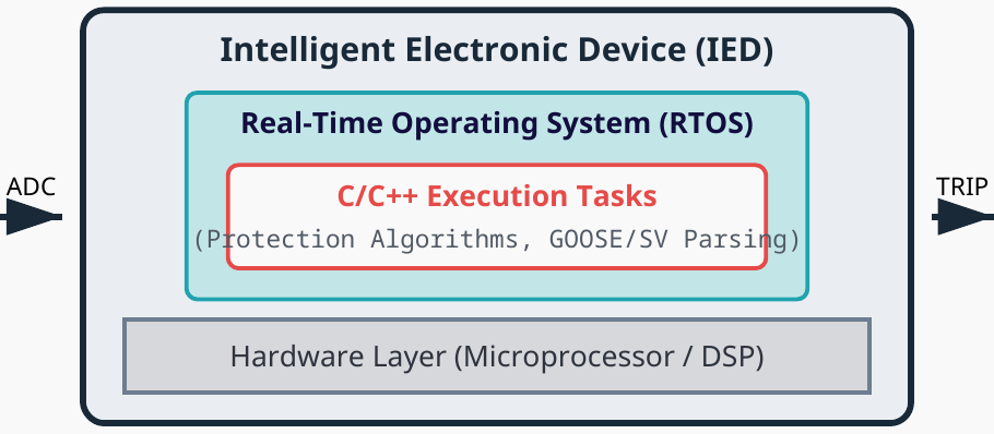

In the domain of power systems protection and control, C and C++ remain the foundational languages for embedded software development. The fundamental requirement of an Intelligent Electronic Device (IED) or a digital protection relay is absolute determinism.
When a fault occurs on a high-voltage transmission line, the protection algorithm—such as differential protection (ANSI 87) or distance protection (ANSI 21)—must execute within strict temporal parameters, often measured in milliseconds or microseconds.
Figure 1 specifically outlines the architecture of an Intelligent Electronic Device (IED), mapping the Hardware Layer up to the Real-Time Operating System (RTOS), and explicitly highlighting the C/C++ execution tasks (such as protection algorithms and GOOSE/SV parsing) running within it.
C provides direct memory access, precise control over hardware registers, and minimal abstraction overhead, which is critical for Real-Time Operating Systems (RTOS) like VxWorks or FreeRTOS utilized in IEDs.
C++ introduces object-oriented paradigms, allowing for the modularization of complex protection logic and communication stacks without significantly compromising execution speed.
Figure 1 – Architectural abstraction of C/C++ execution within an embedded Real-Time Operating System (RTOS) environment
