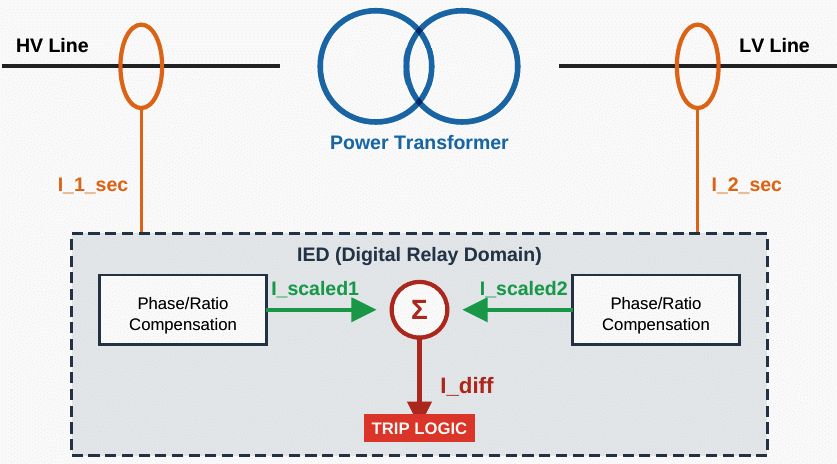

We all learned about transformer protection in college, and as far as I remember, transformer protection is presented as a paragon of logic and mathematical symmetry. The core concept and the differential protection scheme (ANSI 87T) is built upon the infallible foundation of Kirchhoff’s Current Law.
The textbook theory dictates that the sum of the currents entering a node must equal the sum of the currents leaving it. So, is it true?
When applied to a transformer, adjusted for the primary-to-secondary turns ratio and phase angle shifts, the operating principle is exquisitely simple: if the scaled current flowing into the primary winding does not precisely match the current flowing out of the secondary winding, an internal fault exists.
The Intelligent Electronic Device (IED) calculates this difference, issues a trip command to the respective circuit breakers, and isolates the transformer to prevent catastrophic failure.
Idiff = | Σ Ιscaled | = | Ι1_sec + Ι2_sec |
If this equation were the entirety of the discipline, power system protection would be a trivial exercise. However, in the harsh, dynamic reality of the HV grid, this theory simply disintegrates. Power transformers are far from ideal piece of equipment.
Figure 1 – Transformation of physical secondary currents (I_sec) into digital scaled currents (I_scaled) to calculate Differential Current (I_diff)
Where Differential Protection Variables are:
I1_sec and I2_sec (Secondary Currents): These are the raw, physical analog currents flowing out of the Current Transformers (CTs) on the high-voltage (1) and low-voltage (2) sides of the power transformer. They are typically scaled down by the physical CT ratio to standard nominal values (e.g., 1A or 5A) before entering the relay terminals.
Iscaled (Scaled Current): This is a purely mathematical value calculated inside the digital Intelligent Electronic Device (IED). Because the primary and secondary windings have different voltage levels, phase shifts (e.g., Delta-Wye connections), and potentially mismatched CT ratios, I1_sec and I2_sec cannot be compared directly.
The relay applies internal compensation matrices to adjust magnitude and rotate the phase angles, creating Iscaled so both sides share a common, unified mathematical baseline.
Idiff (Differential Current): The calculated vector sum of the scaled currents inside the relay. The equation is Idiff = | Iscaled1 + Iscaled2 |. Under normal load or external faults, the scaled vectors cancel each other out (Idiff ≈ 0). During an internal fault, they sum together, producing a high Idiff that triggers a trip command.
Relying purely on basic differential theory will invariably result in either nuisance tripping during normal grid operations or, conversely, a failure to clear destructive internal faults.
Modern protection engineers, particularly those working with advanced digital substations and complex IEC 61850 network architectures, know that managing a protection relay involves resolving the conflict between theoretical mathematics and physical reality.
The commissioning engineer is not merely balancing an equation; they are managing core physics, electrical transients, mechanical limitations, and digital logic matrices.
This article provides a deep, comprehensive exploration into the fundamental discrepancies between textbook differential theory and the practical realities of transformer protection, detailing the sophisticated mechanisms required to bridge this gap.

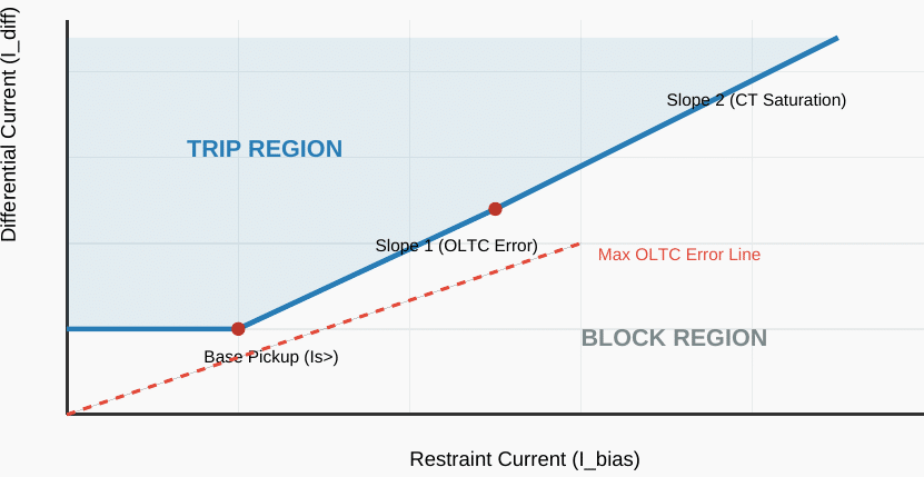

2. On-Load Tap Changers (OLTC) and the Floating Baseline
A fundamental principles of differential theory is that the input and output currents can be mathematically balanced by applying the transformer’s turns ratio. In textbook exercises, this ratio is static. In the real world, grid voltage is highly volatile. To maintain stable voltage for distribution networks or industrial facilities, high-voltage transformers are equipped with On-Load Tap Changers (OLTC).
The OLTC mechanically adds or removes physical turns from the high-voltage winding while the transformer is energized and carrying load, typically adjusting the voltage in small steps across a range of ±10% to ±20%.
Consequently, the physical turns ratio of the transformer is a moving target.
The protection relay, however, is generally programmed with the nominal tap position. When the OLTC moves to tap 16 to boost voltage during a heavy winter load period, the primary-to-secondary current ratio changes significantly. This creates a steady-state, permanent false differential current. Because the relay is still scaling the secondary current using the nominal ratio, the calculated difference between primary and secondary is no longer zero, even under perfectly healthy conditions.
If a simple overcurrent threshold were used for the differential element, the relay would trip the moment the load current increased while the tap was at an extreme position.
Figure 2 – The Dual-Slope Percentage Restraint Characteristic designed to accommodate OLTC mismatch and CT saturation errors
To reconcile the theory of balance with the reality of an active OLTC, relay engineers must implement a Percentage Restraint (Bias) Characteristic, commonly known as a dual-slope curve. Instead of a fixed trip threshold, the relay continuously calculates a Restraint Current (I = ( | I1 | + | I2 |) / 2), which represents the bias total through-current.
The required differential current to cause a trip (Idiff_trip) is no longer a static number, because it increases proportionally with the through-current. The gradient of the first slope (Slope 1) is explicitly set by the commissioning engineer to be greater than the maximum possible error introduced by the OLTC at its extreme tap positions (plus inherent CT ratio errors).
While this elegantly solves the nuisance tripping problem, it reveals a harsh trade-off:
To maintain stability under heavy load with tapped windings, the relay’s sensitivity to genuine, low-level internal faults is inherently degraded.
