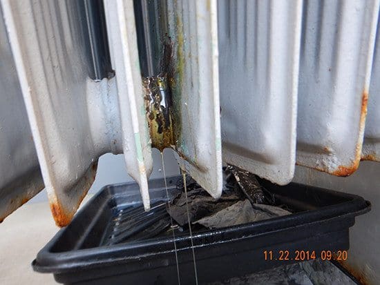

3.2.7 Defects in the accessories, oil leak, gas leak, etc.
Leaking oil from corroded transformer
Leaking oil from corroded transformer (photo credit: kijinc.com)
