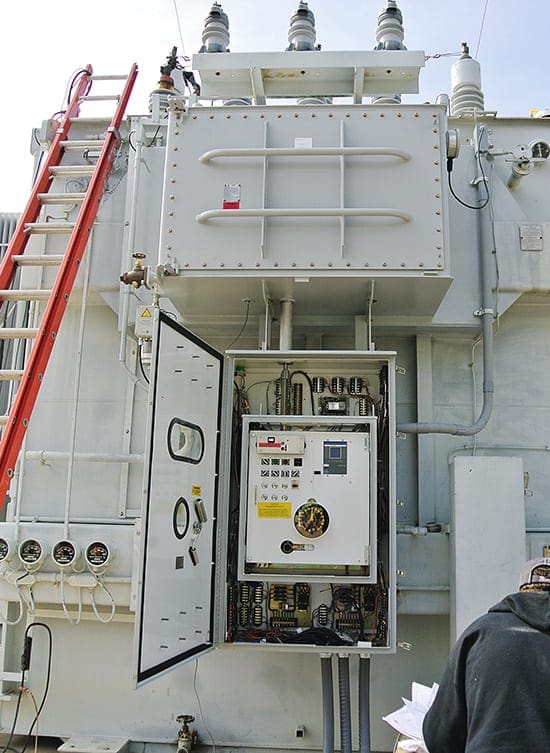

1. Maintenance in energized condition
For personal safety reasons, only a limited amount of maintenance activities should be performed on the transformer when it is in operation.
When necessary safety precautions have been taken the following maintenance can be done in energised condition:
  1. Inspection for leakages, cracks in porcelain bushings, check of auxiliary equipment etc.
  2. Check drying material in the dehydrating breather (conservator type only).
  3. Measurement of temperatures of joints, bushings etc. by using a heat-sensitive camera.
  4. Oil samples (conservator type only).

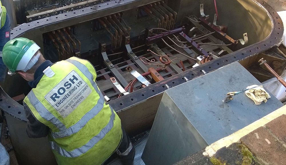

2. Maintenance in de-energized condition
Before starting maintenance work, the transformer has to be disconnected from the network and earthed. When the circuit breaker and the isolator have been opened, they shall be locked in an open position to prevent inadvertently closing during maintenance work.
Items to be considered are:
  • Bushing gaskets; if leaks occur, tightening usually will help, if the gasket has lost its elasticity, it must be replaced. The reason for loss of elasticity could be excessive heating or ageing,
  • Cover gaskets, valves and gaskets of the tap changer. If there are leakages, bolt tightening will often help,
  • Welded joints. Leaking joints can be repaired only by welding.
    A skilled welder and welding instruction are required.
  • Cleaning contaminated bushings (cleaning agent e.g. methylated spirit),
  • Cleaning glasses on the gas relay, thermometer and liquid level indicator,
  • Functional inspection and testing of applicable accessories,
  • Move tap changer through all positions a few times, all types of tap changers,
  • Liquid sampling from bottom drain valve for larger units as required,
  • Check drying material in the dehydrating breather. (Conservator type only),
  • Amend surface treatment defects,
  • Oil and insulation maintenance, drying and reclaiming,
  • Tap-changer maintenance,
  • Inspection and maintenance on the active part should not be performed unless there are unambiguous indications of defects.

7. On-load tap-changer
Maintenance of on load tap-changer shall be performed according to the instructions given by the supplier of the tap-changer.
Reference should be made to IEC 60214 (Tap-changers) and IEC 60214-2 (Application guide for on-load tap-changers) and especially to the tap-changer manufacturers operation and maintenance instructions. In addition, it is strongly recommended that only suitably trained personnel should undertake OLTC examination and maintenance.
On-load tap-changers have to be maintained regularly. Maintenance interval and total expected lifetime depends on number of operations, normal current, if oil filtering unit is provided etc.
Maintenance of on-load tap-changer
Maintenance of on-load tap-changer (photo credit: reinhausen.com)
8. Motor drive unit
Motor dose units have to be maintained regularly. Maintenance interval and total expected lifetime depends on number of operations. Only trained and experienced personnel must carry out maintenance of motor drive units.
See transformer supplier’s documentation provided.
Replacing the transfomer motor drive unit
Replacing the transfomer motor drive unit (photo credit: reinhausen.com)

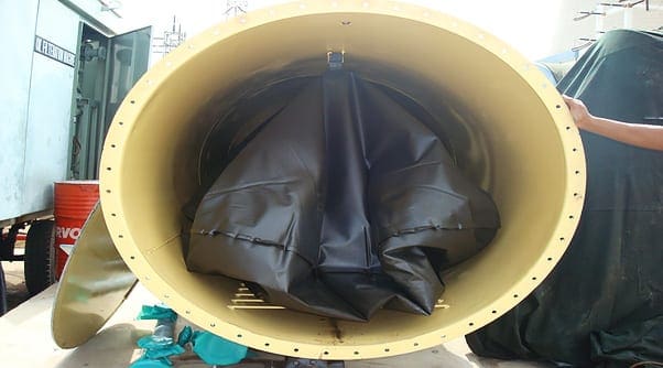

11. Liquid conservator with rubber diaphragm
The system consisting of oil conservator with rubber sack does normally not require any other maintenance than inspection of the silica gel breather. The silica gel shall be changed when approx. 2/3 of the silica gel has changed from blue to red colour (old type of silica gel) or from pink to white, respectively.
