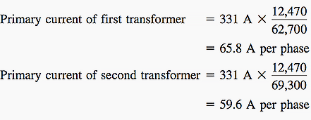

Since Ic flows in a loop in the secondary circuit, the current out of the secondary of the first transformer equals the current into the secondary of the second transformer. But since the turns ratios are not equal, Ic does not get transformed into equal and opposite currents at the primaries.
Primary current of the first and second transformer
The net current through the air break switch, IAB, is the difference in the primary currents //
What actually happened?
The current through the air break switch supplies the Ic2Xs reactive losses of both transformers and therefore lags the primary voltage by 90°. The resulting current exceeded the interrupting rating of the switch, causing it to fail. The conditions described in this example are diagramed in Figure 1 above.
