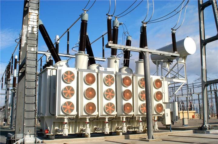

Connecting transmission systems with system intertie transformers (on photo: ABB's 500 MVA transformers delivered to Oltarzew substation in Poland)
The power rating of such transformers may be quite high, for example 1000 MVA, and they are sometimes made auto-connected in order facilitate the transport from the factory to the site by the lower weight and physical dimensions. In addition the manufacturing cost will be lower compared to a transformer with separate windings.

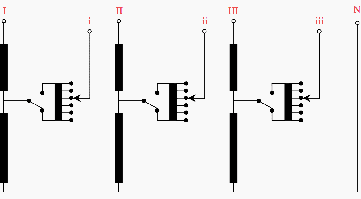

The insulation of the windings is normally graded. In separate windings transformers tappings are placed in the neutral end of one of the windings. In auto-connected transformers tappings am typically located in the phases of the low voltage side. See Figure1.
Figure 1 – Auto-connected transformers tappings
The tappings are sometimes located at the neutral point of auto-connected transformers where the voltage level to earth and the voltage differences between phases am lower than when the tappings are situated at the auto tap. A simpler and cheaper tap changer can then be used.
On the other hand tappings at the neutral will need a larger number of turns in the tapping range to achieve the same variation in the turn ratio as when the tappings are situated at the auto tap or at the high voltage terminal.
