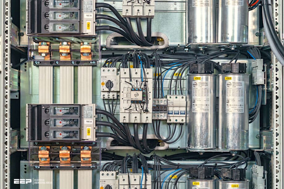

To be honest, troubleshooting low-voltage Power Factor Correction (PFC) banks on-site is not an exercise in academic theory; it is a highly physical, hazardous, and systematic process. When a facility manager reports a penalty on their utility bill, or a breaker trips seemingly at random, the technician standing in front of the metal enclosure needs actionable steps, not complex mathematical derivations.
Troubleshooting LV Reactive Power Compensation On-Site
Troubleshooting LV Reactive Power Compensation On-Site (photo credit: Frako)
This guidance article is designed specifically for field engineers and technicians. It strips away the abstract physics and focuses entirely on what you can see, hear, smell, and measure with standard industrial diagnostic tools.
The practical approach to PFC troubleshooting demands a specific sequence of operations. You must never immediately start replacing parts based on a hunch.
The workflow must always follow a rigid hierarchy: ensure physical safety and isolation, analyze the automated controller’s screen for baseline data, perform live-load dynamic testing (if safe to do so), and finally execute de-energized component testing. Skipping straight to component replacement is the leading cause of repeat failures and unresolved grid penalties.
Throughout this technical article, I will focus heavily on tool usage. Your primary weapons are a CAT IV True-RMS (TRMS) clamp multimeter, a thermal imaging camera, a dedicated LCR (Inductance, Capacitance, Resistance) meter, and a phase rotation meter.
I will detail exactly where to place your probes, what dials to turn, and how to interpret the numbers on the screen. A reading of 30 Amps means nothing unless you know the practical formula to determine if it should actually be 45 Amps.
This guide provides those exact field parameters.

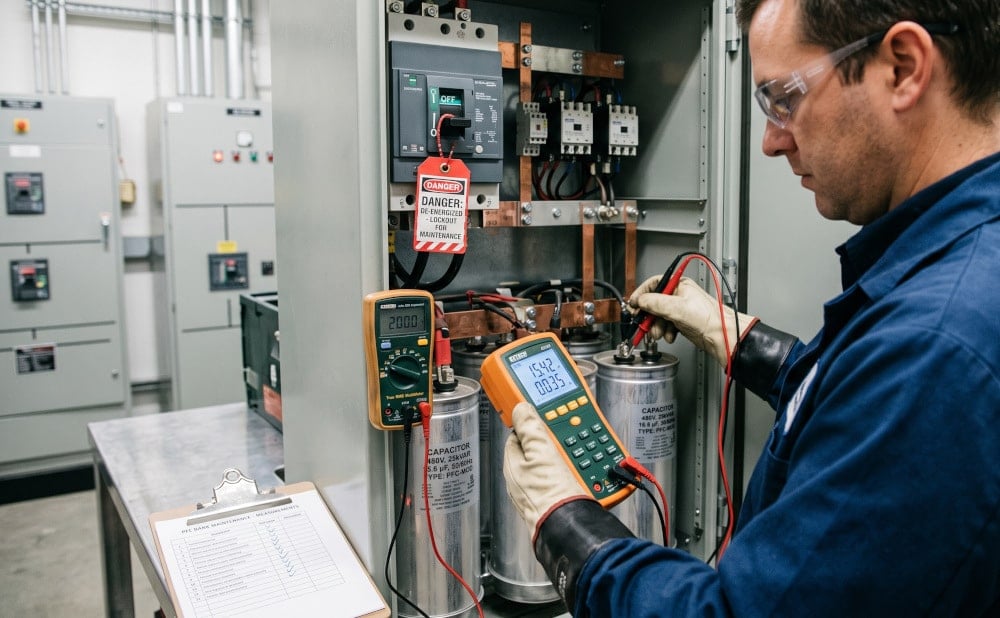

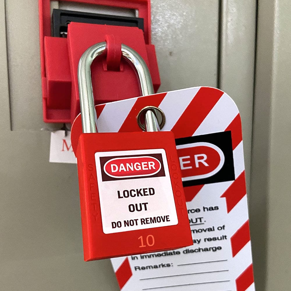

1. Immediate Safety & LOTO Execution
A reactive power compensation panel is fundamentally a energy storage bomb. Unlike motor control centers where power stops when the breaker is thrown, a PFC panel remains highly lethal after disconnection. The first practical step in any troubleshooting scenario is implementing a strict Lockout/Tagout (LOTO) procedure.
Do not rely on the local rotary switch on the panel door! You must trace the feed back to the main distribution board and lock it out at the source. This prevents someone else in the facility from resetting what they assume is a nuisance trip while your hands are inside the cabinet.
Once the main breaker is locked, start a timer on your phone for exactly five minutes. Standard capacitor discharge resistors are rated to pull the voltage down to a safe level within three to five minutes, but in the field, these resistors are the most common component to fail. Never assume the cabinet is safe simply because you waited. The waiting period only gives the resistors a chance to work; it does not guarantee they have worked.
After five minutes, gear up. Put on a HV face shield and Class 0 (1000V) dielectric gloves with leather protectors. Open the panel doors slowly, standing off to the hinge side rather than directly in front of the opening. This physical positioning ensures that if an arc flash or capacitor rupture occurs as the door opens, the blast wave and debris are directed past you, rather than directly into your chest and face.
Always treat an unverified panel as live.

1.1 Handling Failed Discharge Resistors on Site
When you approach a PFC panel to test capacitors, you must practically verify that the internal discharge resistors have not failed. With your Class 0 gloves on, take your TRMS multimeter and set it to read DC Voltage, not AC voltage. When a capacitor is disconnected from the AC grid, it traps the charge at the exact moment of the sine wave when the contactor opened.
This leaves a pure DC voltage, which can be up to 560V DC on a standard 400V system. Place your probes directly across the L1 and L2 terminals of the first capacitor can.
If your meter reads anything above 50V DC after the five-minute wait, the resistor has failed open. You cannot proceed with bare hands. You must now manually discharge the capacitor. Do not use a standard screwdriver; the sudden discharge of hundreds of amps can vaporize the metal tip, blowing molten slag into your eyes and destroying the tool.
It’s extremely important to note that you must use a purpose-built, heavily insulated short-circuiting wand with a high-wattage damping resistor built into the handle.
Hold the wand by the insulated grip. firmly touch the probes across L1 and L2, then L2 and L3, and finally L1 and L3. You will likely hear a loud ‘crack’ and see a bright blue spark upon the first contact. Do not flinch and pull away; hold the connection solid for at least five seconds to drain the core.
Finally, short all three phase terminals directly to the panel’s ground busbar to eliminate any floating residual charge. Only after this physical shorting is complete for every single capacitor in the bank can you safely remove your gloves for detailed component inspection.

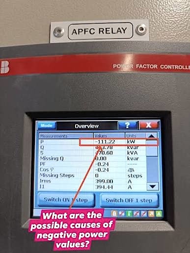

2.2 Resolving “Export Power” Errors
A frequent callout involves a PFC panel that has completely locked itself out and is displaying an “Export” error, or showing negative kW. The customer will tell you, “We don’t have solar panels, we aren’t exporting anything, the panel is broken.” In this scenario, the panel is doing exactly what it was built to do. It measures the vector relationship between the voltage and the current.
If that vector is shifted by exactly 180 degrees, the math indicates power is flowing backward into the grid.
This is purely a Current Transformer (CT) orientation problem. Go to the main utility switchboard where the CT is installed. Look closely at the physical CT donut. It will have markings for P1 (or H1) and P2 (or H2). Standard convention dictates that P1 must face the utility grid source, and P2 must face the facility load. If a contractor recently did maintenance and flipped the CT around so P2 faces the grid, the current flows backward through the coil. The controller reads this as exported power and shuts down.
To fix this practically, you do not need to shut down the whole factory to flip the CT mechanically. Open the PFC control panel and locate the terminal block where the two wires from the CT (usually marked S1/k and S2/l) enter the controller. Put the controller in manual mode, turn off all steps.
Simply swap the S1 and S2 wires in the terminal block. This reverses the polarity digitally. Turn the controller back to auto; the kW reading will immediately turn positive, and the system will begin compensating correctly.

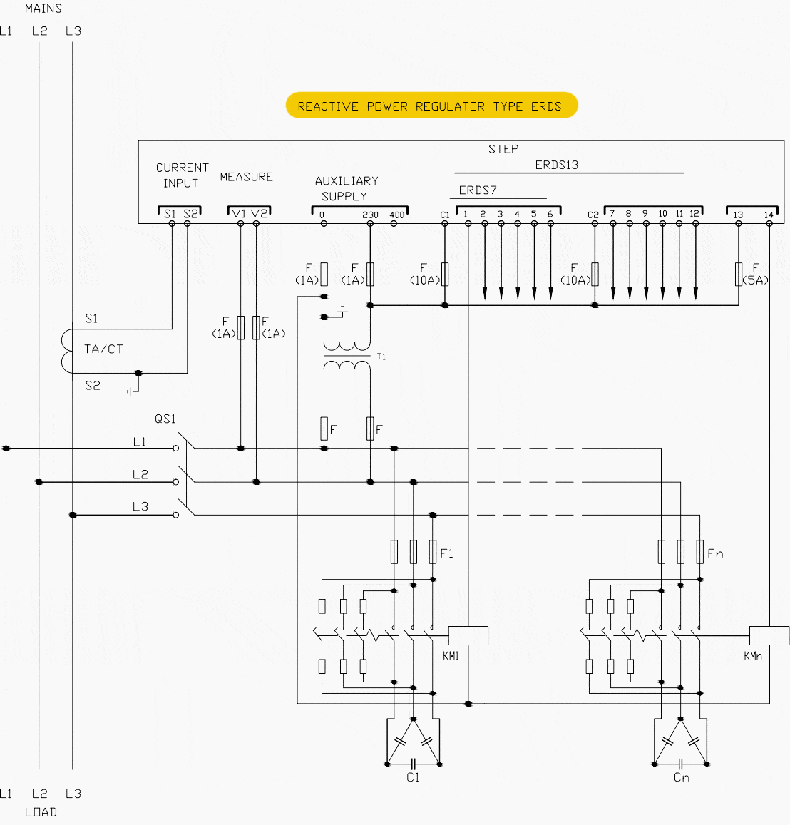

The Current Transformer (CT) is the eyes of the PFC system. If it is blind, or looking at the wrong thing, the entire compensation bank is useless. One of the most persistent and hard-to-diagnose problems in the field is incorrect physical placement of the CT.
The golden rule is: The CT must measure the total facility load AND the capacitor bank’s current!
It must be installed on the main incoming feed, upstream of the point where the PFC panel taps into the busbar.
If the CT is installed downstream of the PFC tap (reading only the factory load), the controller will see a poor power factor and switch on step 1. Because the capacitor is injecting reactive power behind the CT, the CT doesn’t measure the improvement. The controller thinks step 1 failed, so it switches on step 2, then step 3, until the entire panel is engaged. The facility becomes severely over-compensated, leading to high grid voltage and capacitive penalties from the utility. You will see the panel running at 100% capacity even when the factory is mostly shut down.
Conversely, if the CT is installed on the wire feeding the PFC panel itself, it only measures pure capacitive current. The controller will read an incredibly low leading power factor, get confused, and shut down completely. It will never switch on a single step. Troubleshooting CT placement requires physically tracing the thick copper busbars inside the main switchroom.
You must visually confirm that the main utility cables pass through the CT donut before any branch circuits or PFC feeds break away from the bus.

This test must be done completely de-energized, following strict LOTO and manual discharge procedures as outlined in Topic 2.
Once the panel is dead and manually shorted to ground, you must physically disconnect the heavy gauge wires from the top of the capacitor. If you leave the wires connected, you will be measuring the capacitance of the entire parallel busbar system, not the individual can. Take your LCR meter, set it to measure Capacitance (often denoted by the microfarad symbol, µF). Connect the meter probes across the L1 and L2 terminals of the capacitor. Record the value. Repeat for L2-L3, and L1-L3.
Look at the manufacturer’s nameplate on the side of the capacitor. It will state the nominal capacitance, for example, “3 x 165 µF“. Compare your meter readings to this nameplate. A standard industry rule of thumb is that if the measured capacitance drops more than 10% below the nameplate value (e.g., if it reads below 148 µF), the capacitor has reached the end of its reliable lifespan.
Even if it is still partially functioning, it should be marked for replacement during the current shutdown to prevent rapid acceleration of failure when energized.
Figure 6 – Technician using an LCR Meter on a De-energized Capacitor Bank

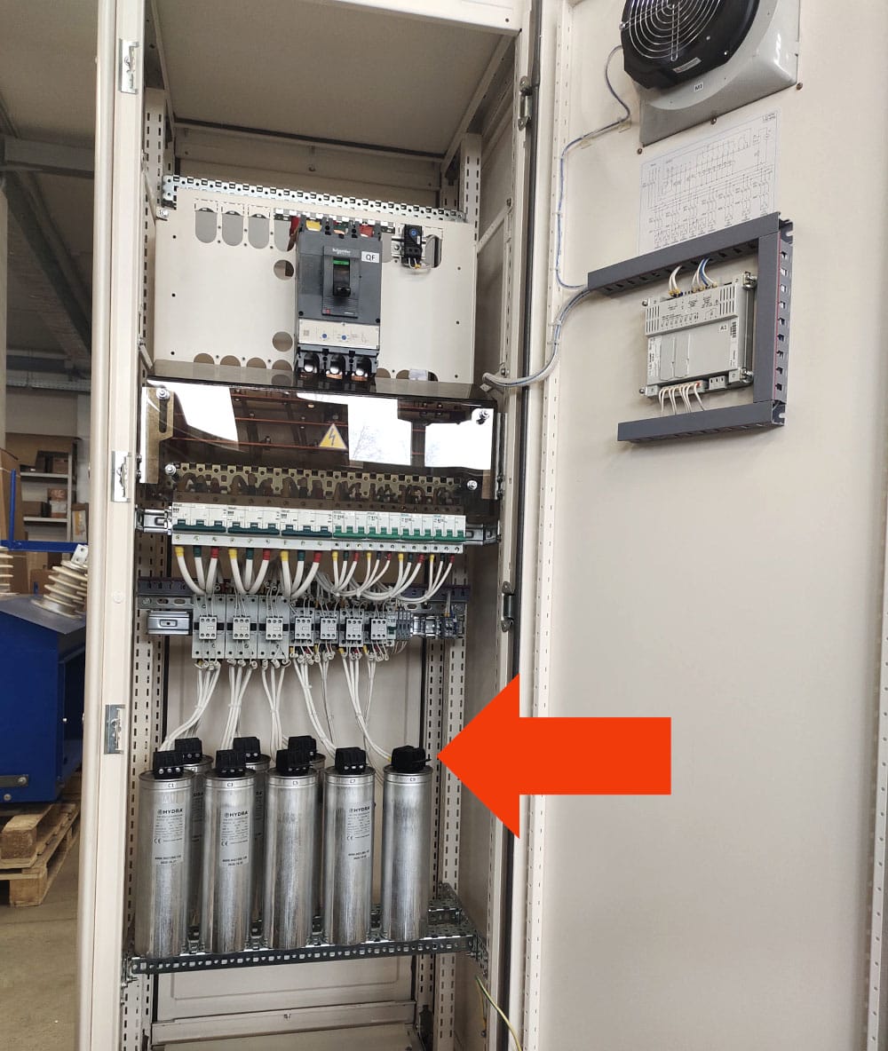

Not all capacitor failures require a meter to diagnose. Cylindrical LV capacitors have a mechanical safety mechanism built into their design. When a capacitor overheats or suffers severe internal shorting, the dielectric gel begins to boil, producing gas. To prevent the aluminum can from exploding violently, the lid is designed to expand upwards.
As the lid pushes up, it physically snaps a set of internal breakaway wires, safely disconnecting the capacitor from the live circuit.
When you open a PFC cabinet for visual inspection, take a flashlight and shine it horizontally across the tops of the capacitor array. Look for uniformity. If one or two cans look noticeably taller than the rest, or if the metal lid containing the terminals is domed upwards like a bloated tin can, those capacitors have failed completely. Their internal safety disconnects have fired. They are dead and must be replaced.
A fatal troubleshooting error occurs when an inexperienced technician sees a bulging lid, assumes it’s just a mechanical fitment issue, and pushes down hard on the terminals to “snap it back into place.” Doing this physically reconnects the snapped internal wires. You have just bypassed the only safety mechanism on a gas-filled, completely degraded capacitor.
The moment the panel is re-energized, that capacitor will instantly rupture, shooting boiling dielectric fluid and shrapnel throughout the switchboard, initiating a phase-to-phase arc fault. If it bulges, do not touch it; replace it.

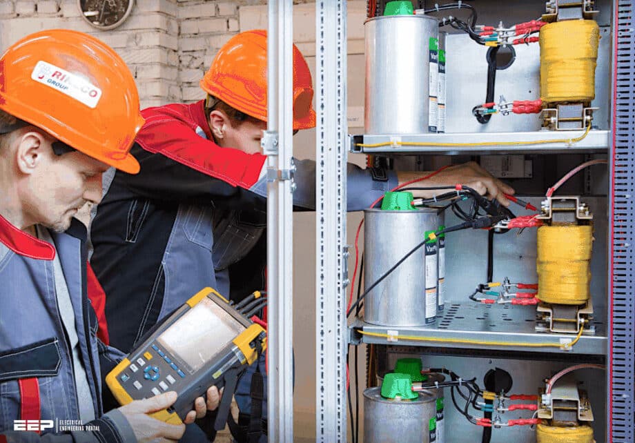

6. Harmonics & Reactor Troubleshooting
In modern industrial facilities dominated by Variable Frequency Drives (VFDs) and LED lighting, the electrical current is no longer a nice sine wave. It is jagged and full of high-frequency noise called harmonics. Capacitors naturally act as a vacuum for these high frequencies. If standard capacitors are installed in a factory full of VFDs, they will suck in amounts of harmonic current, overheat, and explode.

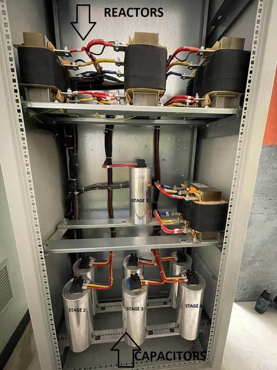

To prevent this, heavy iron-core inductors (called detuning reactors) are wired in series with the capacitors to choke out the harmonics.
Troubleshooting detuned PFC panels requires different techniques. Reactors get incredibly hot under normal operation. A standard reactor operating safely can easily reach surface temperatures of 90°C to 110°C. If you use a thermal camera and see a reactor at 100°C, do not panic; this is often within its design parameters (which usually allow for 115°C rises above ambient).
However, if one reactor in the array is reading 150°C while the others are at 90°C, that reactor is failing. The internal winding insulation is breaking down, causing shorted turns.
A practical field test for reactor health is listening. A healthy detuned reactor hums with a steady, low-frequency vibration. If a reactor begins emitting a loud, harsh, high-pitched screeching or intense rattling sound, it is either suffering from severe mechanical delamination of its iron core plates, or the facility is experiencing acute harmonic resonance.
If you hear this screeching, immediately shut the panel down. Continued operation will lead to catastrophic thermal failure of the reactor and a potential enclosure fire.
Figure 10 – Connection of Capacitors and Reactors in a Capacitor Bank
6.1 The Fatal Error of Bypassing Reactors
When a detuning reactor fails, perhaps burning out a winding, it leaves that specific capacitor step useless. A highly common, and highly dangerous, mistake made by field technicians under pressure from management to “get the power factor back up” is to bypass the damaged reactor.
They will disconnect the heavy wires from the burnt reactor and bolt them directly to the capacitor, effectively turning that single step into a standard, un-detuned capacitor.
This is the worst possible action you can take in a harmonically polluted grid. The rest of the panel remains detuned, meaning those steps reject harmonic currents. The single bypassed step, however, is now the path of least resistance for every single harmonic current in the entire factory. It becomes a harmonic sink. All the high-frequency distortion generated by every VFD on the floor will rush directly into that single unprotected capacitor.
Because detuned capacitors are typically rated for higher voltages (e.g., 525V) to handle the voltage boost from the reactor, they might survive the overvoltage briefly, but the sheer thermal mass of the harmonic current will cause the dielectric to boil within hours. The capacitor will violently rupture.
Remember, never, under any circumstances, alter the LC topology of a step! If a reactor is burnt, physically lock out that specific contactor so the step cannot be used, order the exact manufacturer replacement reactor, and run the facility at a slightly lower power factor until the correct repair can be made.

Suddenly, the older PFC panel that worked perfectly for ten years begins throwing continuous errors, shutting down entirely, and the facility starts receiving utility penalties. Technicians will often spend days testing capacitors and CT wiring, finding nothing broken.
The problem is not a broken component; it is an obsolete controller algorithm. Traditional PFC controllers are designed for one-way power flow: from the utility to the factory. When the sun is shining brightly on a weekend, the factory load is low, and the solar array generates more active power (kW) than the facility consumes. This excess kW is exported back to the grid. The power flow literally reverses direction.
Standard solar inverters, however, only output Active Power (kW). They do not supply the Reactive Power (kVAr) required to keep the facility’s idle transformers and baseline loads magnetized. Therefore, the facility is exporting kW while simultaneously importing kVAr from the utility.
When a standard PFC controller sees the active current flowing backward, it assumes the CT was installed backward. It throws an “Export Error” and shuts down to protect itself, dropping all compensation exactly when the baseline inductive load needs it most. The physical solution is upgrading the panel’s “brain” to a modern 4-Quadrant controller that understands bi-directional power flow.

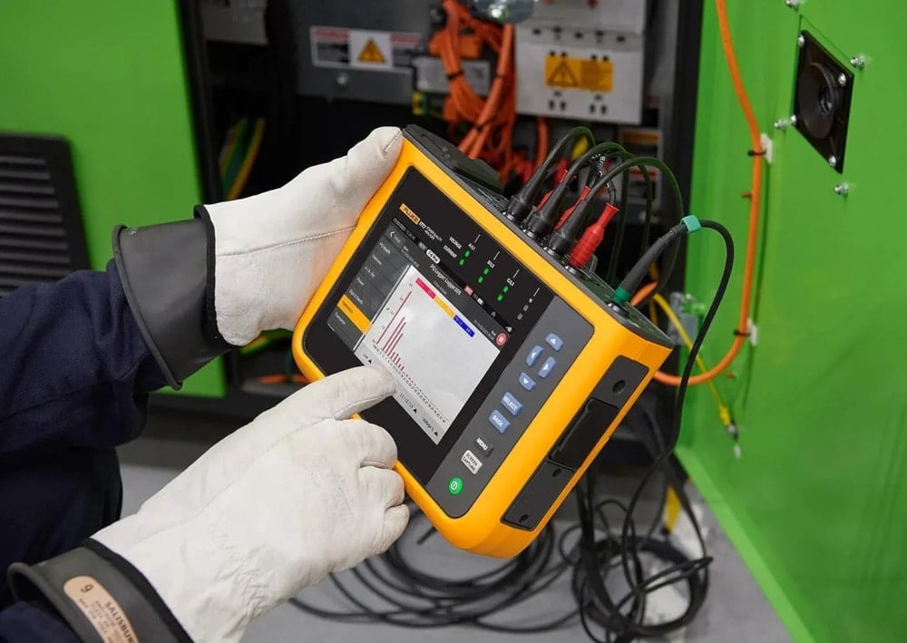

8.1 Diagnosing Single-Phase Unbalance
Standard industrial PFC banks use a single Current Transformer (usually mounted on L1) and switch three-phase capacitors. The controller mathematically assumes that whatever inductive load it sees on L1 is perfectly mirrored on L2 and L3. In heavy industries with three-phase motors, this assumption is generally correct.
However, if you are troubleshooting a commercial building, a hospital, or a data center, this assumption is fatally flawed.
These environments are dominated by single-phase loads (lighting on L1, server racks on L2, HVAC on L3). If L1 has a heavy inductive load, the controller will read the CT and switch on a large three-phase capacitor step. This fixes L1 perfectly. But if L2 and L3 were already lightly loaded or highly capacitive (due to LED drivers), that three-phase capacitor just severely overcompensated L2 and L3. The utility meter, which reads all three phases, will register a severe capacitive penalty, yet the PFC controller screen will proudly display a perfect 0.99 power factor.
To diagnose this, you must connect a 3-phase Power Quality Analyzer to the main incoming supply. Do not look at the total aggregate power factor. Look at the individual vector screens for L1, L2, and L3. If you see L1 at 0.82 Inductive, L2 at 0.95 Capacitive, and L3 at 0.90 Inductive, a standard panel cannot fix this grid. No amount of tweaking the controller will work.
You must advise the client that they require a specialized “unbalanced” PFC system that uses three individual CTs and switches single-phase capacitors independently per phase.
Figure 12 – Fluke Power Quality Analyzer recommended for Diagnosing
