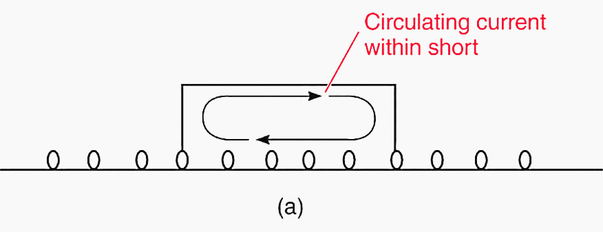

A short is a common motor winding breakdown, and it requires rewinding or replacing the motor. Shorted turns are caused by nicked coil wire, high-voltage spikes, conductive contaminants, overheated winding, aged insulation, and loose, vibrating coil wires.
The most of the resistance to current flow in an AC motor is furnished by inductive reactance. The resistance of the wire in a complete phase is a very small percentage of the motor’s total impedance (resistance plus inductive reactance). Inductive reactance makes each turn very significant in the motor’s ampere demand. Each turn supplies much more inductive reactance than resistance.
A short forms when one or more turns of a coil are bypassed because of an insulation breakdown between wires. The resistance that the shorted turns develop is eliminated from its phase winding, resulting in increased amperes. When there are a few shorted turns in one of the three phases, a closed-loop circuit is formed by the turns within the short. As the motor runs, lines of force (from AC current flow) cut the wires in the closed-loop circuit.
A high circulating current is transformed into the loop (Figure 1a).
Figure 1a – Transformed current flow in the turns within a shorted coil (dosed loop) raises the amperes of the phase
Power consumed by the circulating current increases the amperes of the faulty phase, making it easy to identify the problem. Circulating current in the closed loop often melts the circuit open. When this happens, the circulating current and the turns within the closed loop are eliminated.
