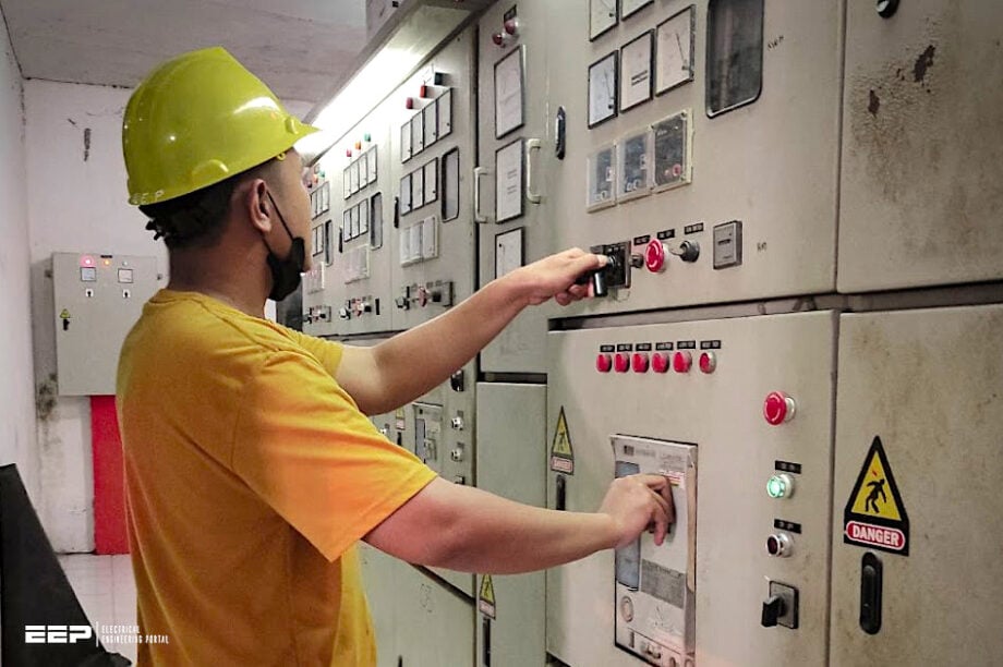

1. Stiff and Misaligned Breaker Racking Mechanisms
What’s the design flaw? The draw-out mechanism is intended to provide safe, physical isolation of the circuit breaker from the main busbars. However, operators frequently encounter racking mechanisms that require excessive, asymmetrical force to move the breaker between the “Test” and “Service” positions.
What’s the technical root cause? This issue stems from inadequate manufacturing tolerances in the guide rails, poor selection of lubrication that degrades or hardens over time, and the use of inferior worm-gear materials that warp under stress.
When a heavy MV generator circuit breaker is continuously racked in and out over its lifecycle, the kinetic friction alters the alignment of the moving chassis against the stationary panel frame.
Finally, what’s the operational impact? Operators are forced to apply extreme torque to the racking handle, risking severe damage to the internal mechanical linkage or the protective shutter mechanism.
If a breaker jams halfway, failing to fully engage the primary contacts but incapable of being withdrawn, it creates a highly dangerous, stressed operational deadlock that requires a complete busbar outage to safely rectify.
Figure 1 – Racking in/out MV circuit breaker using dedicated trolley is often a problem
Racking out MV circuit breaker using dedicated trolley

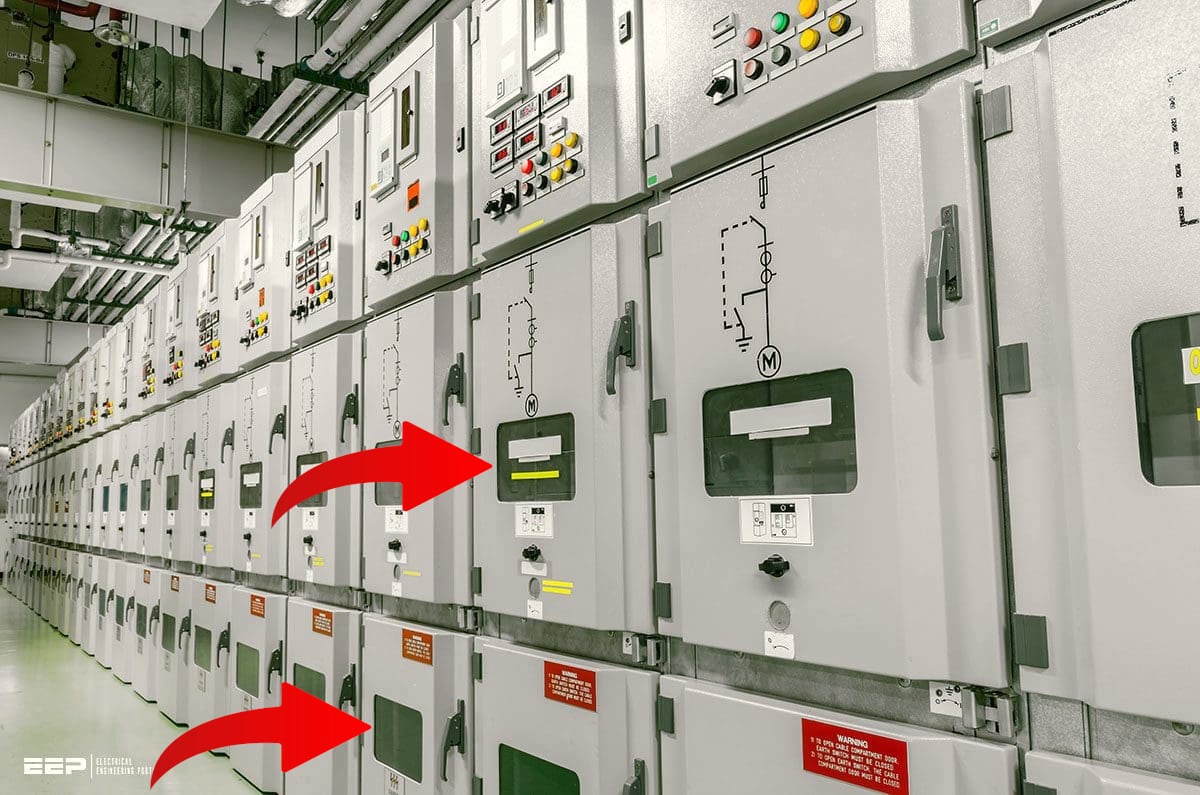

2. Obscured Viewports for Isolator Status
What is the primary engineering oversight here? Visual verification of isolating distances and earthing switch blade positions is an absolute, non-negotiable safety rule in high-voltage switching. Despite this, switchgear manufacturers frequently design viewing windows that are fundamentally unfit for purpose: they are too small, positioned at ergonomically hostile heights, or constructed from materials that degrade.
Where does this technical problem originate? In the pursuit of higher Internal Arc Classification (IAC) ratings, manufacturers minimize the size of cutouts in the heavy steel doors.
They utilize thick polycarbonate viewing panes that quickly scratch during routine cleaning, cloud due to UV exposure, or attract heavy layers of electrostatic dust in industrial environments. Internal illumination is almost always an afterthought.
Finally, what does this mean for the operators on the ground? When an operator requires a high-powered flashlight and severe neck contortion just to confirm an earth blade has fully traversed its path and made contact, the design has failed its primary safety objective. Ambiguity in visual isolation directly leads to operator hesitation and drastically increases the risk of switching errors.
Figure 2 – This switchgear has good (big) viewports for visual CB/disconnector statuses

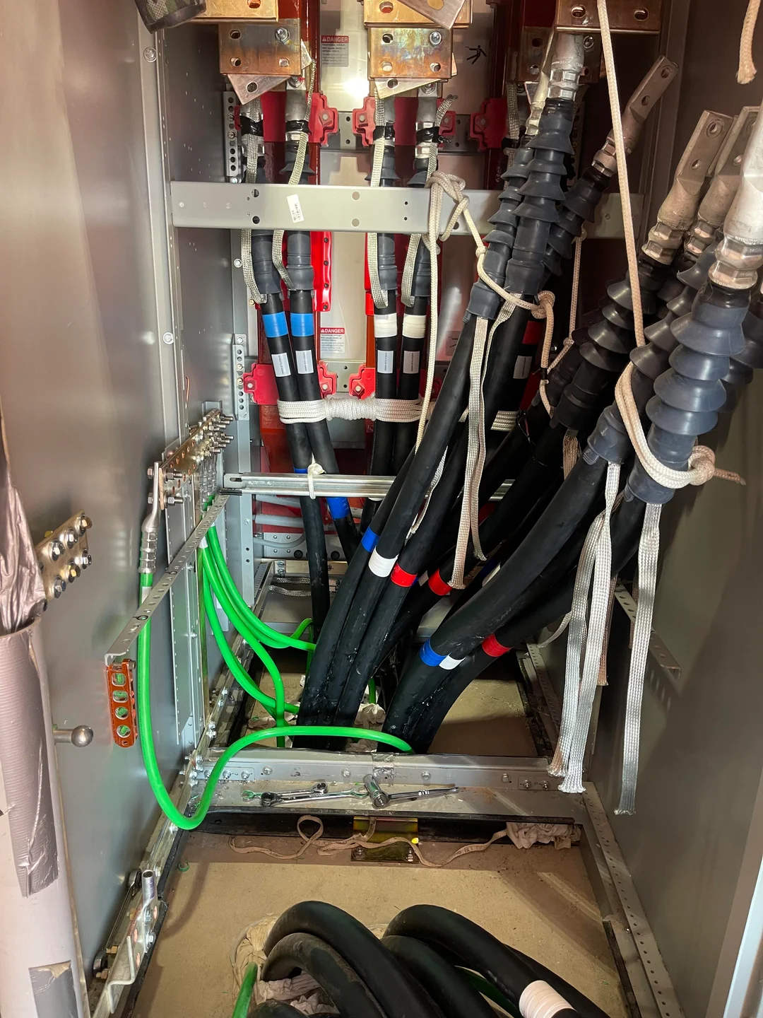

3. Inadequate Cable Compartment Space
Where does the design inherently fall short? Cable termination is arguably the most physically demanding and labor-intensive phase of switchgear installation. Imperfections in spatial design ,such as impossibly tight bending radii for large cross-section XLPE cables—turn routine terminations into a nightmare for jointers.
What’s the technical root cause? As switchgear footprints are miniaturized to save expensive substation real estate, the cable compartment is often the first casualty. Designers fail to account for the physical stiffness of heavily armored, high-voltage cables.
Furthermore, bottom-entry designs often ignore the vertical space required to properly install stress cones, phase-segregation boots, zero-sequence current transformers (CTs), and surge arresters.
What is the direct consequence for the maintenance crew? Jointers are forced to strip cables shorter than recommended or apply excessive lateral force to bend cables onto the termination pads. This compromises the dielectric integrity of the termination kit, significantly increasing the likelihood of partial discharge, tracking, and eventual phase-to-earth faults within the cable box.
Figure 3 – Tight space for cables in Cable compartment of a MV switchgear

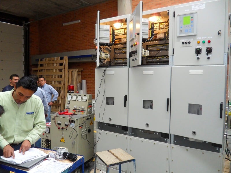

4. Flimsy Door Latches and Hinge Sag
Where manufacturers make a mistake? Switchgear doors are heavy, especially those engineered with thick gauge steel to withstand the immense dynamic pressure of internal arc faults. Over time, inadequate hardware fails to support this weight.
What is the base technical explanation for why this happens? Cost-reduction strategies often lead to the specification of undersized hinges and low-grade locking mechanisms.
The continuous opening and closing, combined with the sheer gravitational pull on wide doors, causes the hinges to yield and sag. This throws the multi-point locking latches entirely out of alignment.
Ultimately, how does this compromise operational efficiency and safety? Operators end up having to physically lift, shoulder, and force the heavy steel doors upward just to engage the rotary handle.
This is not only a severe ergonomic hazard but a persistent annoyance that eventually compromises the panel’s IP rating, allowing moisture and dust ingress, and completely invalidating the arc-fault containment integrity of the enclosure.
Figure 4 – LV compartment can be quite heavy and loose their strength through time
