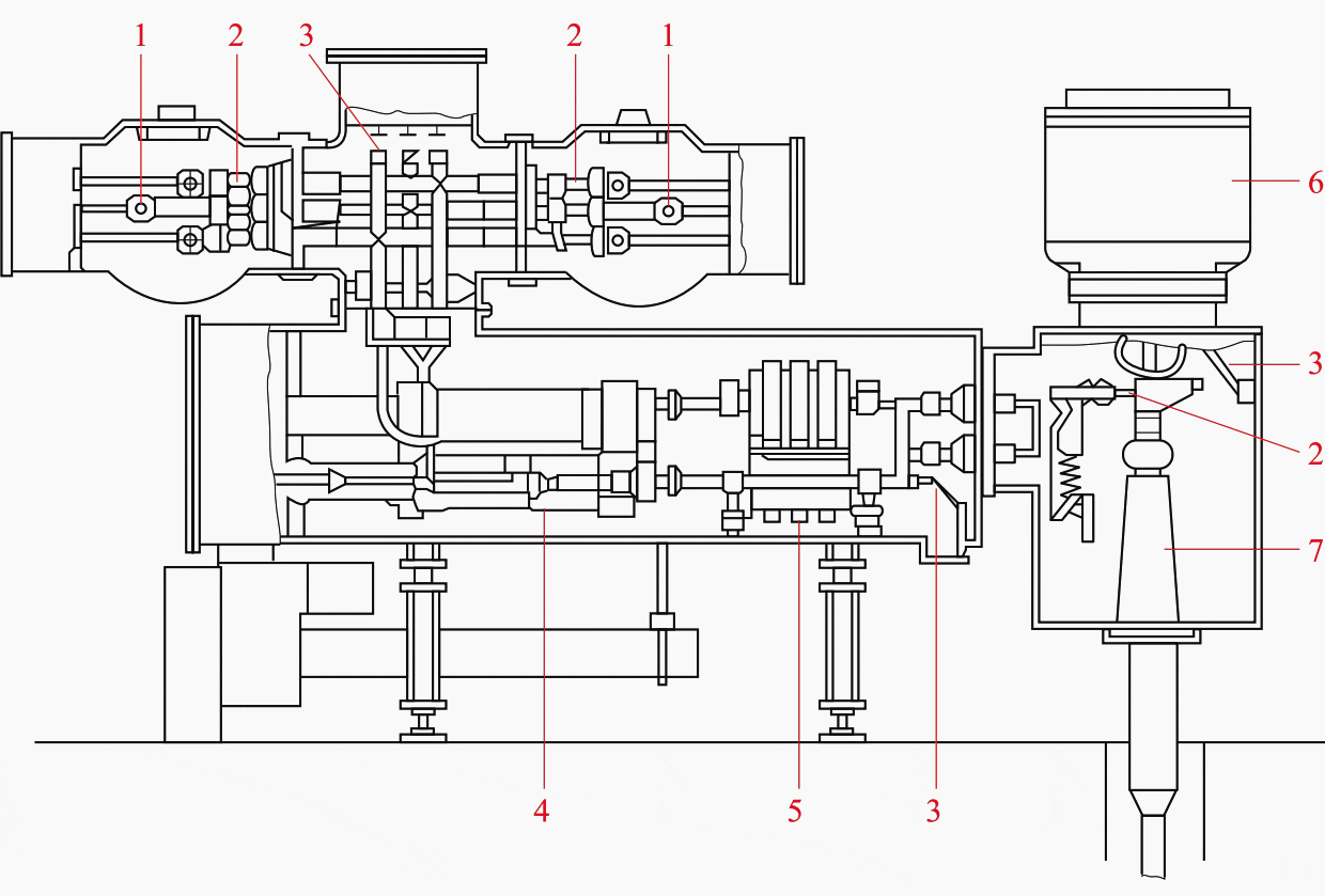

For three-phase non-segregated GIS, the three phases are housed within the same enclosure and spaced apart using insulating supports or plates. This structure can reduce both the metal enclosure material consumption and land occupation.
Moreover, when the three-phase currents flow through the bus concurrently, the resulting magnetic field lines will cancel-out each other in the enclosure, thereby reducing eddy-current losses.
Figure 1 shows the schematic diagram of the internal structure of three-phase non-segregated GIS.
 Schematic diagram of internal structure of three-phase non-segregated GIS
Figure 1 – Schematic diagram of internal structure of three-phase non-segregated GIS
Where:
  1. Bus
  2. Disconnector
  3. Earthing switch
  4. Circuit breaker
  5. Current transformer
  6. Voltage transformer
  7. Cable terminal

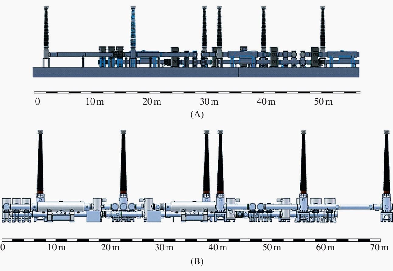

Compared with 750-kV switchgear, 1000-kV switchgear requires a higher insulation level. This causes increased equipment sizes and places higher requirements on the mechanical strength of the equipment and makes it more difficult to manufacture, transport, and install the equipment.
Figure 2 shows the dimensions of 750-kV GIS and 1000-kV GIS for comparison.
Dimensions of 750 kV and 1000 kV GIS switchgears; (A) 750-kV GIS and (B) 1000-kV GIS
Figure 2 – Dimensions of 750 kV and 1000 kV GIS switchgears; (A) 750-kV GIS and (B) 1000-kV GIS
